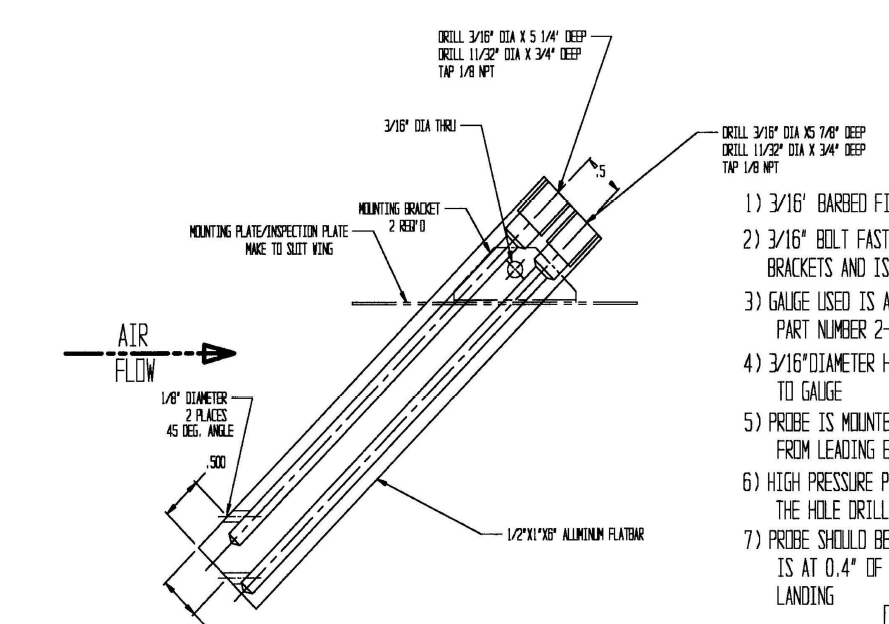

I cut the corner off a piece of 1/2" plate of aluminum. With it oriented so the 90 degree angle is at the top right, I drilled a 1/4" hole halfway through from the top, and a 1/16" hole from the left that intersected with the 1/4" hole. I got the "homebuilder's pitot/static" from ACS. It's the one with two pieces of 1/4" tube tack welded into a base. I drilled a 1/4" hole through the base behind the others, then ran a 8" or so length of 1/4" tube through it and into the top of the triangle. Situated it so that the triangle touched the bottom of the previous tubes, then buried the assembly in a peanut butter thick mix of micro. Let it set, sanded it to an "airfoilish" shape, and wrapped it in a 9oz layer of glass.
Works fine with my Dynon-100 AoA.

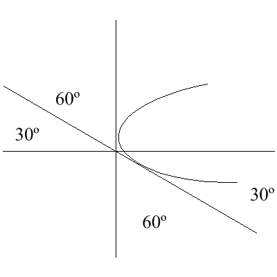

An AOA probe can be made using only a single pop rivet with the mandrel removed. Connect the rivet to the AOA sensor with Tygon tubing. The sensor will compare the pressure differential between the pitot tube and the AOA port (pop rivet). Vans Aircraft uses this rivet probe in the latest version (iS) of their RV-12. The picture shows where I located the AOA rivet port in my wing. I drilled the rivet hole at the point where the 30 degree line is tangent to the wing. Although Van's tested different locations and determined that the optimum location is slightly farther down and and aft. Exactly where, I do not know.

Joe Gores

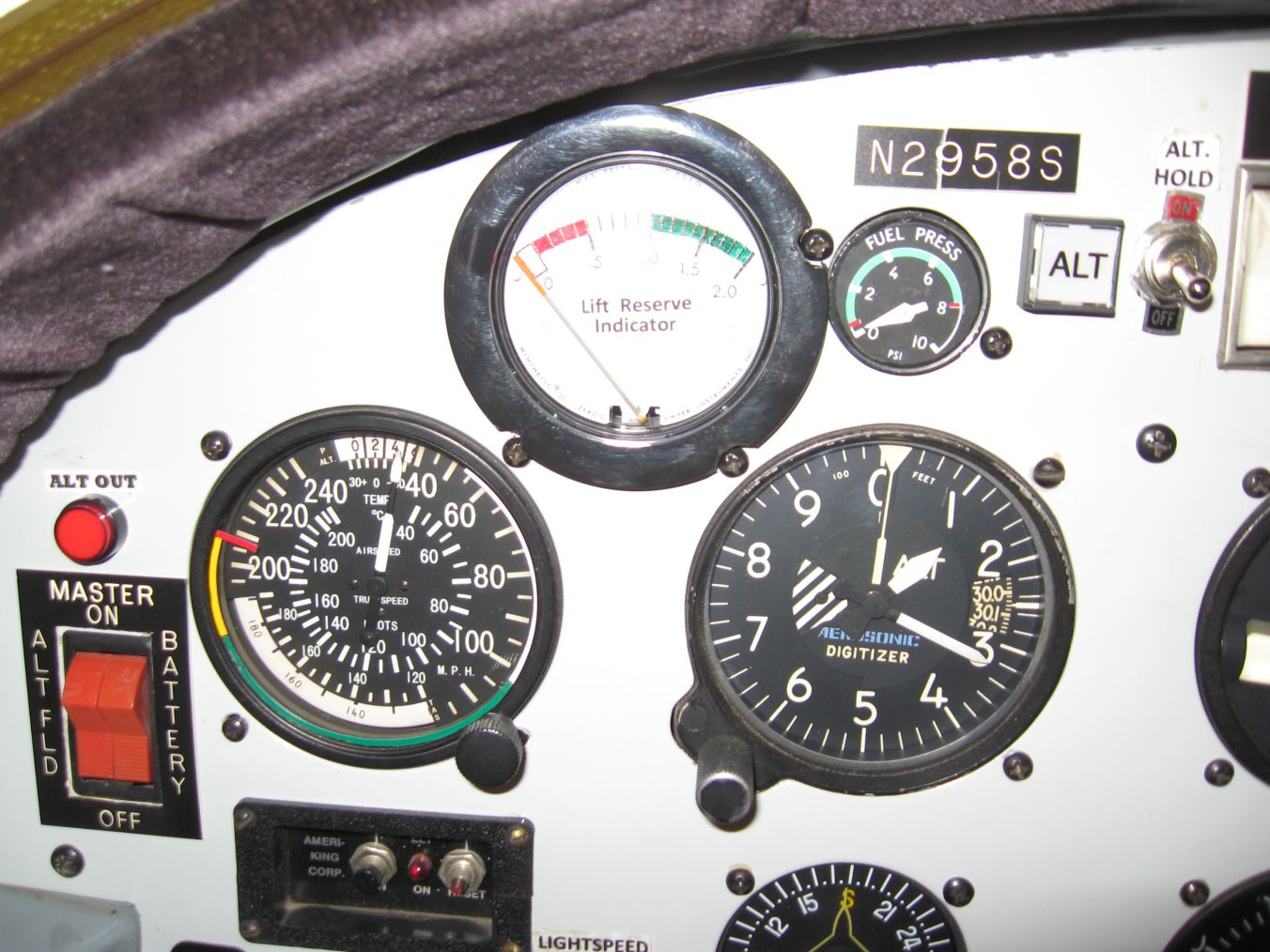

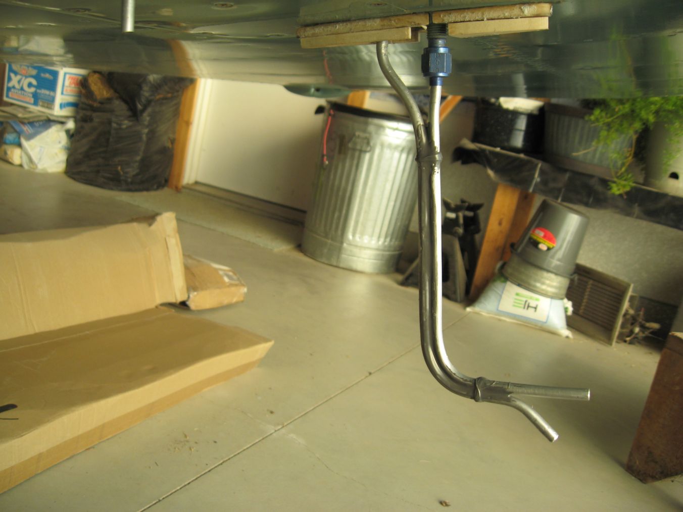

Here's an article one of the members of EAA Chapter 88 wrote for our newsletter a few years ago. Seems to be the same idea y'all are talking about.

We had some discussions here on the List about
various AOA sensor/display options about 15 years
ago. During and since that time I'd collected some
articles on the topic which I posted here
https://goo.gl/5XdU1y
One of the articles cloned a sensor mast that
was popular with Piper as I recall. Don't recall
the manufacturer off hand.
[img]cid:7.1.0.9.0.20180415175131.0642aaa8(at)aeroelectric.com.0[/img]
This probe was mounted under a wing on an inspection
plate. Pretty easy to build. I recall that I offered to carve
one out for a builder . . . but he never took me up on it.
Something I've found quite useful before launching
on any new development effort is to explore history
of the practice. Patents are a useful place to lay foundations
for refining the next generation . . .
 Filesize:  186.68 KB
 Viewed:  13978 Time(s)
