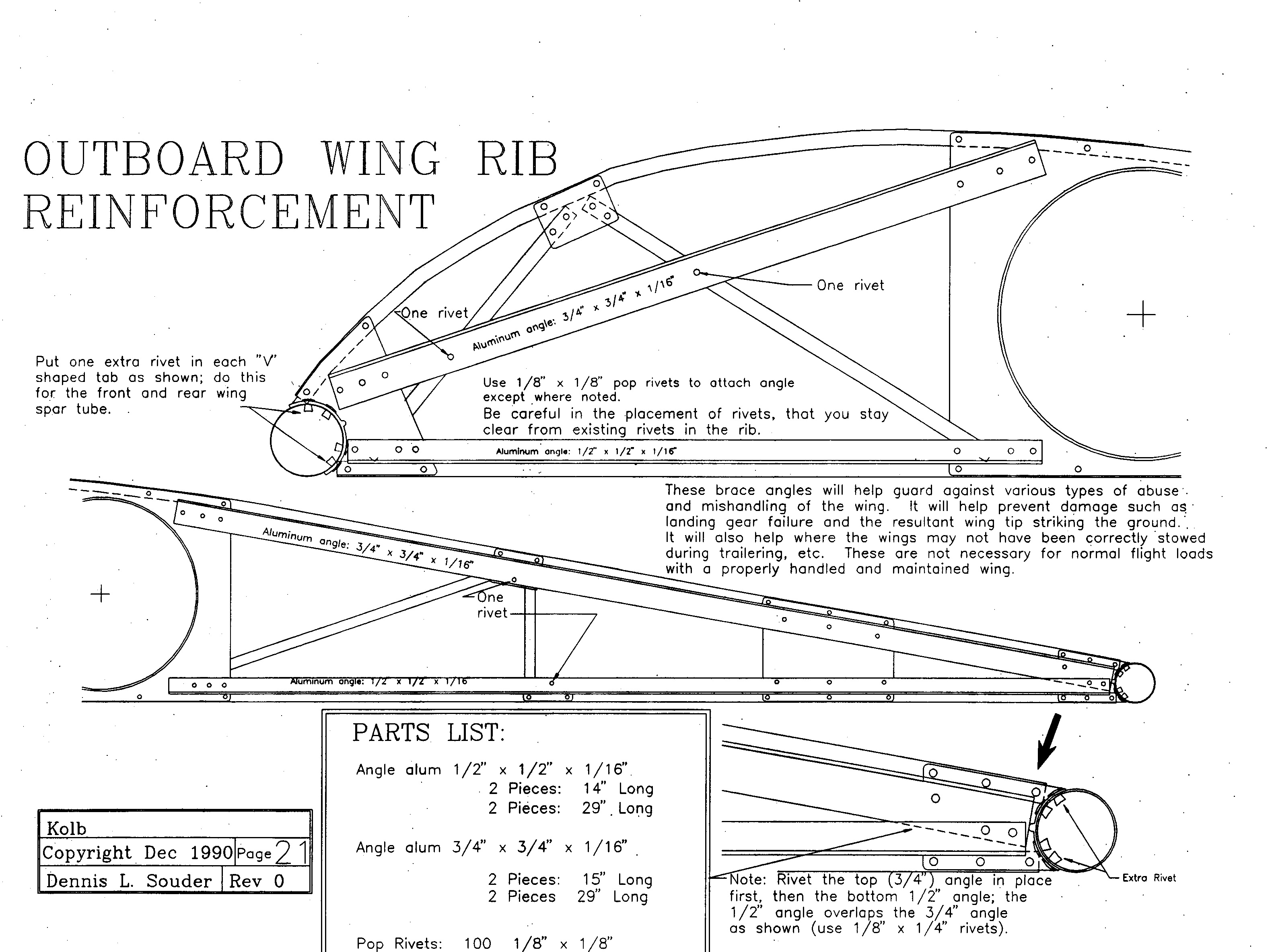

The only things the wings need is a reinforcement of the tip ribs, scroll down to page 21 in this link: http://oh2fly.net/oldpoops/Lexan%20rear%20enclosure.html
The only thing the fuselage needs is a brace on either side of the lower rudder post to protect against excess side loads from the tailwheel, here: http://forums.matronics.com/viewtopic.php?t=95198&highlight=tail+braces

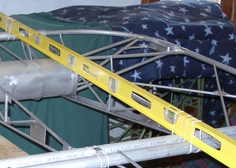

In addition to the outboard rib angles I added a lift handle with extra supports at the wing tip. I also added extra "trusses" on the tailwheel support. See attached pics.

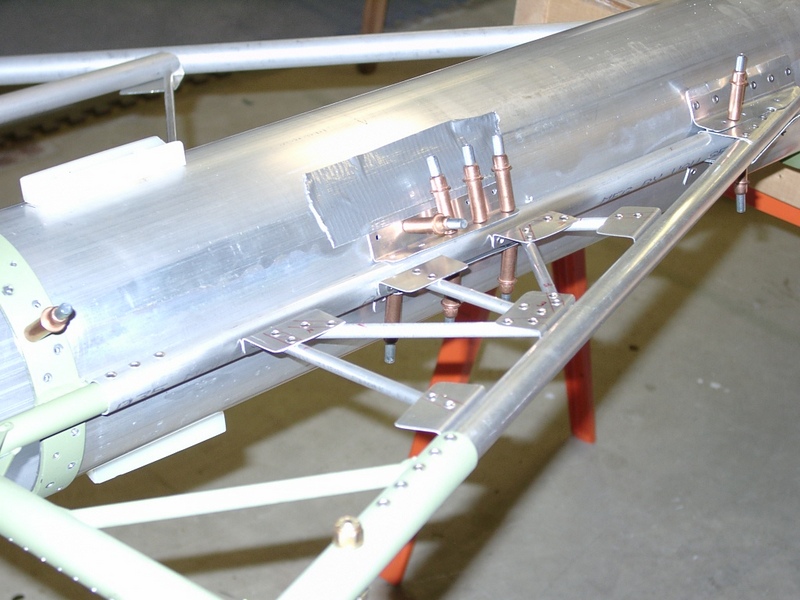

This is the tailwheel supports.

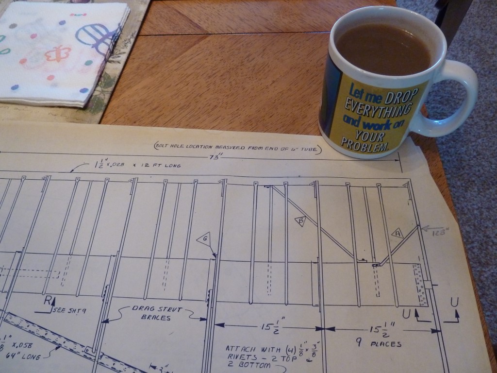

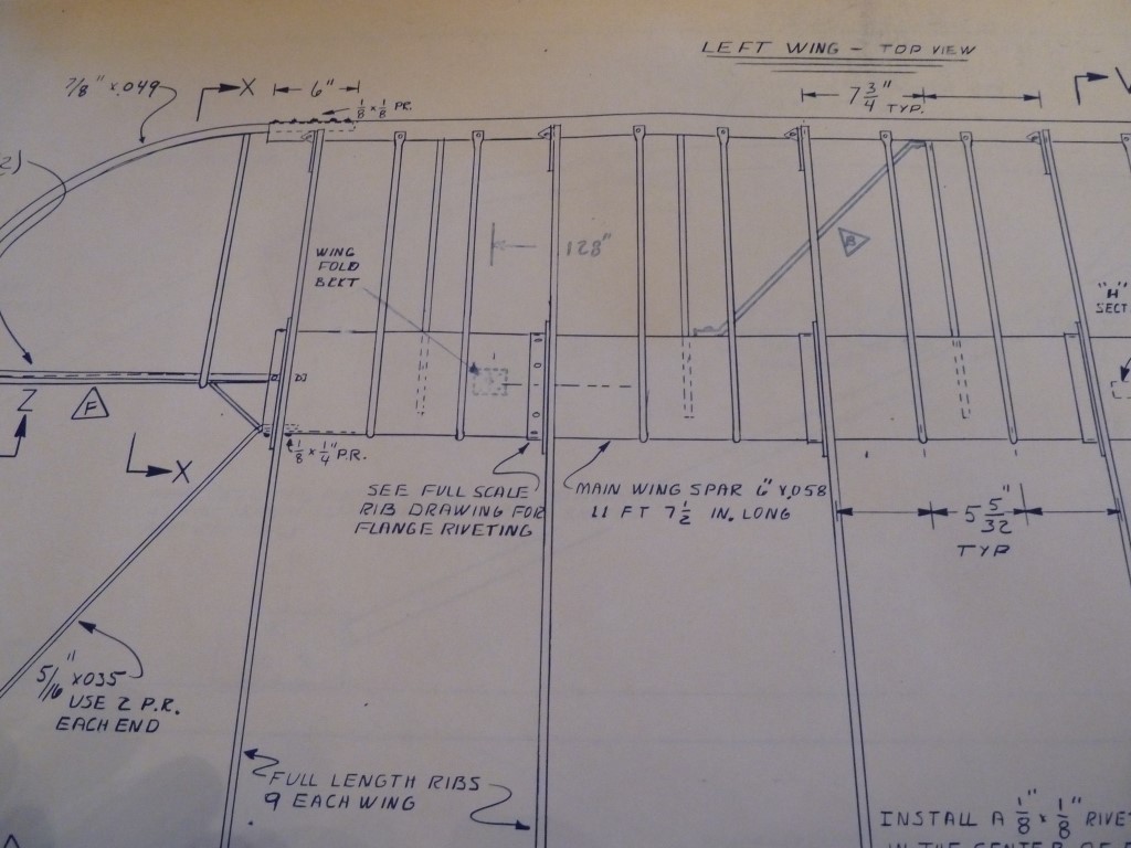

Notice the diagonal braces from the leading edge to the main spar (B inside the triangle): It is not a bad idea to add a backup to them, because if the ribs between the spar and leading edge go out of column, really bad things will happen. I used some 1/2" x 1/2" x1/16" angle from Lowes.
Sheeting the leading edge has been tried, it does not help, just adds weight.

Richard P has that right. The standard 5/16 leading edge braces have a
tendency to fail due to vibration and time. They are also vulnerable to
failure if your Kolb has a wing strike. Most folks don't realize how much
stress the wing experiences from the main spar forward, including me, but
that area of the wing is working pretty hard.
Homer Kolb told me the sheet metal leading edge actually decreases the Kolb
wing's performance. The fabric valleys between ribs enhance performance. I
don't know, but I'll take Homer's word for it.
weight.

Richard and John...... Great input regarding the diagonals..... surface contact between 2 round tubes is minimal to begin with.... then asking a 1/8" pulled rivet to exist happily with about 3/8" grip length and reversing loads...... ahhhhh... must be a better form. Will fab up something that improves on existing and add one "V brace" style with concentric contact points to either end.
Thanks!

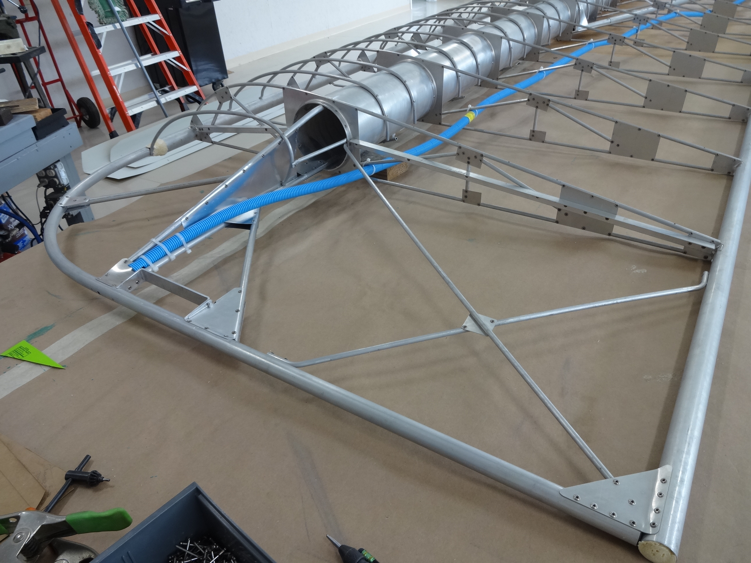

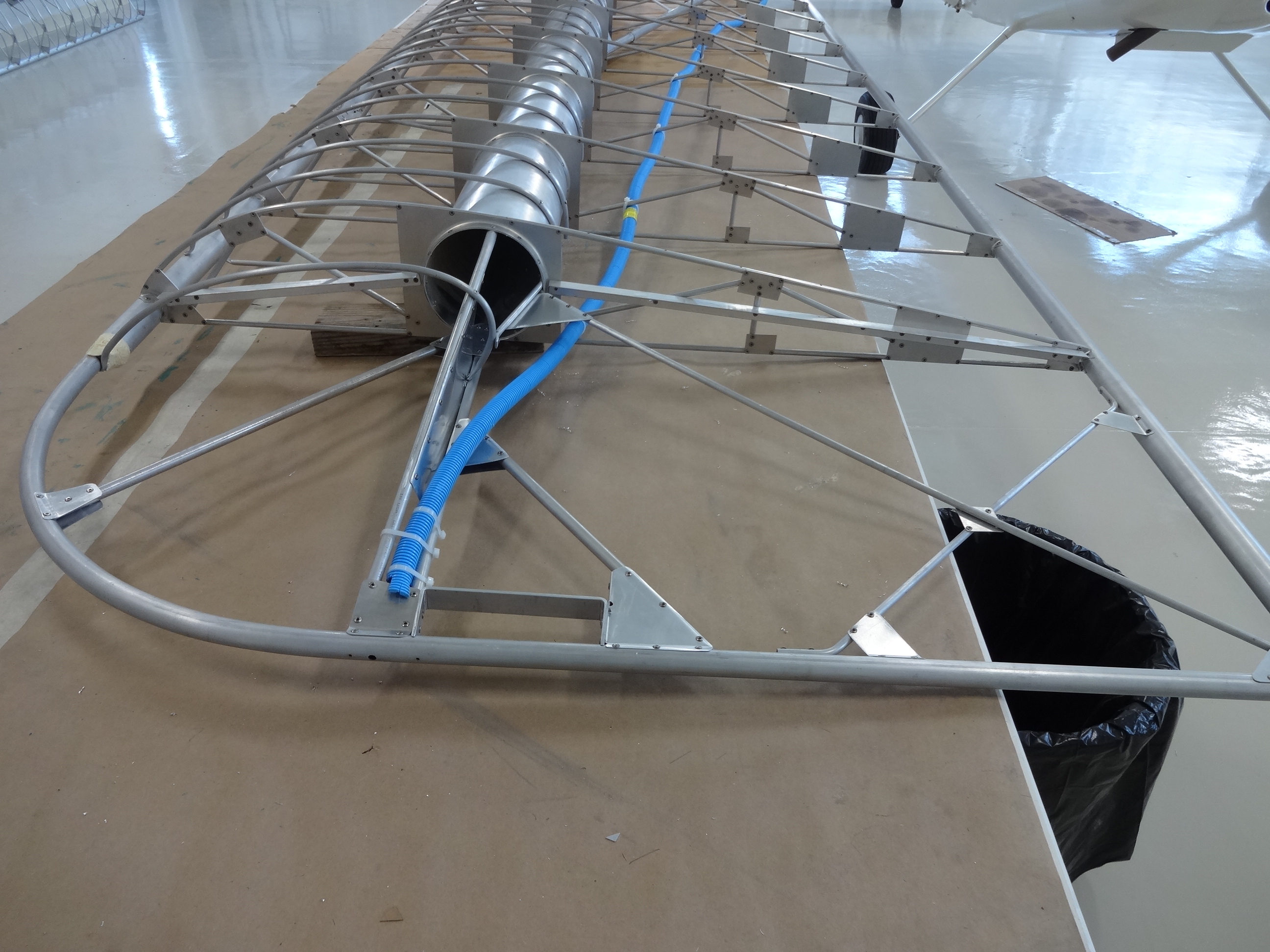

PostPosted: Wed Mar 28, 2018 5:16 am    Post subject: Re: Wing structure upgrades Reply with quote

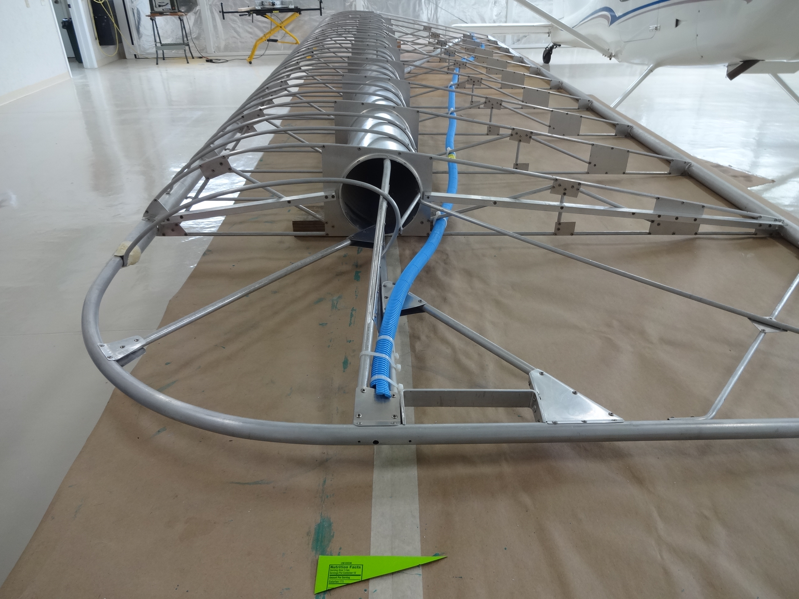

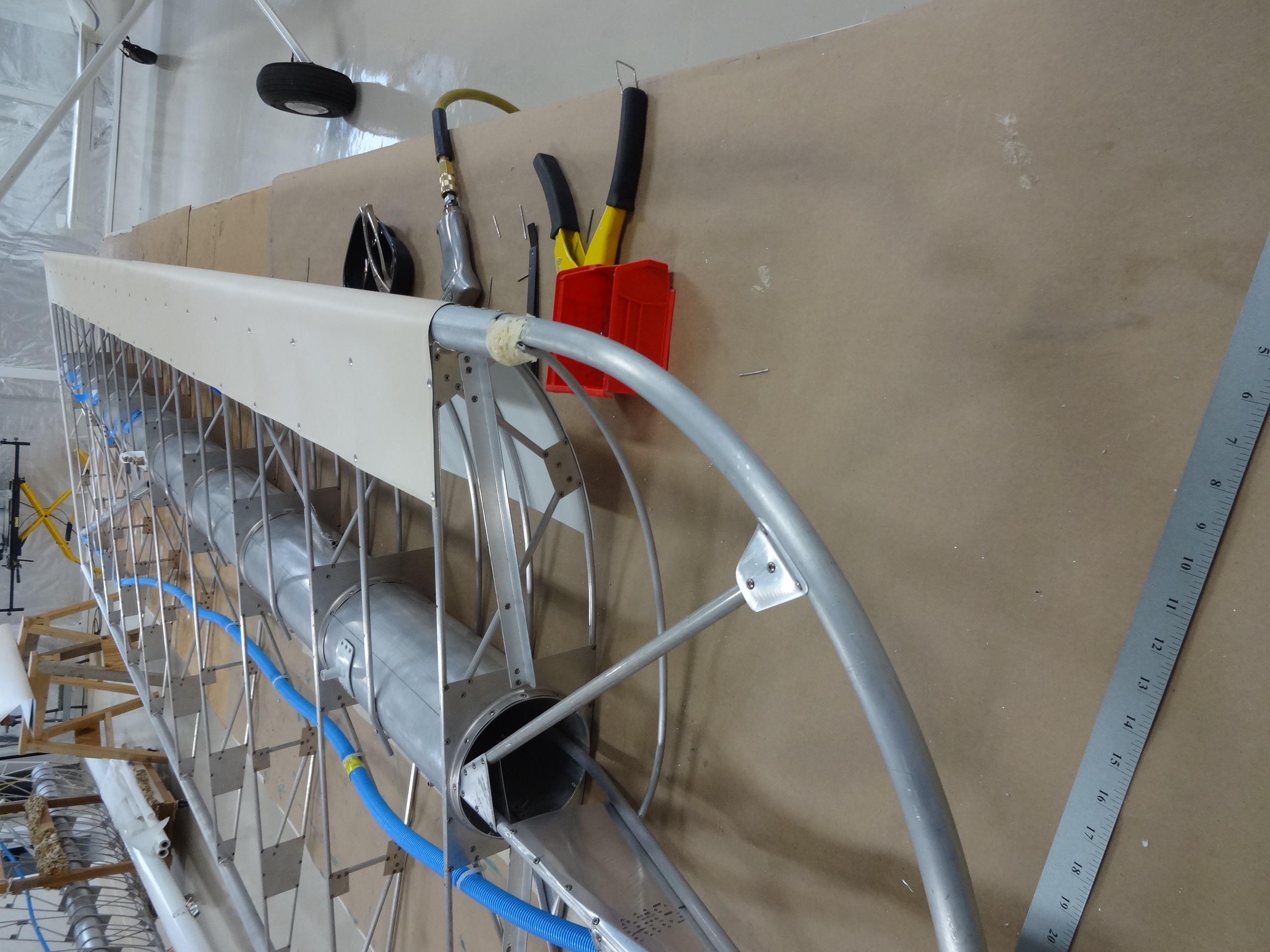

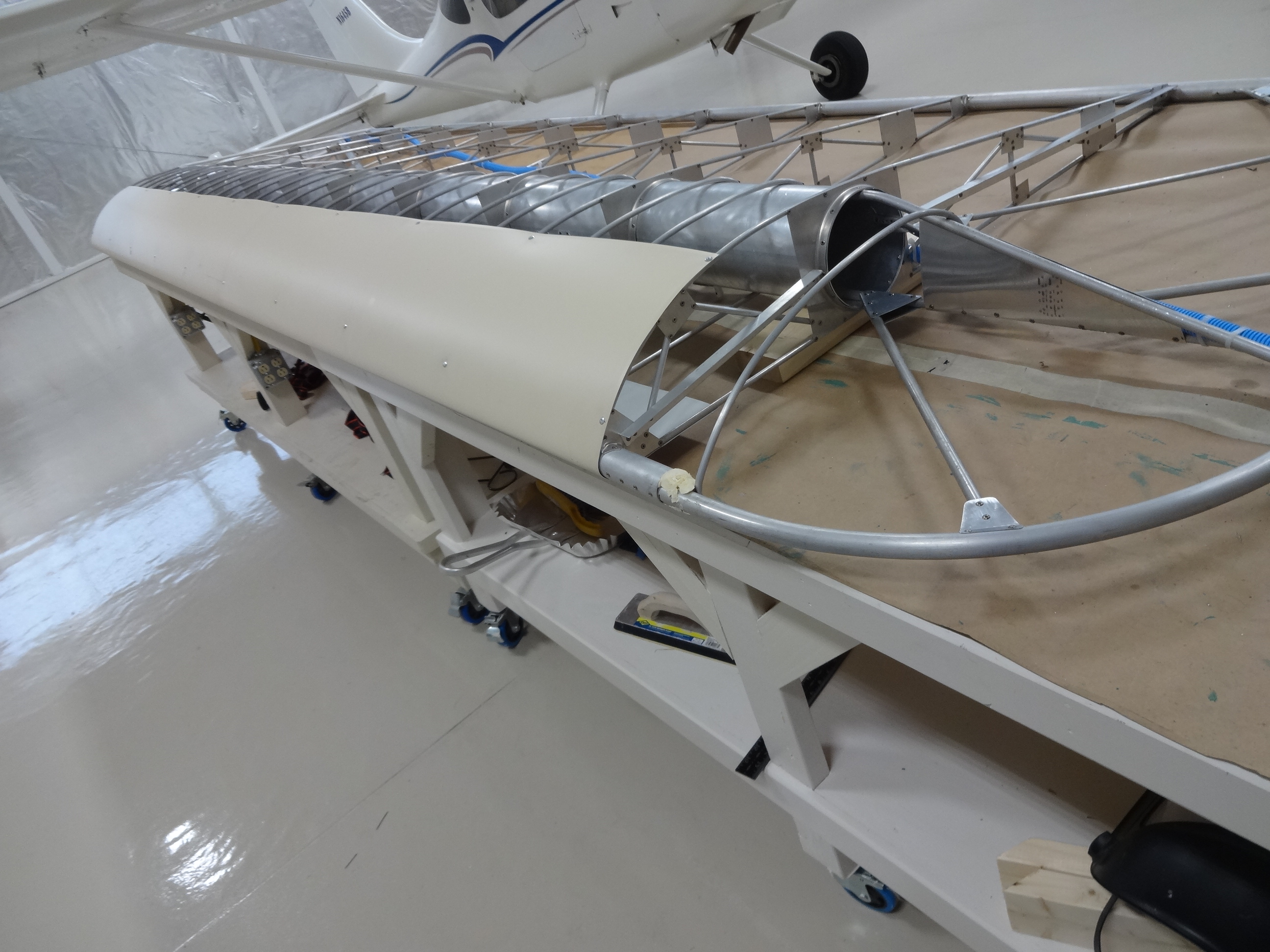

Again, thanks to all for the ideas and photos..... generous and well appreciated assistance. Here's the result..... so far. Will try to post a photo or two as the wings progress toward covering.
Mike Cranson
 Filesize:  1.86 MB
 Viewed:  28878 Time(s)
 Filesize:  1.75 MB
ceengland7(at)gmail.com
PostPosted: Wed Mar 28, 2018 5:50 am    Post subject: Wing structure upgrades Reply with quote
On 3/28/2018 8:16 AM, k3x wrote:
--> Kolb-List message posted by: "k3x" <consort2(at)msn.com> (consort2(at)msn.com)
Mike Cranson
Looks nice, but did you weigh that blue tubing? (How often will you be re-wiring your wing?)
Charlie

PostPosted: Wed Mar 28, 2018 8:18 am    Post subject: Wing structure upgrades Reply with quote
Mike C,
I've attached the Kolb Co modification of the wing rib. You may want to
reconsider your current mod.

PostPosted: Wed Mar 28, 2018 9:07 am    Post subject: Wing structure upgrades Reply with quote

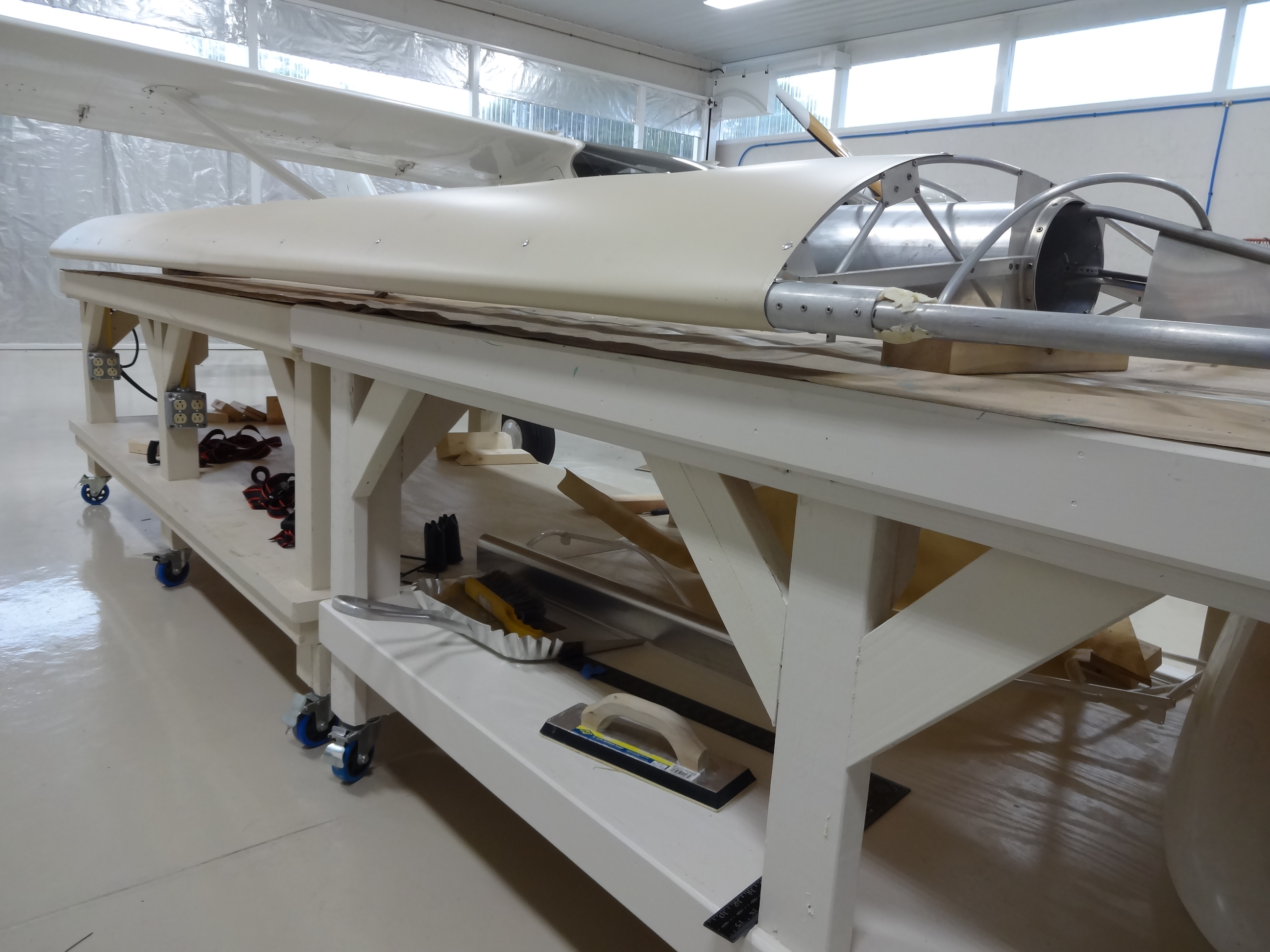

How is it possible to have an aircraft workshop that clean ???
Wing construction looks great to me.

k3x
Joined: 21 May 2013
Posts: 9
PostPosted: Thu Mar 29, 2018 4:55 pm    Post subject: Re: Wing structure upgrades Reply with quote
Hello to all.....

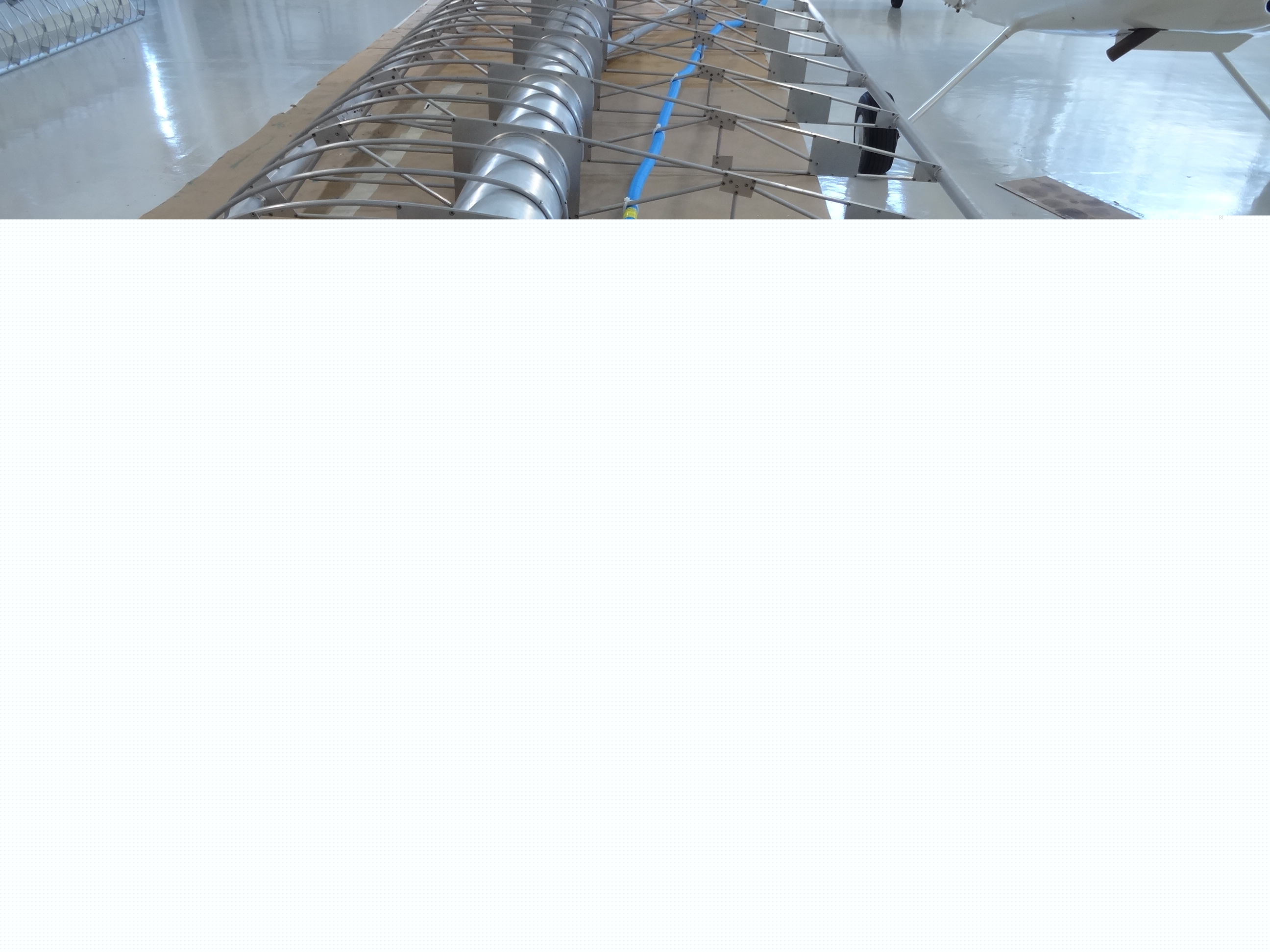

Good eye for detail John.... I needed to draw the line somewhere and this is where I chose to compromise a bit..... perhaps in the next, and hopefully last "pre-cover" post it will make sense.
All up, the wing mods added a total of 14 pounds of materials. 9.8 pounds of which I'll add tomorrow, so are not in today's photos. Please do not assume that I believe the Kolb Mk3-X design is lacking..... this is just stuff I had the time and inclination to fab up & see how it works out in my application.

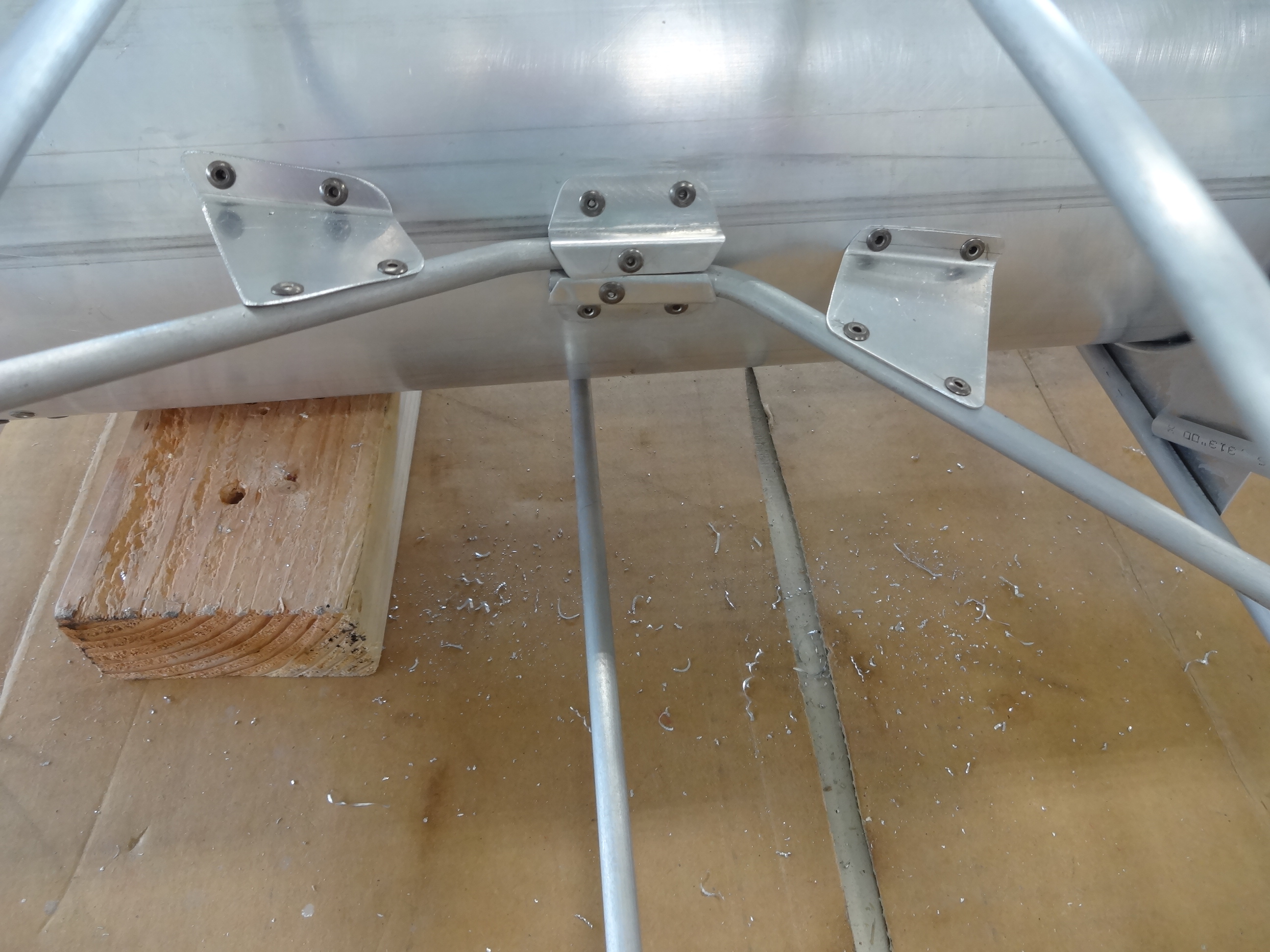

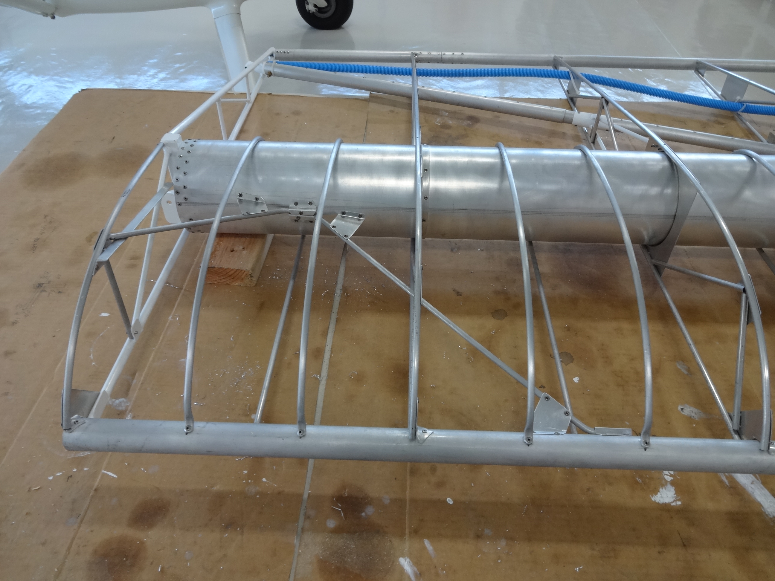

Late start so only finished one wing..... am somewhat tentative in posting todays photos as the signature "hungry horse" leading edges may be a touchy topic to purists. Formed leading edges probably make no difference..... except in weight (4.7 lbs each) .... so please consider these a cosmetic indulgence. Comparing the rigidity in column between the two made me glad I indulged.
Mike C

Mike, The great thing about experimental aviation is that it's perfectly okay for you to make this mod. I don't know if it will get you any benefit but it will be your airplane and should stand out from other Mk 3's. Can't wait to hear how she flies.
Rick Girard
PS Those are awesome build tables. I'm going to copy them once I get the hangar cleared out to rebuild and restore the Firestar and Mk 3
