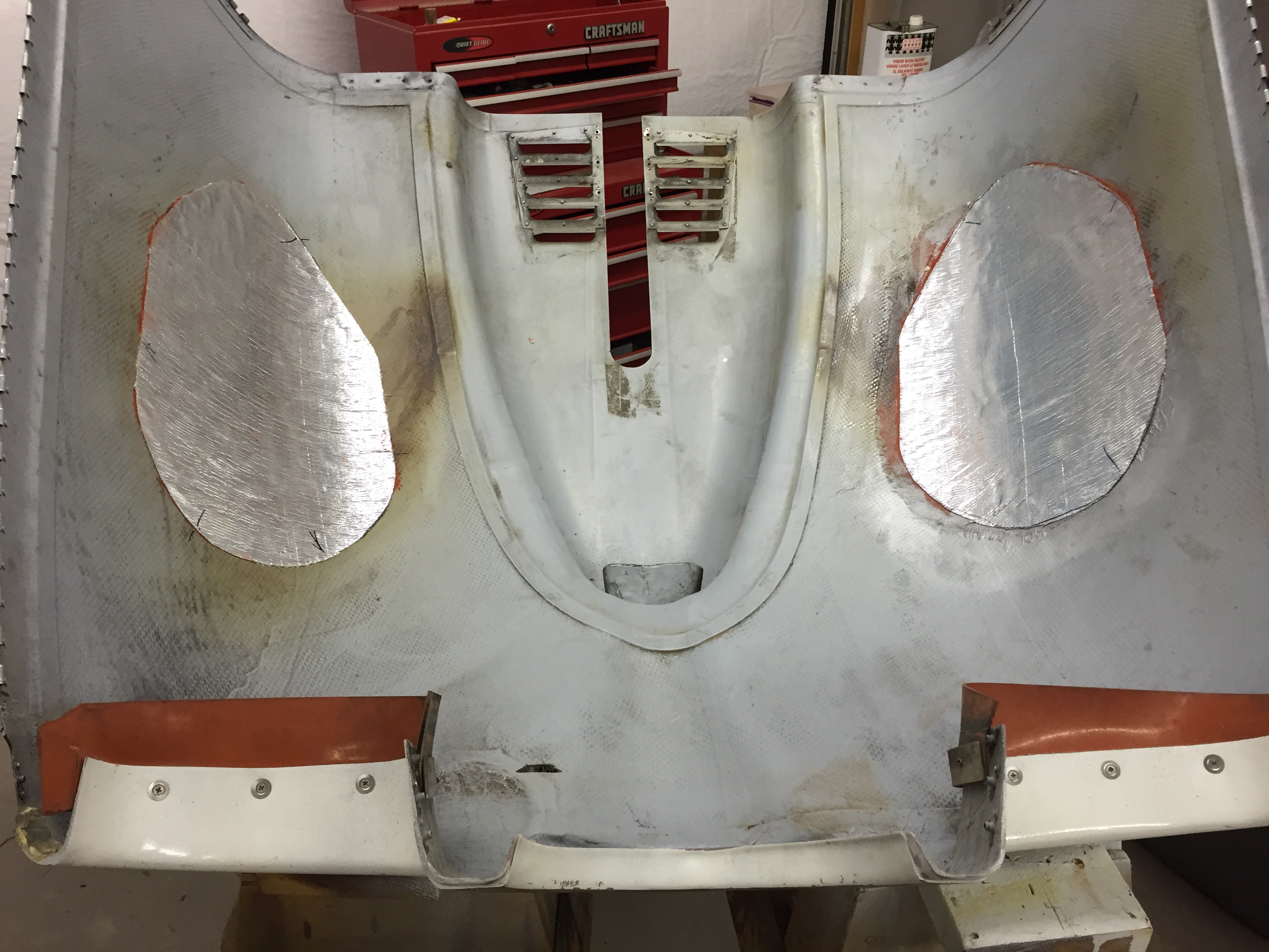

PostPosted: Tue Mar 20, 2018 2:30 pm    Post subject: Cowl heat protection Reply with quote
Here's what I did after allowing heat to damage my cowling.  The bad
news is that I had to repair the cowling's inside surface and structure
(scarfing, cloth, honeycomb).  The good news is that I had a real good
indication of where the heat problem was.  I have flown 2 years since
then with no additional damage or concern.    I used red RTV to adhere
the pieces of foil faced insulation - probably the same stuff Tim used
but not sure.

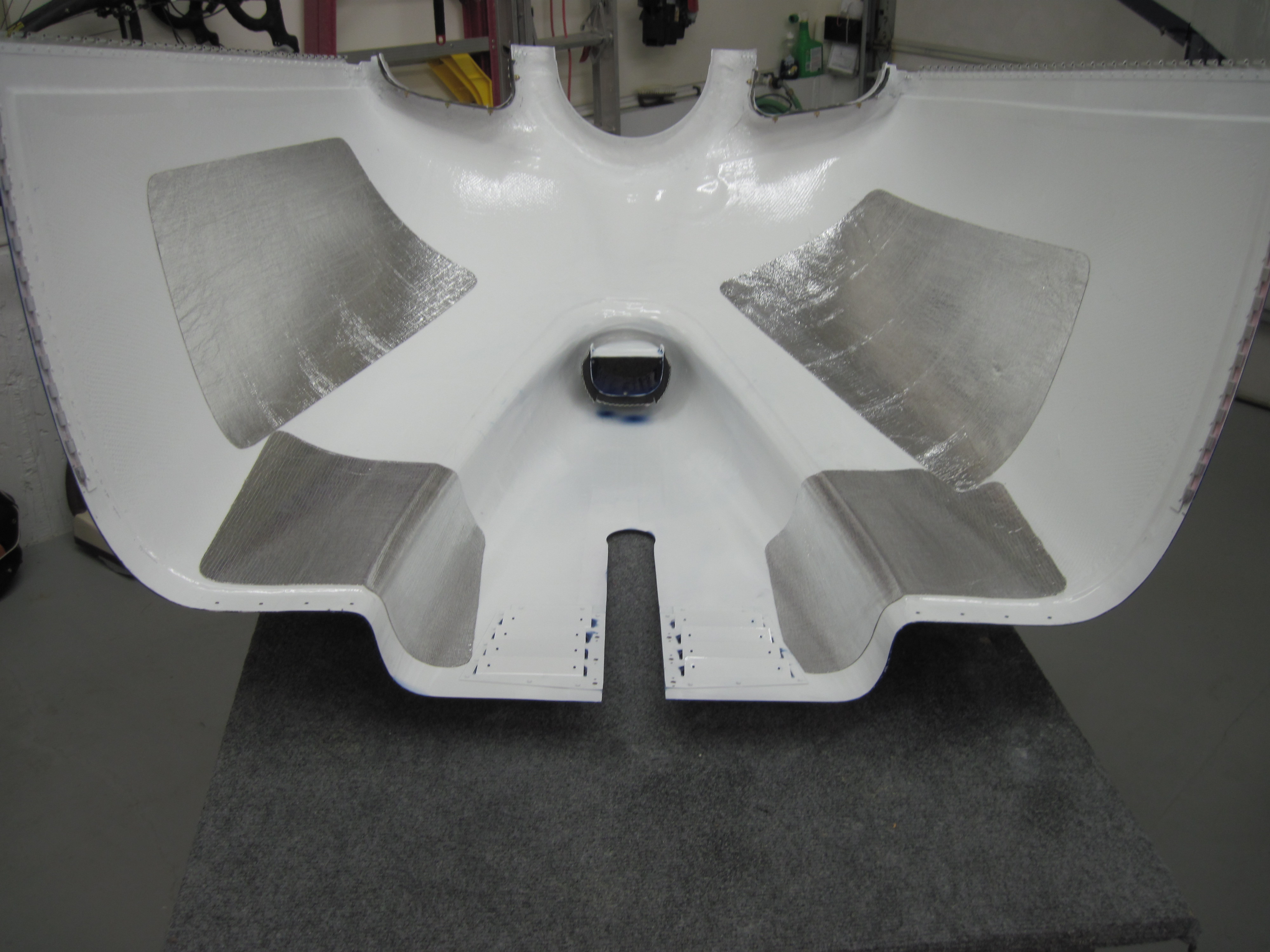

PostPosted: Wed Mar 21, 2018 4:51 am    Post subject: Re: Cowl heat protection Reply with quote
Stick on reflective heat shield from acs
 Filesize:  1.75 MB
 Viewed:  16983 Time(s)

Not surprised.  I used visible heat damage (from structural composite damage to singed paint) to guide my coverage.  There may be more going on than simply proximity of exhaust system parts to cowling.
I guess the 'safer'  but slightly heavier approach would be to cover it all as Tim suggested.
On 3/20/2018 9:49 PM, Don McDonald wrote:
I took a pencil and marked the areas that were fairly close to any exhaust pipe (with the bottom cowl on).  It looks like your area covered is smaller than mine.... just sayin'.
