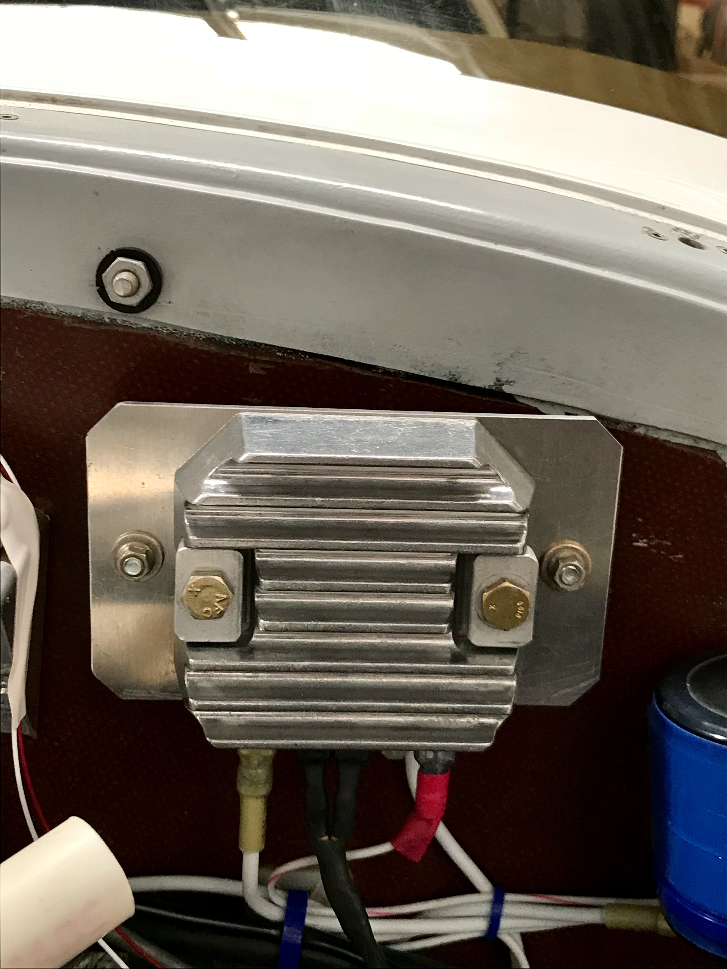

Hi guys, I just recently installed an aftermarket voltage regulator replacing the Ducati on my 914. Its a John Deere unit that the RV12 folks are using with good success. The part number is AKH6004. I found it online for $20.23 with free shipping. The unit has a set point on 14.2 volts. I ordered a second one to keep in the plane as a spare. At that price it was too hard not to. While not exactly plug & play, it only required a sub plate to retain the existing mounting holes. See picture attached.
