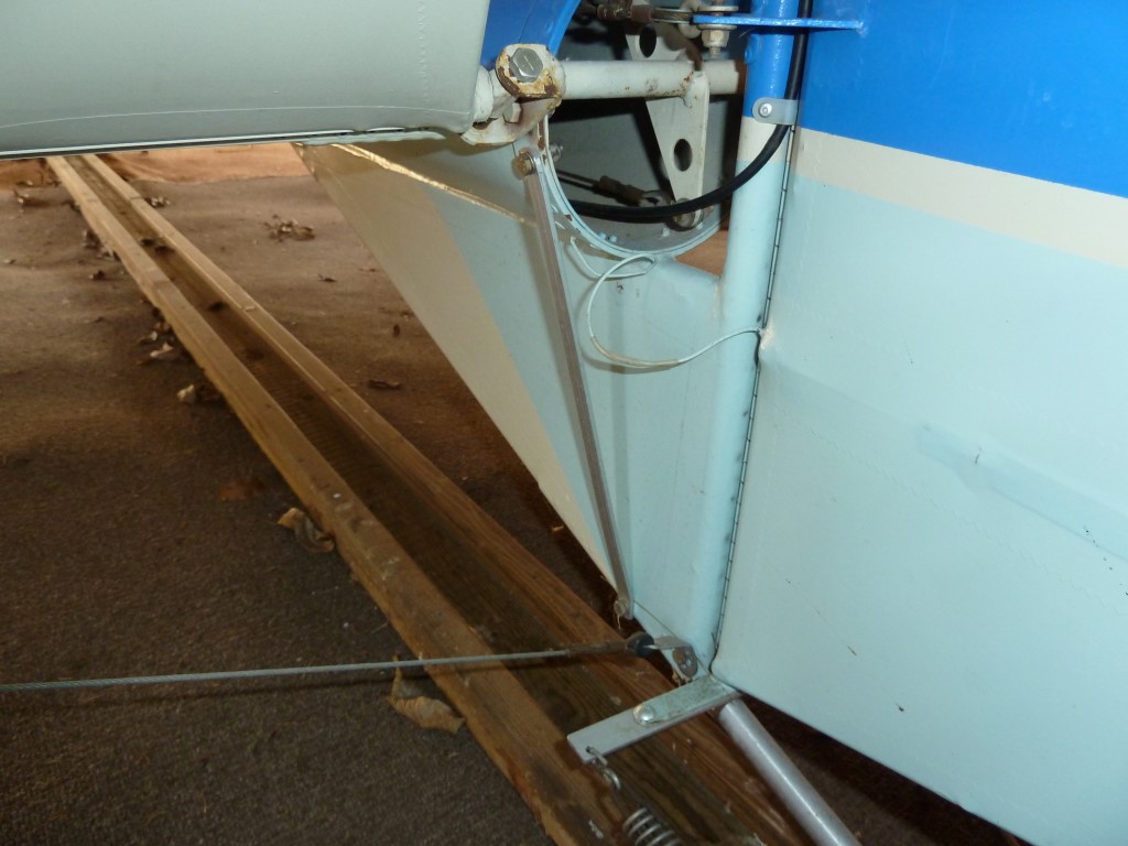

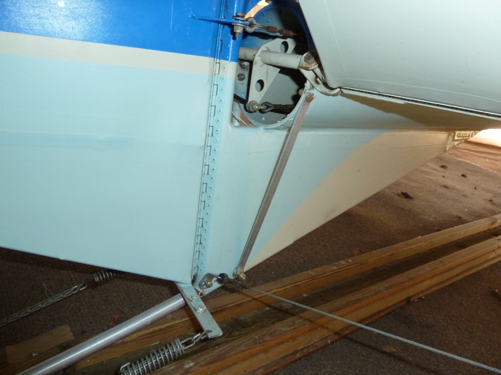

More likely it cracked because of torque on the tailwheel during turns on rough ground. There is a simple fix: a brace made of 1/2" or 3/4" x 1/8" aluminum flat stock from Lowes to brace the lower end of the tube.

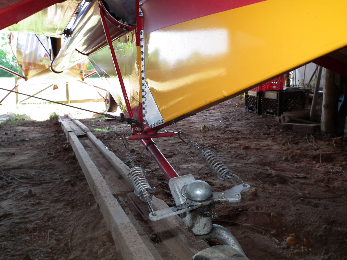

If I understand correctly, your question was not about where the cage attached, but the tail post that secures the tail wheel. If this is correct then the cause for the crack is cured by a breakaway tail wheel.Larry

Doubt slips caused your problem. More like lateral stress experienced
during ground handling.
There is no lateral bracing for the tail post except where it is welded to
the tail boom ring.
My MKIII experienced this problem several times before a friend suggested
some external lateral bracing. Went that route in 2004. No more tail post
problems.
Let me see if I can find a photo of our modification. The attached photo
will give you an idea of what we did. Welded a strut on each side of the
lower tail post and tail boom ring.
Some Kolb owners have used bolts to attach aluminum or 4130 chromoly steel
strap instead of welding.
For some there is a misconception that the tail wires are "tail bracing
wires". I don't think they brace anything. Their main function is to space
the vertical and horizontal stabilizers.
These new struts do a good job of removing lateral slop and strengthening
the tail section.
