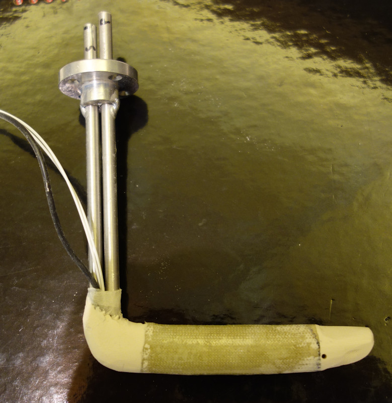

I have a design based on the standard tube. It's proportional with a max of 1.6 amps. I put the mod 2 form in and made a prototype. Laa said I'd need to prove that it didn't affect the airspeed readings etc. It uses a nichrome wire wound on kapton sleeved in glass fibre needs 4 wires to the control circuit ( under pilot seat)
