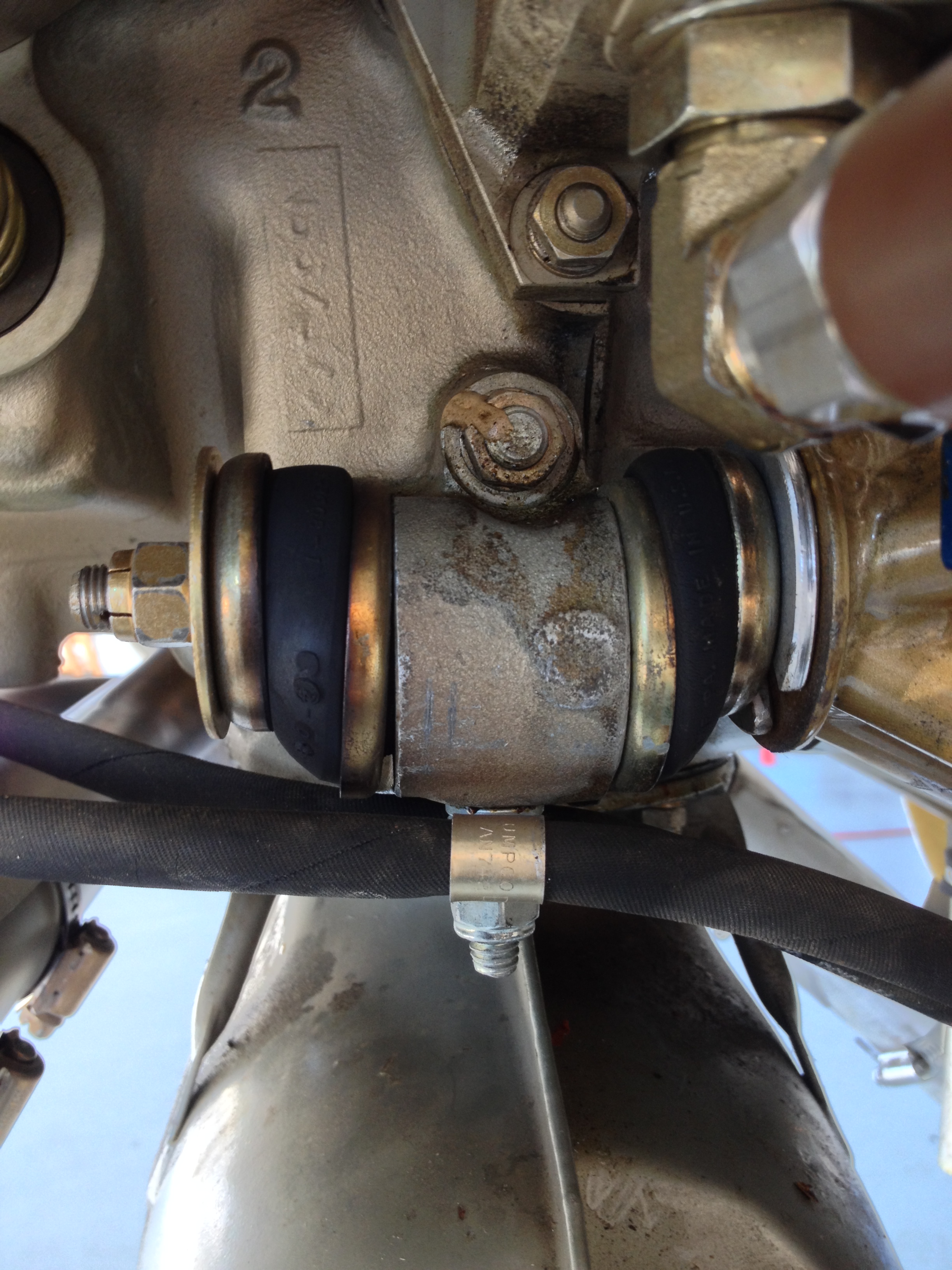

For those not familiar with the problem please see the attached IMG_0259(2).jpg. This what the Continental Motors provided bushings will sag into eventually.

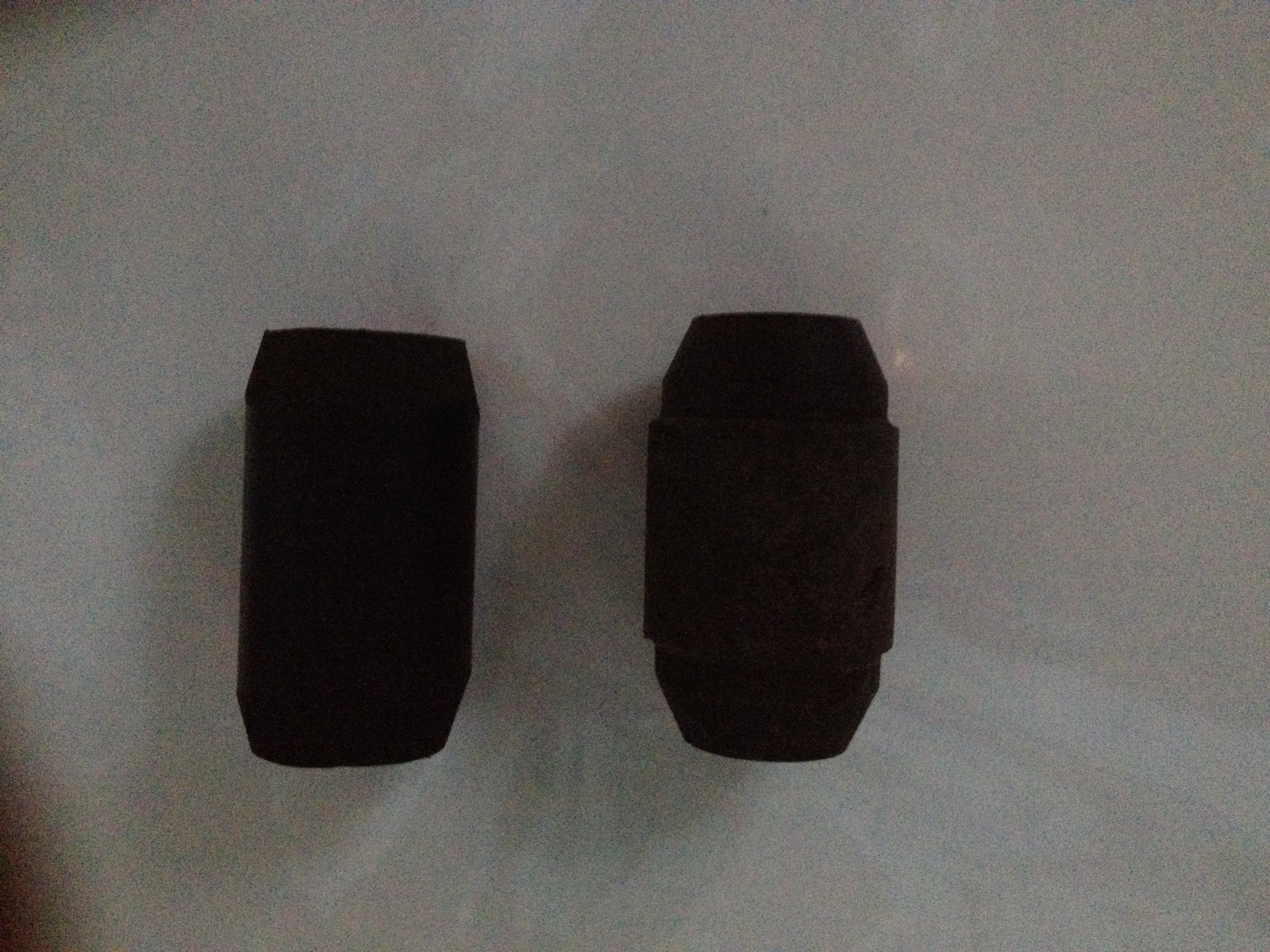

Hello Again Bruce Lina, As promised I have searched though the past correspondence on this subject and have the following extracted information for you:
You could make and install your own substitute 638225 bushings as I have
done described here:
I decided that the hose 86805K53 from McMaster-Carr was the most suitable of
the four different hose samples that I had.
http://www.mcmaster.com/#catalog/121/3569/=yyg3wt
From the two six inch long pieces that I had received I made a total of six
substitute 6838225 bushings. I cut the hose into lengths about 1 3/4 inches
long using my chop saw (nice square ends). Then I reamed out the center
holes of the six pieces of hose in stages to an inside diameter of 1/2 inch
using my drill press to permit entry of the metal spacer part number 653695.
Then I mounted the bushing on a 1/2 inch diameter bolt about six inches long so that I could
hold the bushing and rotate it against my disc sander to create a taper on
each end. I finished off each tapered end by chucking the bolt in the drill
press and holding a sanding block against the tapered end while the bolt was
rotating.
See the attached picture of the results. Mine on the left, Continental’s on the right.**
My home made version has a Durometer of 75A which is harder than the 30-40
rating of the CM provided bushing.
I have flown my plane with four of my substitute bushings installed and if
there is any increased vibration because
of the greater hardness of the substitute bushings it is undetectable.
My total cost for the two six inch pieces of 86805K53 tube, which yielded a
total of six bushings, was
$13.44 USD plus shipping.
Please let me know how you decide to solve your engine mounting problem an if you have any further questions. Thanks.
