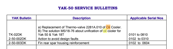

PostPosted: Thu Jan 18, 2018 2:56 pm    Post subject: Re: Super-cool oil temp Reply with quote
Doing some additional detective work... seems like replacing the "thermo-valve" was one of the very first service bulletins. But the details of this are lost to me (and don't affect my s/n).
Any chance the original SB exists somewhere (and might even be in English Smile )?

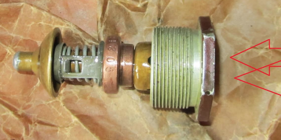

PostPosted: Fri Jan 19, 2018 10:08 am    Post subject: Super-cool oil temp Reply with quote
Richard, I happen to have some knowledge on this topic.
Very early YAK-50's came with what guys in this country call a "Veritherm", but in truth is nothing but a thermostat. This device, when the engine was cool, by-passed the oil cooler and warmed the oil up faster of course. It is not binary... meaning just open or closed. It regulates temperature and will actually maintain oil temp where it is supposed to be, usually even with the oil cooler door wide open.
At some point of time, there was a Russian directive, which I am sure you can find, that REMOVED these devices from the oil cooler. The Russian logbooks for my 1985 YAK-50 show this as being done. The result was that my oil cooler did not have the thermostat installed at all, and it took a very long time to warm up the oil in cold weather, just as this person is experiencing. The thermostat itself is set to by-pass the oil cooler, and when it starts seeing warm oil, it then runs the oil THROUGH the oil cooler. If it fails, it usually fails in the by-pass condition, which is... I think... why the Russians removed it. It is failed in that position, it will cook the oil and possibly ruin the engine. In any case, my oil cooler thermostat had been removed and so noted.
I obtained one of these thermostats/veritherms out of a Russian oil cooler for an M-14 helicopter and put it back into my YAK-50 oil cooler (easy job really) where it now operates perfectly. I wrote all this up about a decade ago on the YAK list.
My guess is that he does not have a stuck thermostat, but that instead he has not got one installed at all.
Mark

mark.bitterlich(at)navy.m
PostPosted: Fri Jan 19, 2018 11:09 am    Post subject: Super-cool oil temp Reply with quote
Andrew, it has been 10 years ... so my memory is not picture perfect. But I do think you would have to remove the oil cooler to know for sure. As I recall it screws into a hole, and we had to remove a screw in cover, and replace it with the thermostat part. I am at work and do not have access to my manuals which MIGHT show it. I'm afraid that is the best I can do. The person who would know for sure would be Vladimir Yastremski. He is up the street from you in Ramona CA. Or down the street? Whatever.
Mark

PostPosted: Fri Jan 19, 2018 7:16 pm    Post subject: Re: Super-cool oil temp Reply with quote
Thanks much, Mark and co, for the further help. I got a picture of the thermovalve today (at least I'm pretty sure this is it).

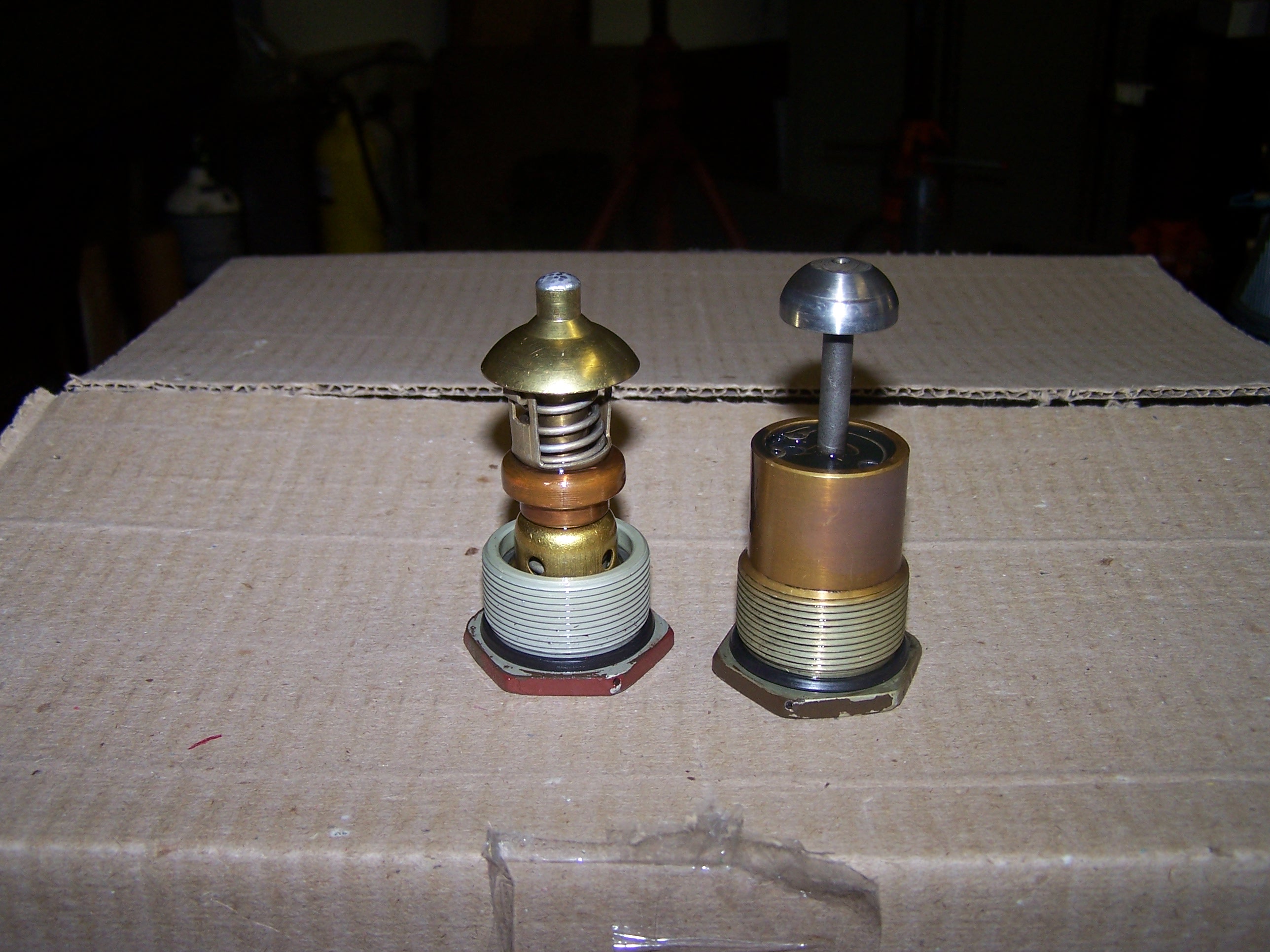

PostPosted: Sat Jan 20, 2018 3:11 am    Post subject: Re: Super-cool oil temp Reply with quote
Hi Andrew,
Like Mark I also fitted the original 'thermo(stat)-(safety)valve' back into my -52 in 2010 and it's reduced the engine warm-up time and more importantly got the oil temps into the green to boil off any corrosive moisture (mine's a cool engine in-flight).
I've attached an image of the two units with the thermo-valve (left) and pressure valve on the right.
Sourced the thermo-valve from a one-off surplus Mi-8 helicopter hydraulic inter-cooler in the UK (sometimes used for competition aircraft oil coolers). Given they made 17,000+ Mi-8s you would hope someone somewhere might have spares, but they seem to be like hen's teeth :-(
To follow on from Mark's thoughts ... the very cold weather SOP is to blow ducted hot air into the engine and oil cooler (see other image).
However this causes the original fit cooler thermo-valve to open about 7mm max (it's just a simple expanding paraffin wax device with an over-pressure relief spring at the base) allowing oil through the cooler matrix.
Trouble is the upstream large oil pipes feeding the cooler are still full of unheated congealed (Russian) oil ... that then gets fed into the cooler matrix on engine start with the potential to rupture it.
Now the over-pressure spring in the base is supposed to take care of this and my conjecture is that the limited travel and force required in practice was not always enough to protect the cooler matrix in time.
This is from having compared the operation of the thermo-valve versus the (field replacement) pressure relief valve and the latter takes less effort to operate (simply based on pushing down hard on both with my hand).
Presumably this is not an issue for Mi-8 helicopter cooler usage as the viscosity of cold hydraulic oil is less than aircraft engine oils.
FWIW - I've experienced no issues using the thermo-valve on my -52 over the last 7 years using western oils, albeit in less extreme temperatures (UK is relatively mild). YMMV.
Brgds, Rob R

PostPosted: Sat Jan 20, 2018 9:26 am    Post subject: Re: Super-cool oil temp Reply with quote
Hi Mark,
Wow. Thanks for the pictures and the additional detail on the thermovalve. I'm still working on finding one. Our typical Northern California temps aren't that extreme, but agree that the thermovalve is a more ideal solution.
Very helpful to see the difference between the PRV and the thermovalve.
