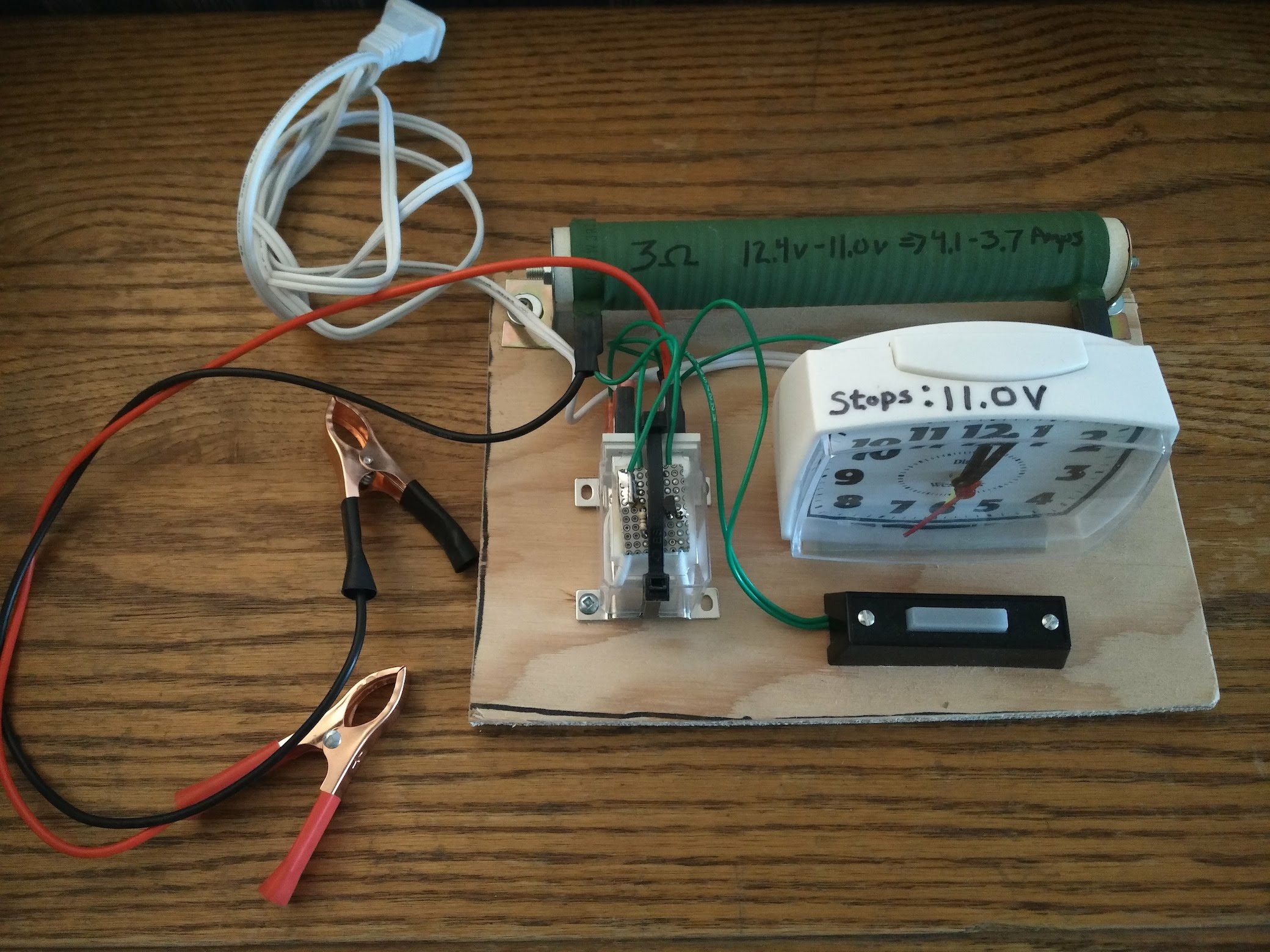

I've built up the capacity tester documented by Bob N. in: http://www.aeroelectric.com/articles/battest.pdf and thought folks might want to see what it looks like in the flesh.  I've attached a picture but let me know if it fails to show up.  Since I only get the digest version of the postings, I won't get it (I never see any attachments).  If anyone else who gets the digest want a copy, just email me direct with the request and I'll send the pic back in my reply.
The two resistors, the zener and the transistor are all on the little piece of prototyping circuit board zip-tied to the top of the relay.  For me it was easier to come up with a 3 ohm 100W power resistor than the 55W 12V lamp shown in Bob's schematic.
I tested the 17AHr AGM battery (Werker, from Batteries Plus) which I pulled out of my Longeze this last summer (after two years of service) and, at ~18 degreesF, it ran for 2hrs 35 minutes.  I've yet to test the battery I replaced it with.  This is no where near long enough to match my max duration (which is no surprise since my max duration at economy cruise at altitude is almost 12 hrs...) but it good enough to provide enough options.

Got it. Looks good!

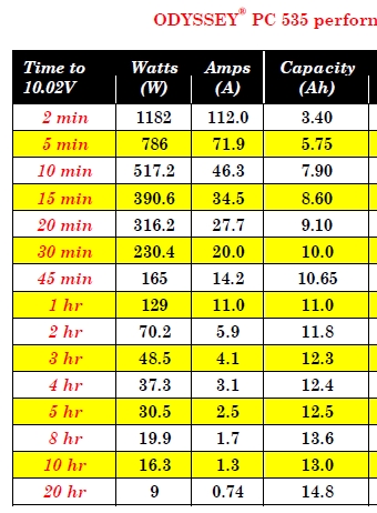

The PC535 (14.8 a.h. at 20 hour
rate) will deliver about 12 a.h. at
a 2.5 hour rate.

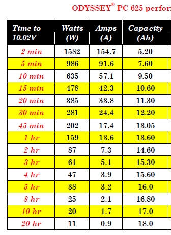

This suggests that your existing battery
delivers less snort than a new 15 a.h.
battery. Comparing to a PC625 (18 a.h.
at 20 hour rate), a 4A load should
be supported for about 4 hours with
a delivery of 15.6 a.h.
[img]cid:.1[/img]
This is on example of how the po' boy's
cap checker can be used to evaluate a
battery . . . your test article is down
to about 65% of new capacity. Time to toss
in the towel.

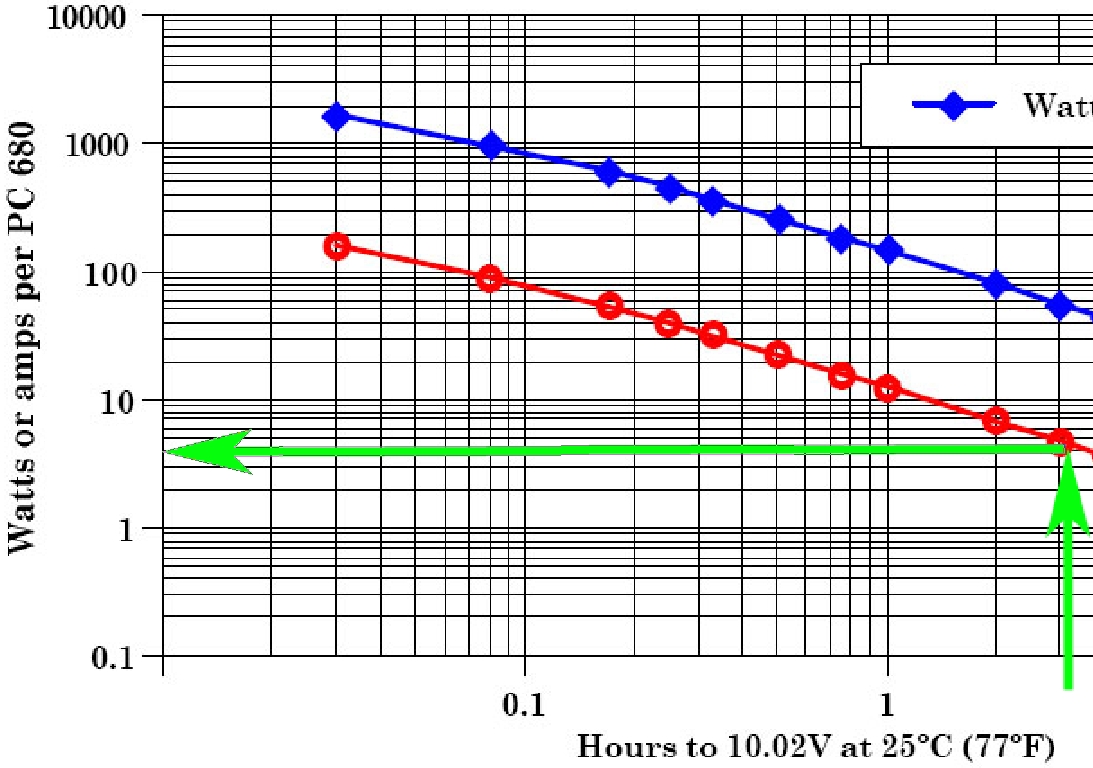

Interesting. Okay 11.5v average/3 ohms yields ~3.8A for 3.25
hours is 12.4 A.H. According to the Enersys data on a PC680,
the new battery supports about 4A for 3.2 hours
[img]cid:7.1.0.9.0.20180114102012.067626e8(at)aeroelectric.com.0[/img]
It would appear that your test article is pretty healthy. The only other
variable is load dump ability. Given the cap-check data, I'd bet
the load dump numbers are good too.
