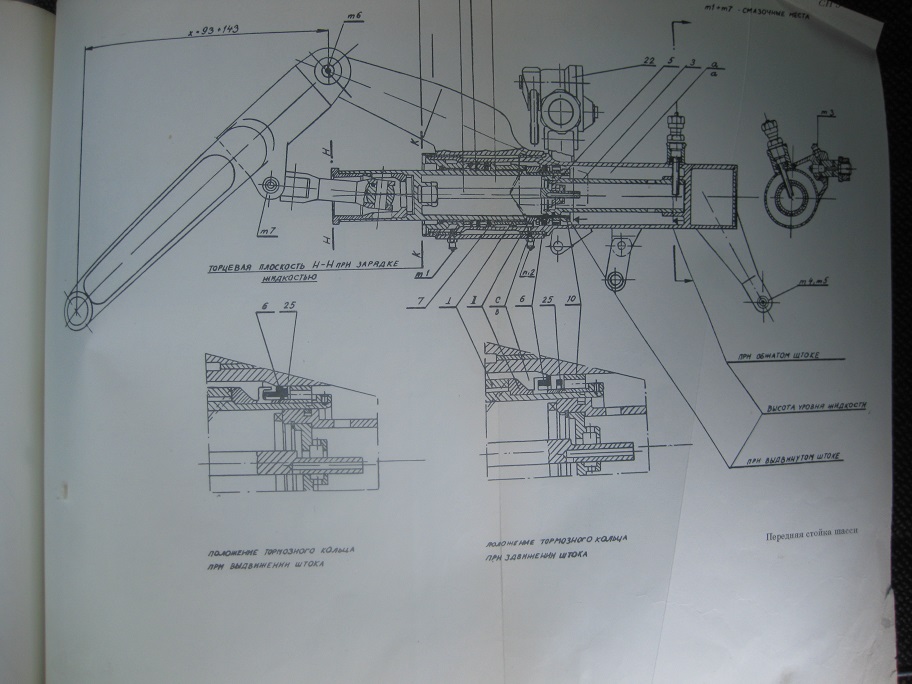

Ok guys....need some help here. In process of doing the condition inspection on the L29.  I'm servicing the nose gear strut with fluid and nitrogen. Maintenance manual says to depressurize the strut and add 3.38 ozs. of fluid and let set for 1-2 hours. then compress several times until the upper H-H edge of the piston rod nut is level with the K-K plane of the cylinder closing nut ( see Fig. 3.11). Excess fluid escapes thru the filler valve opening. After this operation, the quantity of AMG-10 (Aeroshell Fluid 4) will be correct. Fill with nitrogen to correct pressure.
Does anyone have a copy of Fig 3.11 they could email me? I have not been able to find this figure in any of my books. I have 4.25" of extended strut. With the 3.38 oz of added fluid, the strut will hydraulic lock upon compression at about 3" of exposed and I'm pretty sure that is not right.
Any help is appreciate.

PostPosted: Sun Jan 14, 2018 6:02 pm    Post subject: Nose Gear Reply with quote
After 2 days searching, I just found the diagram that shows the H-H and K-K planes and it wasn't a Fig 3.11.  It was a Fig. 45 .....and you both were correct to collapse the strut all the way. Thanks for the guidance!!!

PostPosted: Tue Jan 16, 2018 8:23 pm    Post subject: Nose Gear Reply with quote
Yes, I finally found that diagram by accident after 2 days searching page by page thru the books but yours is much more readable than mine. I believe it's a Fig 45, not Fig 3.11 as was in the instructions..
Thank you for sending. Anything I can help you with let me know!

PostPosted: Tue Jan 16, 2018 8:40 pm    Post subject: Nose Gear Reply with quote
what does it say?
On Jan 16, 2018, at 21:23, Anthony Royal <skyking76t(at)verizon.net (skyking76t(at)verizon.net)> wrote:
On Tuesday, January 16, 2018 3:24 PM, Alekh <lekhkar(at)telus.net (lekhkar(at)telus.net)> wrote:
--> L29-List message posted by: "Alekh" <lekhkar(at)telus.net (lekhkar(at)telus.net)>
Late to the party..... [Laughing]
http://forums.matronics.com/viewtopic.php?p=477350#477350
http://forums.matronics.com//files/__copy_823.jpg
http://www.m=================
http://wiki.matronics.com====================
http://w======
- The Matronics L29-List Email Forum -
http://www.matronics.com/Navigator?L29-List
Dawg
PostPosted: Wed Jan 17, 2018 6:15 am    Post subject: Nose Gear Reply with quote
On Wednesday, January 17, 2018 3:17 AM, William Geipel <l129bs(at)gmail.com> wrote:
what does it say?
http://w======
Alekh
Joined: 17 Aug 2013
Posts: 31
PostPosted: Wed Jan 17, 2018 9:32 am    Post subject: Re: Nose Gear Reply with quote
It's a figure 3.11. You need see fig 14.5-6 for charge procedure.
Here is Russian manual, and it says:
1. Hang up the aircraft (wheels are hanging up, not touching the ground).
2. Depressurize the strut
3. Take the nipple out
4. Add 100cm3 of fluid thru the nipple hole
5. Wait for 1.5-2 hours
6. Slowly compress until the upper H-H edge of the piston rod nut is level with the K-K plane of the cylinder closing nut. Excess of oil will get out.
7. Install the nipple back
8. Fill up by Azote at 2atm more than normal pressure. The pressure will decrease about 2atm over short time.
9. Fill up a log book and ready to go.
I hope it helps.
