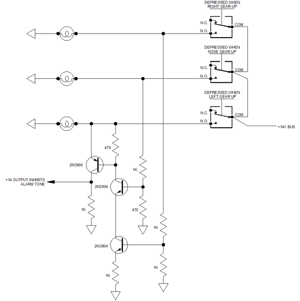

Below is the landing gear circuit,  I need a device or build one that can use the 12volts coming from the gear down and locked switches and only send 12 volts to another device[for testing a led] IF ALL 3 lights (gear down and locked)
I thought use 3 NPN transistors in series but it seems on my test, if I supply 12 volts to the base of the npn it still lights the led (leak though ?) with no voltage on anything else
I am using figure two of these examples
http://www.rason.org/Projects/transwit/transwit.htm
IDEAS ?
IDEAS ?

Then I would lose each gear indication.  This is for an audio alert device input if the gear is not down and locked (all 3)

  Okay, how about something like this:
[img]cid:part2.43A68B38.1440408D(at)gmail.com[/img]
What's wrong with using a CMOS 3 input AND gate (linked in an earlier email)?
Here's one that works on 12V, & you get 2 spare devices in the package:
http://www.ti.com/lit/ds/symlink/cd4082b.pdf
