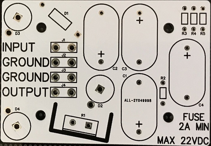

Update: Twelve PCBs have arrived. I plan to submit a Digi-Key order for components tomorrow evening. If anyone else is interested in one of these, please let me know ASAP. Again, cost will be about $35 each, plus shipping.
I"m keeping two PCBs for my own future builds and one other is spoken for, so I have nine available for any forum member who wants a complete unit or a bare board. The price for bare boards is my cost ($0.46 ea) + shipping.
I will edit this post in the future as boards are taken to track the number I have left...
Current PCB inventory: 7

Due to a circuit board layout error (which I'm blaming on stray particles from space...) the screw holes in these PCBs are a full diameter out of alignment from the mounting bosses in the enclosures. Fortunately, PCBs are cheap these days, so I've revised the board and ordered new ones. They should be here o/a 16 Dec.
If you downloaded the related archive for this project, please update your files. The PCB CAD file and Gerber files have changed, and there was a minor update to an annotation in the schematic.

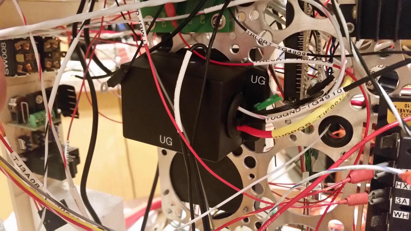

I also noted output voltage in the same ballpark as input voltage. I've already installed it and tested out Phase I which is normal battery ops on the bench with power to my GNS480 via the Deslumpifier. And it's working like a champ so far. Of course Phase II testing will come much later (hopefully this year!) when I start my engine with the GNS480 powered up.
I'm especially glad you recommended that I press forward with this design, Joe. I'm hopefully optimistic that my turbo'd version will work for the GNS480.
I've included a pic of my quasi-installed Deslumpifier (the "UG" is part of a code I use for component ID in my wire labels).
And yes, although it's 8 deg F, I'm very happy with this device! Very Happy
