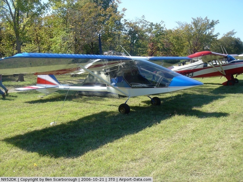

We did not build this aircraft.  The kit was started by Lisa Turner and she was written up in Sport Aviation because she had built a Pulsar prior to starting on the Kolb Mark III X.  The project was picked up by a fellow in Texas and completed in 2006, 6+ years after kit was sold.  It has the 81HP Rotax 912 with a BRS chute, strobes, encoding altimeter, intercom, Garmin GPS and Nav Com.  It has the 19 gallon aluminum tank.
In the paperwork, we found a weight and balance that showed total weight of 748 and gross weight of 1150.  There is no paperwork that we were delivered or found as to how the gross weight was set at 1150.
It is a nice looking aircraft with outstanding paint work and has only been flown about 200 hours.  We are replacing the brake tubing with new nut/ferrules and then intend on weighing it to determine the current data.  My aircraft co-owner weighs 170 and I weigh 235 so it is unlikely that we will be flying together (until I loose some weight).

I know your plane. I don't know much about the build quality but it is
beautiful. The only thing I remember about it was that it had a too small
rudder trim tab. The owner had bent the tab 90+ degrees as a attempt to get
sufficient trim. I have photos of it from a Kolb Homecoming and Monument
Valley. I was going to attach them but they are large and I would have been
yelled at. If you want them I will send them to you direct.

748 pounds seems a bit high. My VW powered MKIIIC weighs 588 pounds. My plane is fully enclosed, it has a VW it has a bunch of things that make it heavier but I worked very hard to make it as light as possible. Most of these things you can do now to make your plane lighter. My hard and fast rule was if it didn't NEED to be on my plane it got removed. There are thousands of things. Like, there is a recoil start guide ring and starter rope pulley mount, cut them off. Never use washers to fix a bolt that is too long. never have bolt showing more than 1 1/2 threads. I also changed to a lithium FE starting battery that weighs about one pound. Again there are thousand of things that will make your plane lighter and fly better but never ever make it weaker or less safe.
As for the gross weight it was and still is 1000 lbs. Yes there is considerable margen for being slammed around in rough air for thousands of hours. I added a few things to the wings to strengthen the outer ribs and added jury struts. I have increased my gross weight to 1050 pounds and some have gone to as much as 1200 pounds but is that safe? As the builder I'm comfortable with 1050 lbs and have flown in smooth air and being gentle on the controls with close to 1200 lbs but on a regular basis no way. How well was yours built? Do you know? It really isn't worth gambling a love one's life.
Rick Neilsen
