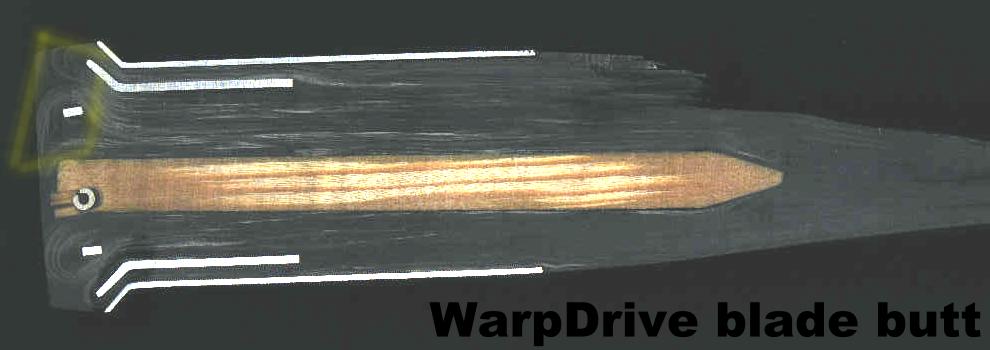

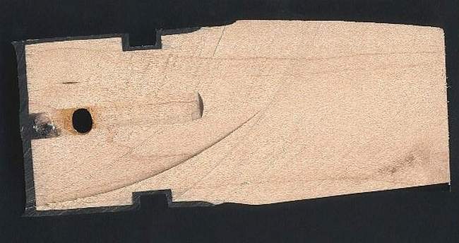

Hi Rick N/Kolbers:
Can you cite me some examples of Warp Drive props causing gear box problems/failures on B or C gear boxes?  I personally have not heard of any.  Guess I could call Daryl at Warp Drive and get his input.
I put a couple hundred hours on a C gear box, Warp Drive 3 blade, and 582 on my MKIII.  Did OK.  No problems.
Put about 50 hours on a 3 blade GSC wooden prop with inlaid urethane leading edges.  For some reason, which I could never determine, the GSC failed, collecting all three blades on the tail boom.  That one cost a lot of work replacing the tail boom which was knocked about 5 degrees out of column.  Also slung the starter out of the bell housing.  The mounting bolts were still in the engine case.  In addition, slung the carbs out of their sockets.
I have attached a couple photos of a GSC and a Warp Drive blade grip.  Not a whole lot keeping the GSC from slinging a blade.  Look closely and you can see the individual carbon fibers which loop around a steel ring.  We dissected these two grips to see how they were made.  The Warp Drive was on a friend's RANs S-12 which got away from him when he cranked it while standing outside the aircraft.  Had been working on carbs and forgot the throttle was wide open.  There were no wings on the aircraft powered by a 912.  The RANs went about a quarter mile when it hit a berm and launched skyward through a patch of planted pine trees, truck diameter about a foot.  The Warp Drive blade cut halfway through the trunk before it broke.  I have never seen how any of the other brands of popular props are constructed.
I have flown Kolb Factory aircraft with IVO props on two and four stroke engines.  They performed ok in the traffic pattern, but don't know how they would do on a long cross country.  I do know that they are not very durable.
Kolb aircraft, being pushers, are eventually going to have something fall off the engine or airframe.  When it does, it is likely going through the prop.

No examples. Just discussions from the Kolb group about the mass of a prop
that some of the rotax gear boxes can handle. No doubt Warp Drive makes a
great prop. Props are a bit like religion, easy to offend someone that owns
one.

Hi Rick N/Kolbers:
