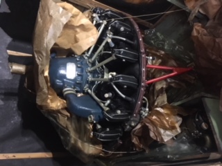

I am getting ready to install a new (zero time Chinese) engine. What are people using for engine slings. And any words of wisdom on install and run
in.
Thanks Bob

Wow ... you are lucky to have a zero timed engine ... I would suggest you fully
Depreserve it while its sitting there - oil in Carb , check magnetos clear and correctly put together internally / cigar etc ( take caps off) hot oil into front and rear crankcases , cylinders etc ..check all the screens , check the timing order is 135792468 - the Chinese diagram is slightly wrong and often misrouted no 7 airline .. dress as much as you can before installation as it’s easier than working around mounting frames etc .check the lower intake has the flattened section - or throttle won’t work, check baffles have holes in correct spot for controls blast tubes etc ... much easier to do on stand than airframe .. a bunch of other things might crop up but looks great !
