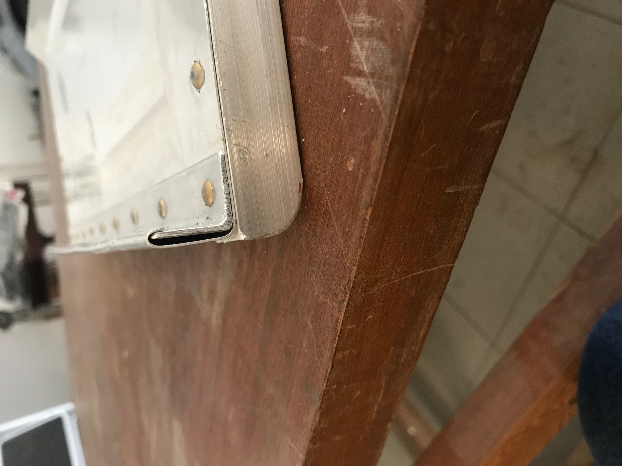

Guys
As you know, the rear seats seat backs have reinforcement angles in all 4 edges, 2 vertically (thicker) and 2 horizontally (thinner), and it is clear that these 4 angles are the seat backs structure.
But in the upper horizontal edge, the corrugated aluminium sheet also has a tab that goes backwards (pointing to the baggage compartment), with a tip slightly bend, and this tab goes over the upper angle.
I don’t understand what is this tab for.
The problem is that I am now beginning to upholster the seat backs, and it looks convenient to eliminate this tab.
Does anybody know what is this tab for?
Is there any problem to eliminate this tab?
Carlos

sportav8r(at)gmail.com
PostPosted: Fri Dec 08, 2017 5:33 pm    Post subject: Rear seats seatbacks Reply with quote
A darned good question I've had since i built my -6A twenty years ago.  It's done the exact same way.
My hunch is it's to finish the edge which would otherwise be wavy between the rivets, and to add a tiny bit of shear web in addition to the angle stock, to make it less flimsy.  I bet it's a complete non-issue, for the loads the seat backs see in use.

Greg McFarlane
Joined: 12 Apr 2012
Posts: 58
Location: Albany Western Australia
PostPosted: Sat Dec 09, 2017 1:50 am    Post subject: Re: Rear seats seatbacks Reply with quote
Some of the after market seat makers use that angled overhang to secure the seat cover, a flap of material goes over the top and is usually secured underneath by self adhesive valcro. Gives a nice finished look to the seat back cause it carries the fabric or whatever right over the back and out of sight. Also on the RV6 and maybe others there was a strip the slot would fit into and stop the seat backs flopping forward, most builders ( that I know) not saying it’s the right thing to do, didn’t fit that strip cause sometimes it’s handy to be able to pull the seat back forward a bit to gain access to the baggage compartment. Probably the seat back design has continued cause it’s just a standard part interchangable through the models . Cheers from Western Australia

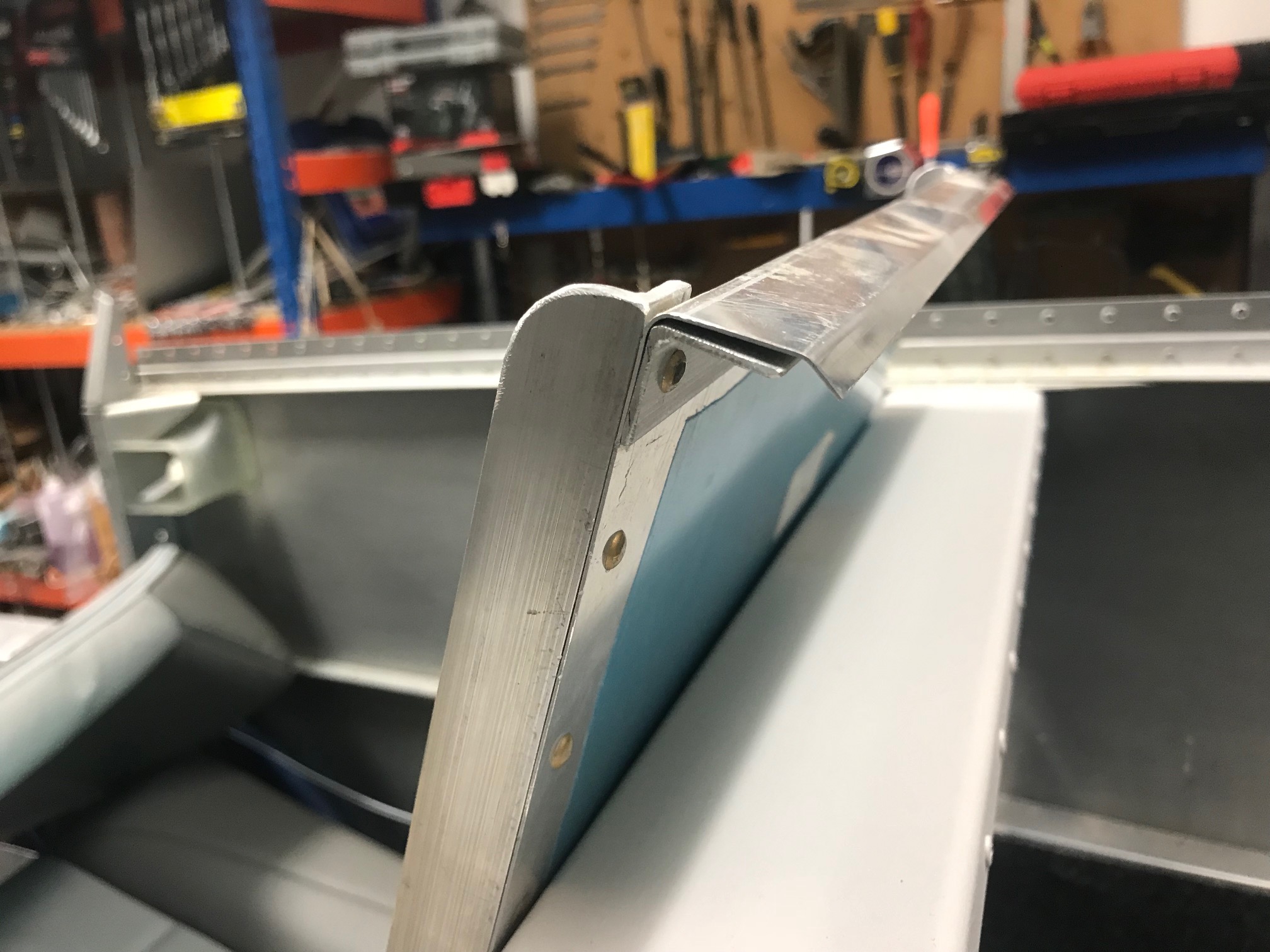

trigo(at)mail.telepac.pt
PostPosted: Sun Dec 10, 2017 9:02 am    Post subject: Rear seats seatbacks Reply with quote
This is what I did
[img]cid:6F47482E-E08B-4636-8F83-0FAF1A9362A5[/img]
I didn’t cut the tab, but I bent it around the angle.
Afterwards, I covered it with the  leather I glued over the front of the backrest
Carlos
