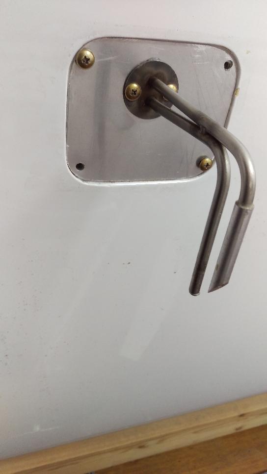

If anyone is still interested in this I mounted my AOA on the wing inspection cover.  Seems to work fine.
Will

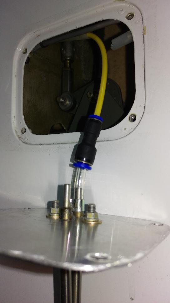

Will
Hi Will,
Yes I am very interested,as I have also fitted my AOA the same as you. I hesitated to post about it here, as my aircraft has not yet flown, but your post have given me confidence that it should be OK. I have submitted and am awaiting approval of a MOD for this method of attachment in the UK. I had originally attached the probe to the perspex cover, but the LAA requested I use an metal cover.

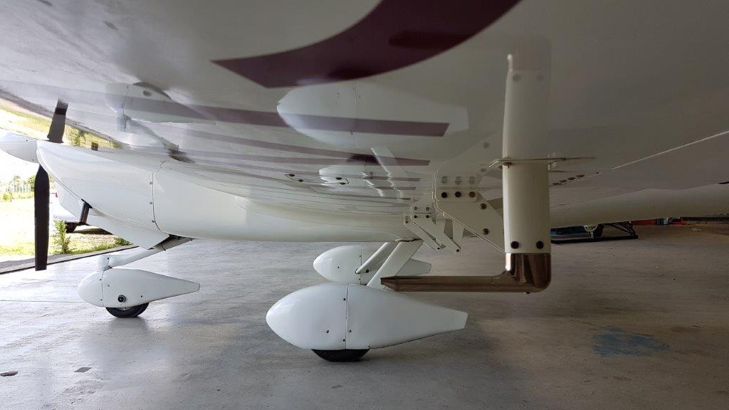

wdaniell.longport(at)gmai
PostPosted: Thu Dec 07, 2017 5:11 am    Post subject: Dynon Pitot/AOA Reply with quote
Bob....
I used a fiberglass cover and made a layup "mast". The tas vs indicated is spot on so you shouldn't have an issue.
I'll happily send you fotos.

Martin, I was fortunate in that the original builder had run plastic conduit through the wing, with wiring for navigation lights, that I don't need, so I cut into this conduit ( as can be seen in the photo), and run 4mm pneumatic tubing through this. You can also see I converted this tubing back to 6mm to fit the AOA probe.
Bob Dawson

PostPosted: Fri Dec 08, 2017 8:46 am    Post subject: Dynon Pitot/AOA Reply with quote
Bob
Here is my website.
https://sites.google.com/site/europaconstructionwd/
Navigate to "construction photos/dynon" for pics of pitot aoa mast.
Will
