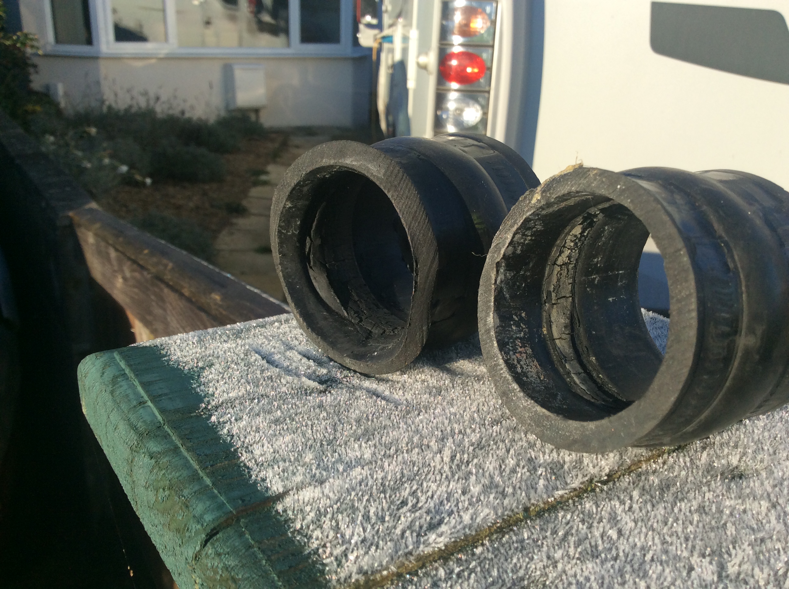

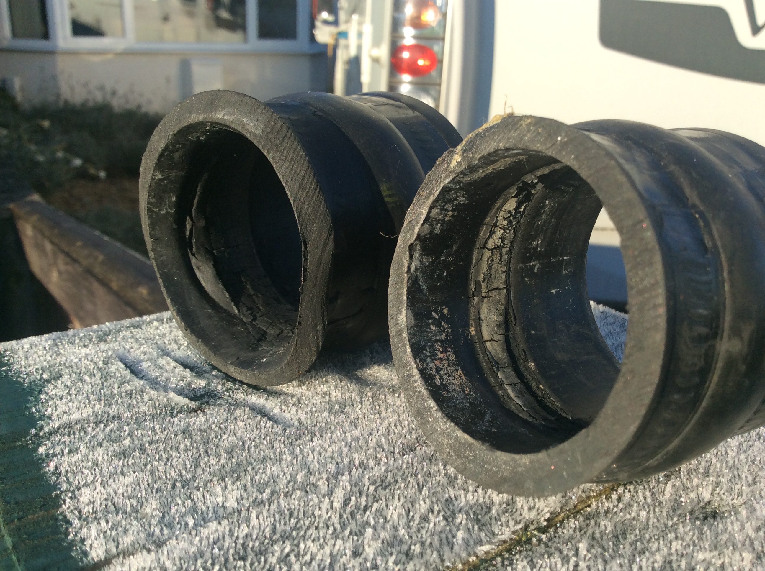

A picture of two section of original pipe from my aircraft, looked fine on the outside but definitely breaking up on the inside,
the amount of rubber actually exposed to the fuel was very small on my installation,
