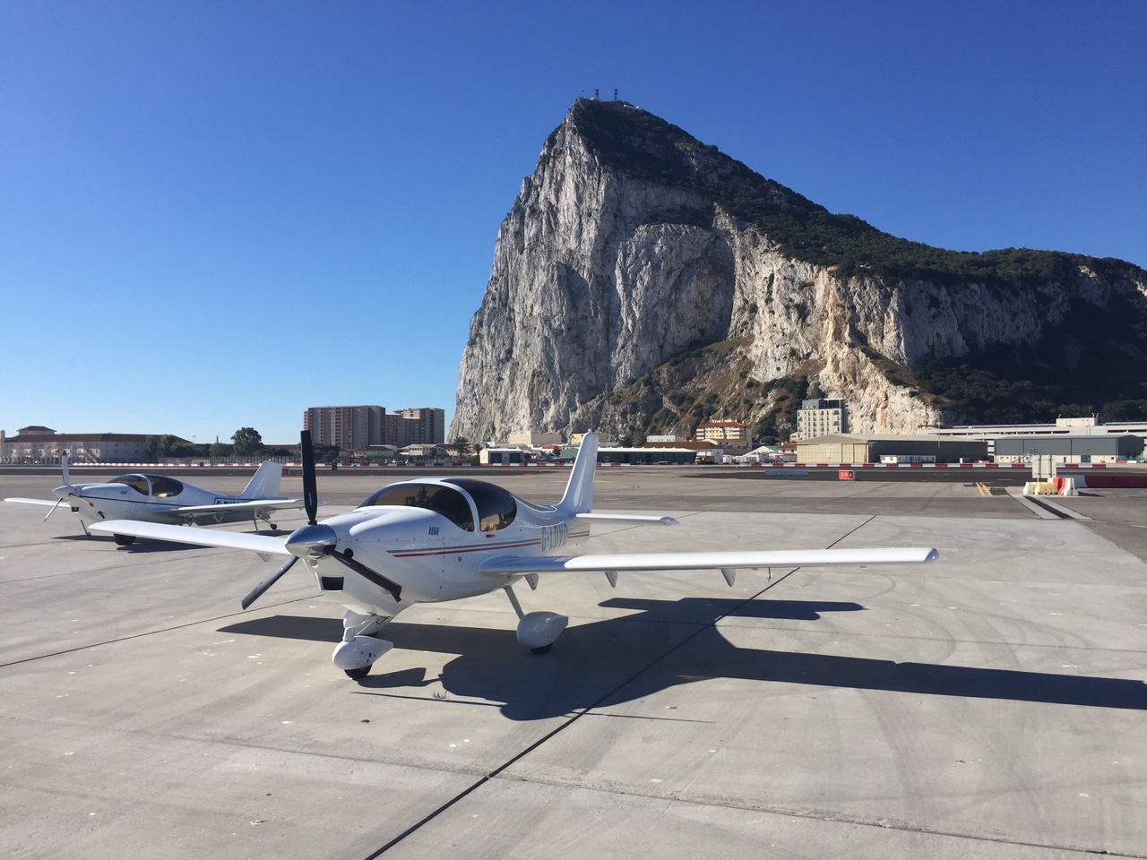

PostPosted: Thu Nov 23, 2017 2:24 pm    Post subject: Mono wheel versus Tri-gear Reply with quote
[img]cid:C96E1997-56BB-4F52-94EE-B859D3110903[/img]
Dave Park
Because it looks beautiful.
Dave G-LDVO

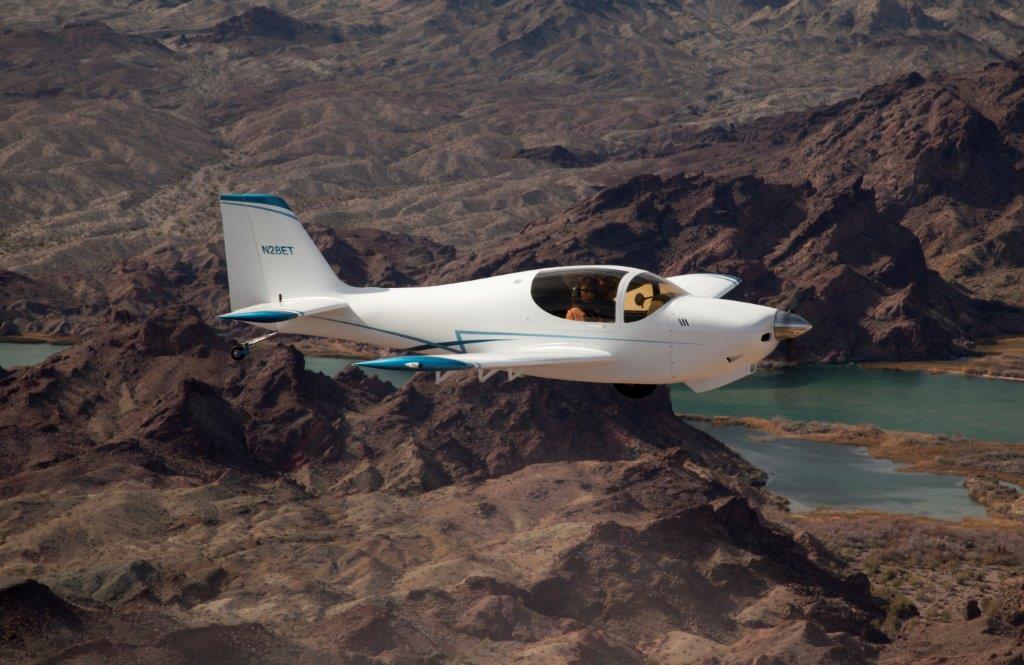

PostPosted: Fri Nov 24, 2017 7:45 pm    Post subject: Mono wheel versus Tri-gear Reply with quote
I have to echo Tim’s experience. I transitioned into the Europa Mono with a couple of hundred hours of Cessna 152 and 172 time and zero tailwheel time. I did my tailwheel transition in the Mono and got signed off after 10 hours. I had two really good instructions, Bob Lindsay, test pilot extraordinaire, and another fellow that Bob provided transition training to. As Bob was only available for a couple of days he worked with my local instructor/friend and got him up to speed after a couple of hours. I ended up with half my time with each. I also did a bit of aggressive taxiing with Kim Prout prior to the first flight which really helped as I got to explore the limits of ground handling.
The only tailwheel time I have is in my Mono; 750 hours over almost 15 years of flying. With the exception of a handful of landings on turf, I operate exclusively off of hard surfaces. Truth be told I am more nervous on turf, worried mostly about uneven surfaces. I guess for me, it really comes down to what I have more experience with. As for cross wind landings I can’t say that it is really any different in the Mono than the Cessna’s I learned in. I crab into the wind vs. the wing low technique. I have landed with 15+ mph direct cross wind without issue. Anything less than 90 degree provides for a slower ground speed and less roll out which is a plus. I do, however, try to make sure the plane is tracking straight at touchdown, although, I haven’t always been successful. The key for me, is quick jabs of the rudder pedals to keep it straight...dancing feet. If you apply constant rudder until the plane changes direction it’s too late, your off to the races.
I love my Mono. The only downside is the availability of hull insurance at what I consider a reasonable price. I have a 914 in my Mono and fly in the high teens and usually see a true airspeed of 165-171 kts depending on atmospheric conditions, burning 5.3 gal/hrs. For cross country flying that’s hard to beat. And lastly, she is a head turner. Oh, and did I mention, I love my Mono.
My two cents.
Erich Trombley
N28ET
Classic Mono 914
