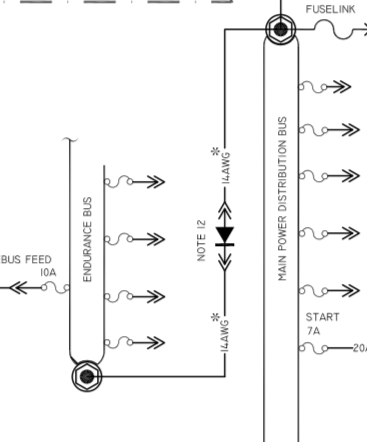

More Questions.
I took a screen shot of a small part of the Z-10/8 wiring diagram. Focus with me on the bus tie between the Main Power Bus and the Endurance Bus. The Endurance Bus gets its primary feed from the Main Power bus thru the Diode, and its typical of the diagrams in AEC.
This circuit is unprotected....no fuse, no circuit breaker, no current limiter, no fuse link. I guess thats ok., but seems abnormal. Can I have some feedback?
I argue with myself that its because we want a reliable E-bus feed. Then I see that the diagrams in AEC fuse the Alternate Feed from the Hot Battery Bus.

PostPosted: Tue Feb 06, 2018 8:05 am    Post subject: Z-13/8 inquiry Reply with quote
At 08:07 PM 2/5/2018, you wrote:
--> AeroElectric-List message posted by: "bcone1381" <bcone1964(at)gmail.com>
More Questions.
The e-bus and main bus should be located close to each
other. The wires that connect the normal feedpath diode
are short. Risk to those wires is nil. No protection
warranted.
You have two feed paths . . . loss of one is unlikely,
loss of both is exceedingly unlikely.
That's a long feeder that's not so free of risk.

Most aircraft are wired without protection on the main bus feeder.
The theory is that if the feeder shorts to sheet metal, then the sheet
metal will burn away before the feeder burns in two. The most likely
place for the feeder to short out is where it passes through the firewall.
If properly installed, then that will not happen.
As for a battery bus, adding a fuse is likely to cause a problem,
not eliminate one.
There are 3 possible locations for an ammeter: alternator output,
battery current, or aircraft load. Each location has its advantages
and disadvantages. There has been much debate about which
location is best. It is a matter of personal preference. No matter
which location is chosen, the important thing is for the pilot to
understand what the ammeter is displaying. For example, suppose
the builder installs the ammeter to measure aircraft load. The aircraft
is then sold. While on a cross country trip, the new owner notices that
the voltage is low. He is not concerned because the ammeter is showing
normal current. He does not realize that the alternator has failed and
the battery is running down. Actually an ammeter is not a necessity.
A voltmeter will tell the condition of the electrical system. If the voltage
drops much below 14, something is wrong. Do the troubleshooting on
the ground.

Stan,
It is up to the aircraft builder to decide how many and where to locate current sensors. It does not matter if the sensors are shunt or hall effect type, as long as each is compatible with its display. Some EFISs have inputs for more than one current sensor. If a display only has one input, a selector switch can choose which sensor to connect to the display. Your plan to use one hall effect sensor and one shunt sensor will work, provided that the sensors are compatible with the display(s).
Joe Gores

[quote="nuckolls.bob(at)aeroelect"]At 05:41 AM 11/15/2017, you wrote:
--> AeroElectric-List message posted by: "bcone1381" <bcone1964>
This brings up another design goal for making direct
connections to batteries. The legacy design conventions
in type certified aircraft called for always hot feeders to
be protected at no more than 5A. The idea was to limit
the battery's ability to start fires in the event of
a landing that was really hard to walk away from.
My Load Analysis looks like the electrical system will have less than 10A draw. 4.5A continuous, 9.5A when the Fuel Pump is on. So, simplification, reliability and weight reduction would demand dual buses with equal loads, and ditching the Battery Master Relay. Is that unconventional idea a bad idea? What am i not seeing?
Brooks Cone
Bearhawk Patrol Kit Build

The pilot needs a way to quickly shut off all sources of electrical power at the source.
This is important in case of smoke or fire or an imminent forced landing. A battery contactor will fulfill that need.
A battery contactor can also be shut off if the starter contactor welds itself shut.
Each circuit should have its own fuse. If a fuse blows, only one load will quit working.
Dual buses are more complicated than a single bus
Joe Gores

A battery contactor allows for easy connection to a battery charger, whereby the battery charging current is limited to the battery, without powering the bus/systems. It also allows for easy connection to a ground power source to power the bus/systems, without subjecting the battery to the ground power.
On Fri, Jul 19, 2019 at 11:37 AM user9253 <fransew(at)gmail.com (fransew(at)gmail.com)> wrote:
