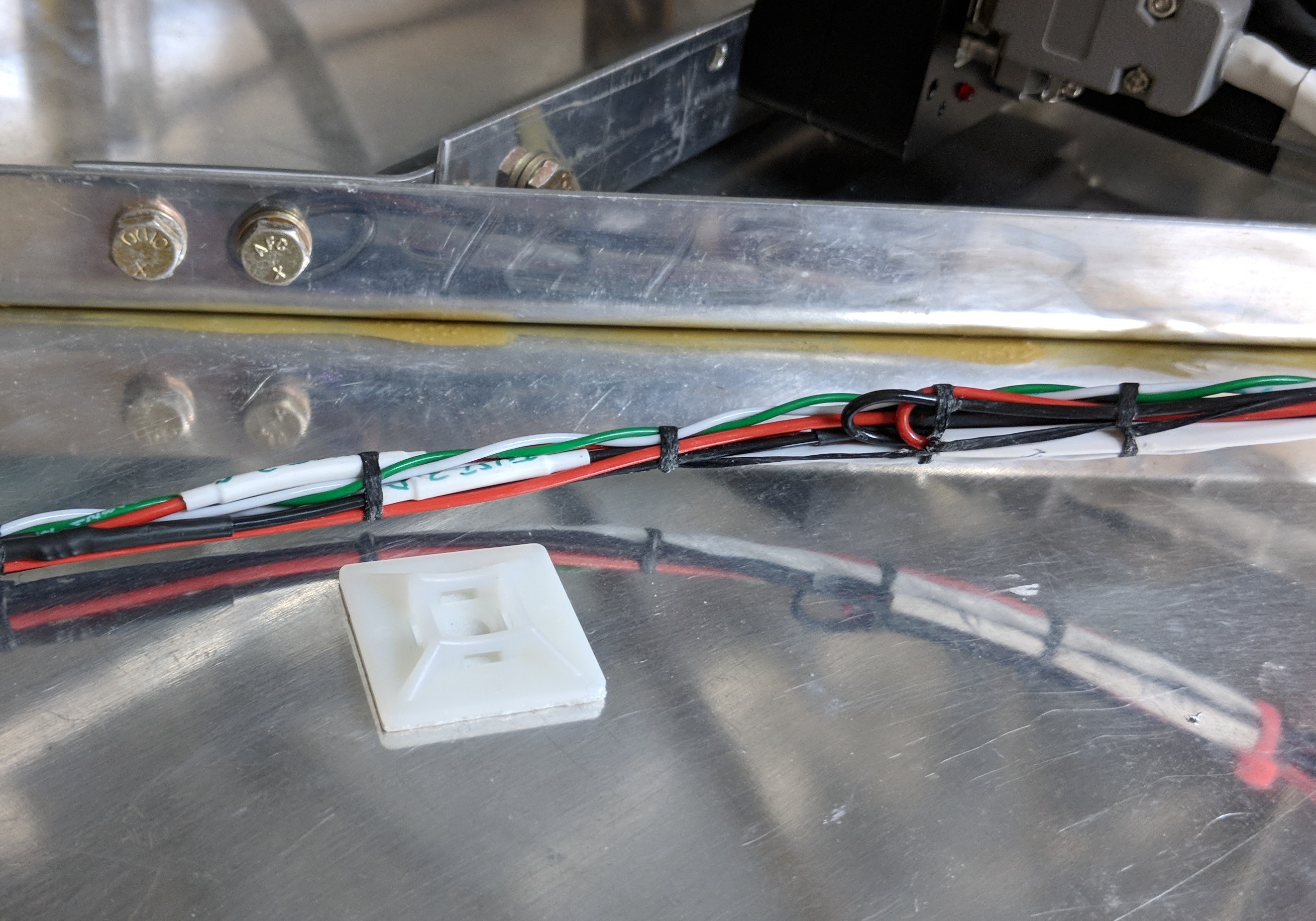

Folks,
Is there any reason why I should not use one of these anchors with the double stick foam in a position such as this?
-- Art Z.

Hi Art;
I have tried these (or something like them). The ones I tried had the adhesive already applied. Some of them came unstuck after a while. If there is a way to put a small rivet through the center, I would do it.
Cheers! Stu.

The main reason not to use them is, like Stu said, they come unstuck after time. If you must use them, clean the aluminum with acetone first.

Aaahh, sticky-back zip-tie anchors, love 'em & hate 'em. I use them at work often. Sometimes they hold with a permanent bond and are very difficult to remove and often they do not hold at all. Over all, they do work well if you have a clean surface and apply in warm environment. But don't count on it.

Or remove the adhesive and use JB Weld.

If you use just the sticky back foam mounting, any constant load, even small, will eventually pull free. As suggested by a previous post, I just scrape off the foam backing, roughen the surface with coarse sandpaper and mount the pads with JB Weld. It takes a few minutes but you’ll only do it once.

I've been using a dab of "shoe glue" right on the anchors without removing their adhesive. Seems to work. Shoe glue is tough stuff but can be removed if needed unlike JB Weld.

I suppose that I could use a squirt of RTV, too. In the spots that I am considering, there are only a few wires and there will be no significant force pulling on the mount.
Thanks for the feedback, folks.

It really isn't the amount of force that will do them in but the changes in temperature, vibration, and TIME. Some may hold for a while but if you really want them to stay, remove the foam stick tape and bond them with adhesive. I have them installed throughout the inside of my plane and all have been bonded in place. Have tried to remove a couple of them and they are in place permanently. It takes maybe a minute extra per but well worth the effort in the long run, especially if they are in tight places that are hard to get to later on.

Sho Goo, like its industrial cousin E6000 was
the adhesive of choice for crafting and installing
bond studs to surfaces without drilling holes.
http://tinyurl.com/ydasnwk9
http://tinyurl.com/j2gxbqy
Early studies for suitable adhesives included
JB weld but while it does get a good grip
on things, it's not as compliant nor
does it adhere to slick and/or plastic
surfaces as the E6000. My adhesive of
choice would be the E6000.
3M does produce VHB (very high bond) mounting
tapes that are quite strong
http://tinyurl.com/ydfql26k
Run some tests with any alternative adhesive.
Bond the part down. Wait 24 hours and then
pull it off. What breaks first and how
hard was it to get it off.
Generally speaking, bonded on fasteners
should be used only for non-structural,
low risk security on wire bundles, coax
feeders, perhaps NylaFlo pitot or static
pressure lines.

That's exactly the situation I have. There are a few places where I want to secure a small wire bundle and the most convenient thing to attach it to is the .025 aluminum skin of the plane. There are also a couple of places where I want to tie up a single coax and there is no rigid structure.

At 01:11 PM 11/15/2017, you wrote:
| Quote: | Bob,
That's exactly the situation I have. There are a few places where I want to secure a small wire bundle and the most convenient thing to attach it to is the .025 aluminum skin of the plane. There are also a couple of places where I want to tie up a single coax and there is no rigid structure. |
yup . . . that's what the bond studs are all
about. We used them in production on a number
of models at Beech. But these were "qualified"
parts that were two orders of magnitude more
expensive than a McMaster-Carr stud stuck to
the aircraft with E6000.
I've got no heartburn with the Nylon cable mounts.
If one were to seek out the epitome of this
methodology you would look for products like this:
6/6 black nylon, very high bond adhesive pads.
I've not been able to find anyone offering less
than bags of 100. Here's one offering from
Allied Electronics.
http://tinyurl.com/y7qjqy2m
Digikey has them too but higher priced
and lots of 100 minimum
http://tinyurl.com/y7rel4q4
Perhaps a few builders could team up and
buy a bag to split.
