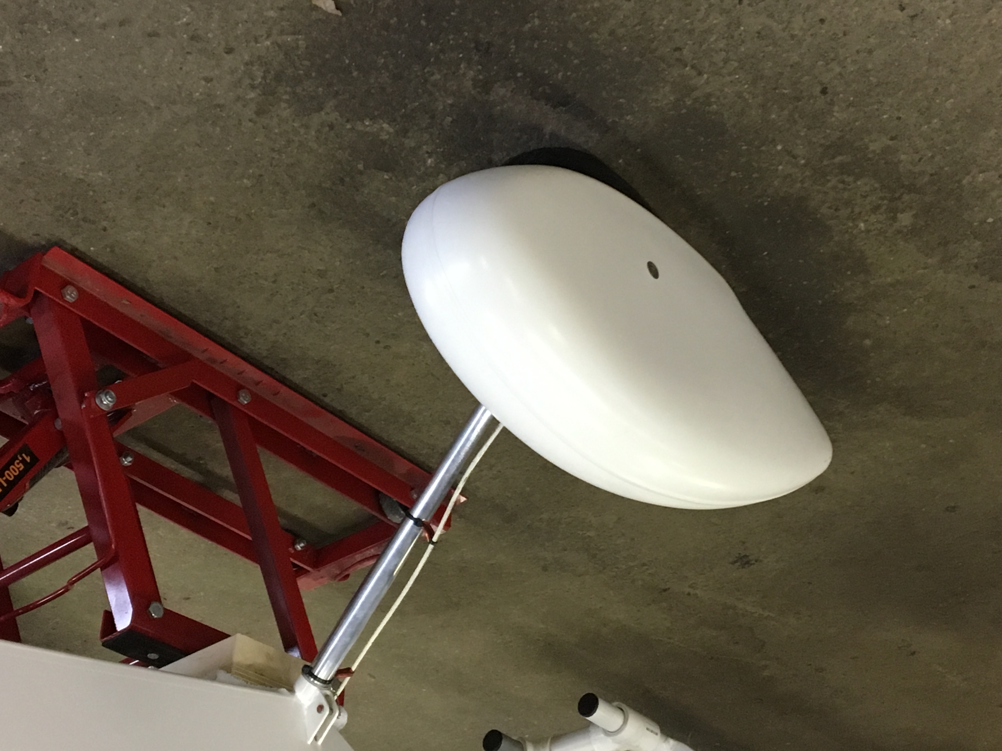

Here is picture of a slmple plastic tie with plastic tubing standoff system. Works equally as well for hydraulic tubing and mechanical cables and wiring looms.
George H.

I am using the black max brakes on my FS ll and decided that a 1/4 " aluminum tube "conduit" was good protection for the plastic hydraulic line as it ran down the top of the gear leg. The conduit extends thru the fuselage cage fabric and the lower end has a slight horizontal bend secured by a band using one of the axle bolts.
Double Zip ties at the top and half way down.

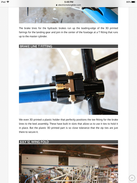

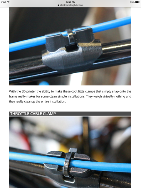

check out some of the 100+ 3D printed items from Rainbow Aviation / EMG-6 project.
they have nice looking brake line attachments & a T-fitting attachment also.

examples of 3D printed items.

nicely done thank you!
