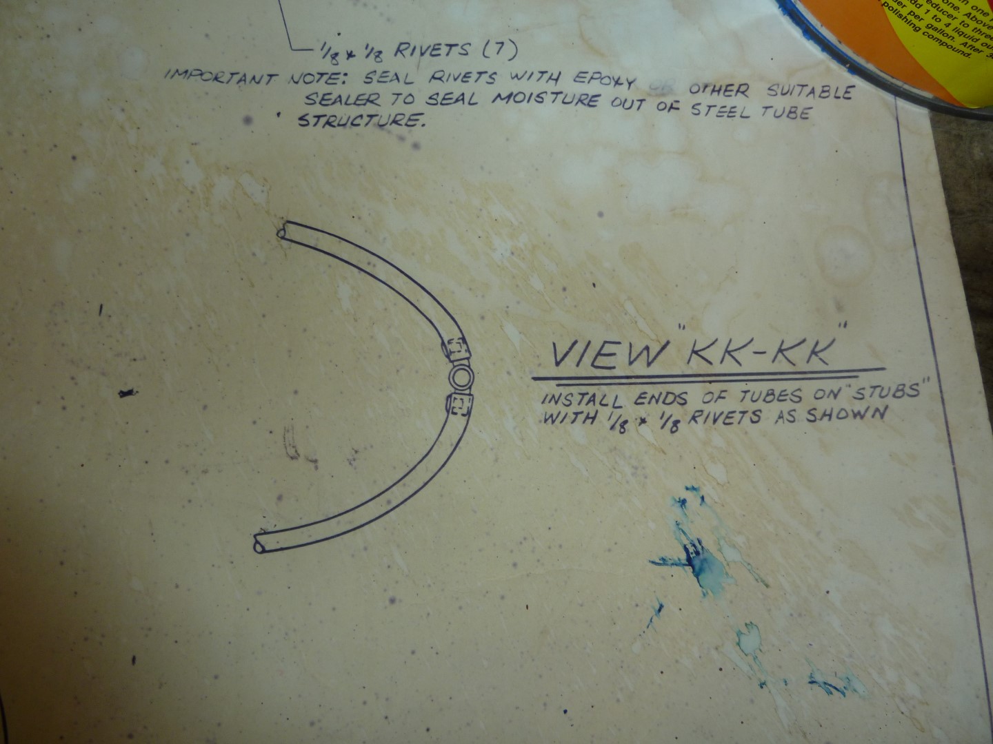

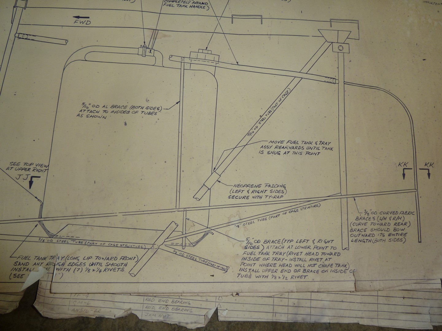

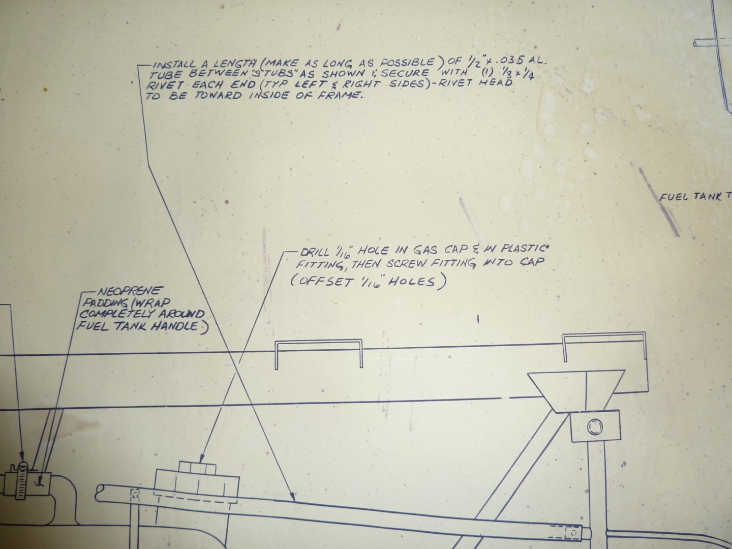

Here are some from the one blueprint page of an original Firestar. While obviously not the same, they do show the concept, so perhaps you can improvise from here. I resized these up to the biggest possible without being overwhelming. Hope this helps.

Richard, Thanks for the input. I'll put these images in my reference binder and they will help. Have you ever seen any documentation with a top view of the same cage fairings? Mark

The blueprints I have (which seem to be complete) don't show anything.

The second photo is a top view of one of the rear connections and only the rear connection. Still looking for more detail if available. Hoping for more. The other photos are side views with the engine mount at the top.
