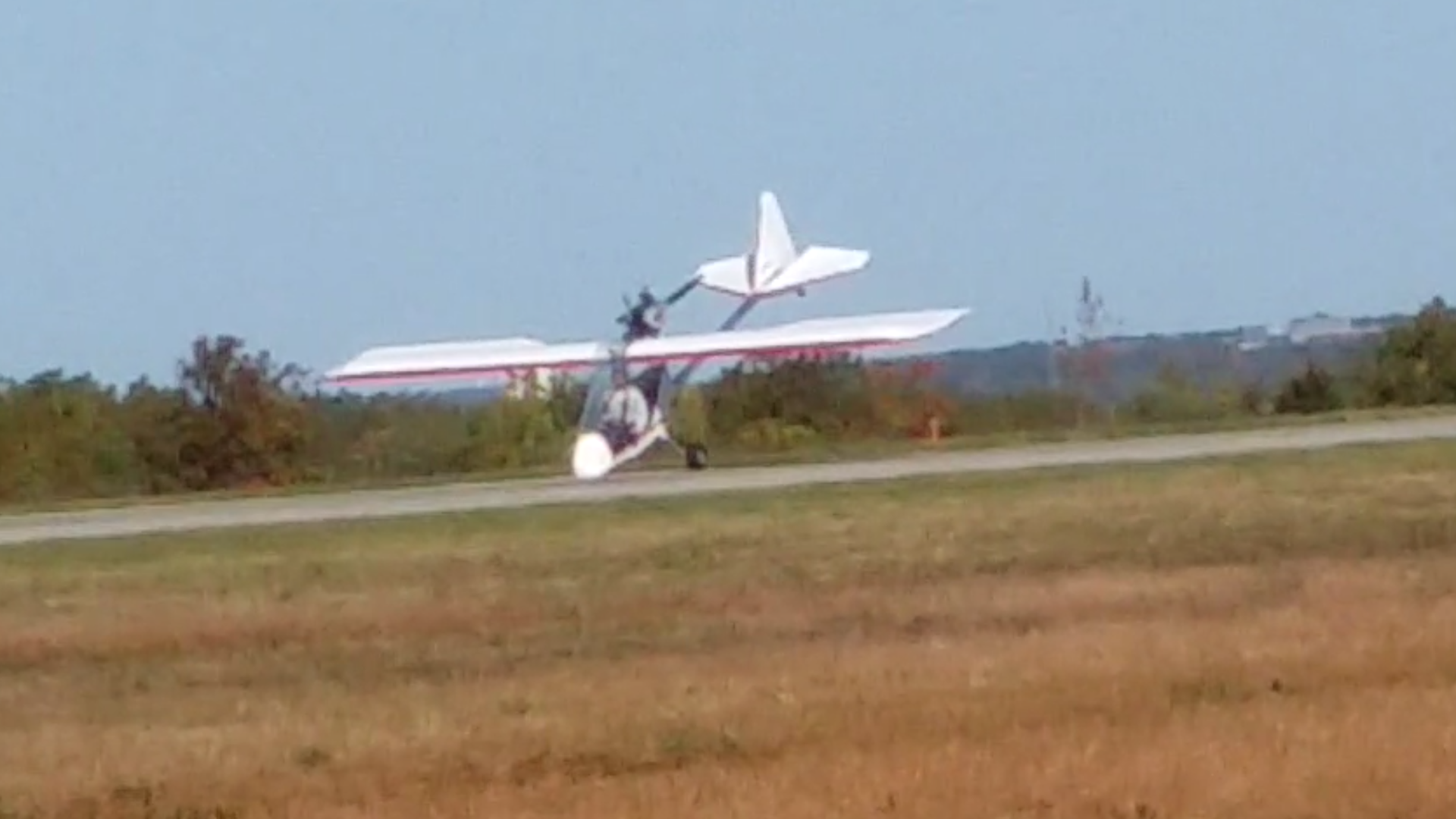

Hi Everyone.
Last weekend yielded the best weather I could have hoped for, warm,sunny and no winds to speak of. I took my FSII to nearby SFZ where from the Airport manager on down the line could not have been more friendly and welcoming. They set the stage for what was a great experience. I got things together, taxied out to the 5000' runway added power and off I went. I planned using 55mph for climbout and was amazed at how quicly it accelerated and climbed at that speed. Iflew around to get a feel for slow speed handling and found it stalled at 40mph dropping the right wing. Using flaps (yes my FSII has flaps) yeilded only slightly slower (38)stall with a more pronounced wing drop. Flaps were not used for remainder of flights. Landing approach was done at 55mph which setup a reasonable decent. Reaching around 50" I added power to arrest decent, with a flare around 10' settle to runway and BAM! right up on my nose. Rolling Eyes Lesson learned is make sure you put your size 10 heels in front of the heel brakes, not in front where comfort dictates. No real damage other than to pride and bent antena and road rash on cowl. As of yesterday I've put in 8 hrs of time with a mix of landings from dropping in and respectable. the gear may have suffer from some. Any way to straightren aluminum gear? Whats the options and possible vendors? ...Bob

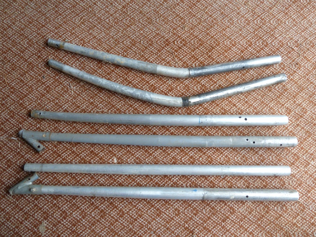

The gear can be straightened. Most people use a cheap hydraulic press (Harbor Freight) or a home made jug with a hydraulic jack. Some guys get a set of spare legs from Kolb. Others have made steel legs, but if you are still learning, the aluminum ones put less shock on the airframe in case of a goof.

Wait until Harbor Freight puts this on sale, fix it yourself.
https://www.harborfreight.com/12-ton-hydraulic-pipe-bender-62539.html
In the meanwhile, take the leg to any machine shop, they can straighten it for about $20 if it is not badly bent.
Attached is my collection of old Firestar/FSII gear legs. The top set is from the original Firestar from which we built the FF clone, and I would consider them un-straightenable. The next 3 down all have slight bends and could easily be fixed with a press in just a few minutes. The bottom one is unbent.

Bob, As Bill said, yes they can be straightened, but they will be a bit softer each time and thus easier to bend. Make some saddles out of PVC pipe to protect the leg from getting a ding when straightening and have at it with Mr. Hydraulic Press.When Travis was at Kolb he was the best at supplying answers to Kolb questions even though he didn't fly. I told him my problems with landings and his advice was to wheel it on at first rather than trying for a three point landing, When you can wheel it on consistently then start slowing it down a bit until you find the sweet spot where she just sets down on three and rolls out. It's like riding a bike; once you get it, you'll always be able to roll it right on every time. It just takes a little practice.

I've straightened the tapered steel legs from an RV-4 in a HF press using soft pine 2x4s as pads. One under the ram, and the leg resting across a pair of them. With the steel legs, the wood crushes enough to spread the point loads of the ram & support points.

  When I bought my Firestar, it came with a couple of new legs.  The ones that were on it were a little bent, so I put the new ones on.  About 1/2 an hour of taxiing on grass, and they both bent like the second one in the photo.  The previous owner had made them of 6061 (If I remember).

Pike" <thegreybaron(at)charter.net>
http://forums.matronics.com//files/p1060418_medium_140.jpg

As far as moving my brake petals,that's not a priority to me. I learned the hard way where my heels belong and comfortable taking off or landing without being in position for braking. Only feel I need them for taxiing. I will try to straighten gear when it seems to get worse. Mine is between Richards #3 & 4 pictures. I'll see how it goes. Just hoping to get more flying in before the winter sets in, then I'll make repairs / improvements.

PostPosted: Mon Oct 30, 2017 8:21 am    Post subject: First Flights Completed! Reply with quote
Yet another reason to fly off grass until comfortable in the a/c. Smile

Alaska.  We did make it the next year on Brother Jim's
gear legs.  Wink  Don't try and fly a Kolb
with 4130 legs that have not been heat treated.  They are
not springs until they have been in the oven.  Yes, and
have it done by a professional heat treating
facility.  BTW:  My tail wheel strut is
.120 wall 4130 heat treated to 48RC.  Weight is about the same as the
alum 7075 legs.  Please pardon my rambling.  I
tend to do this as I age.  Wink  john hmkIIITitus, Alabama      From: owner-kolb-list-server(at)matronics.com
improvements.
