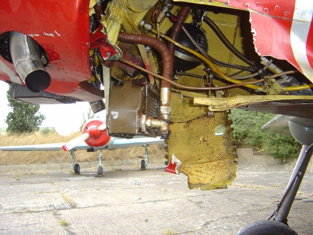

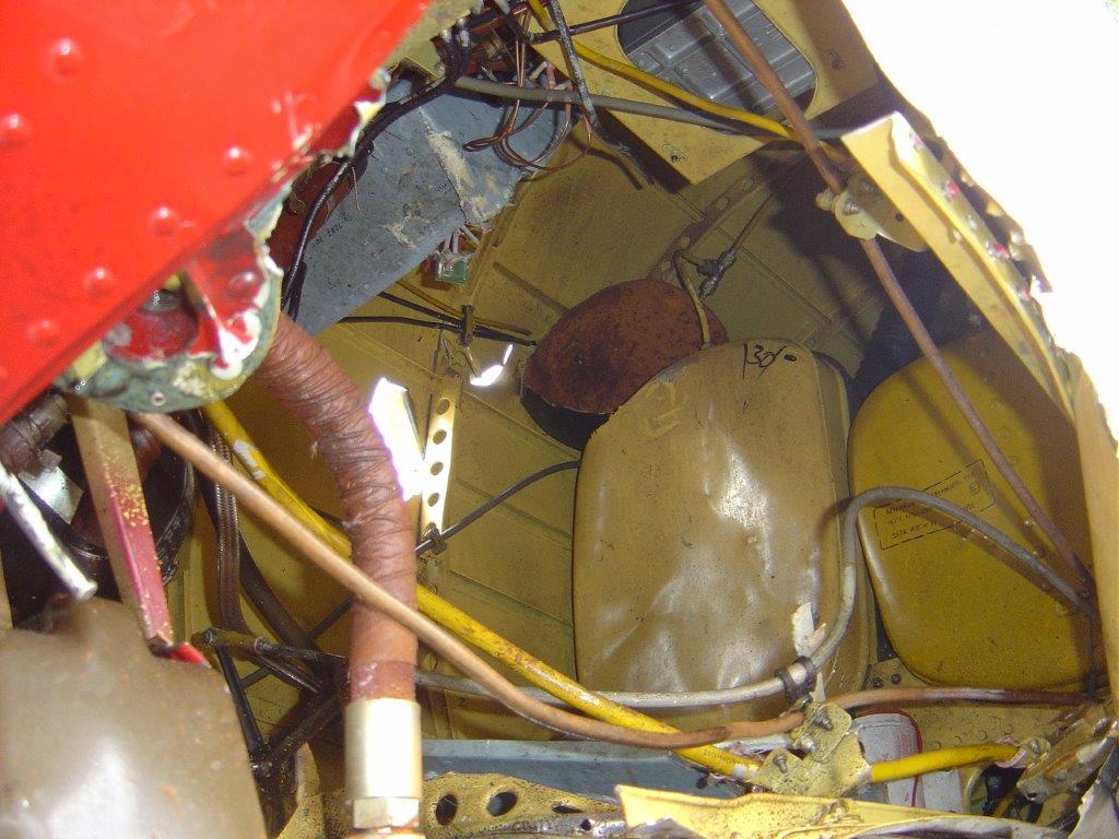

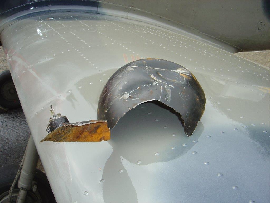

The results when an air bottle blows up! Not pretty, and potentially
disastrous.

PostPosted: Mon Sep 11, 2017 9:38 am    Post subject: Re: Ignore at your peril Reply with quote
Was this from a few years ago...or another 50 that suffered a failure?

PostPosted: Mon Sep 11, 2017 12:50 pm    Post subject: Re: Ignore at your peril Reply with quote
I expect it's this one (Yak-50, G-YAKK).
https://assets.publishing.service.gov.uk/media/5422eb4040f0b61346000069/dft_avsafety_pdf_027258.pdf

PostPosted: Tue Sep 12, 2017 12:23 pm    Post subject: Re: Ignore at your peril Reply with quote
I did mine just as a matter of course. I maintain a 5 year inspection. I found that my emergency tank was severely pitted and test house would not test it. This was a time bomb waiting to happen. I replaced my emergency bottle and main checked good. Always a good check to be done, but many ignore. Confused
