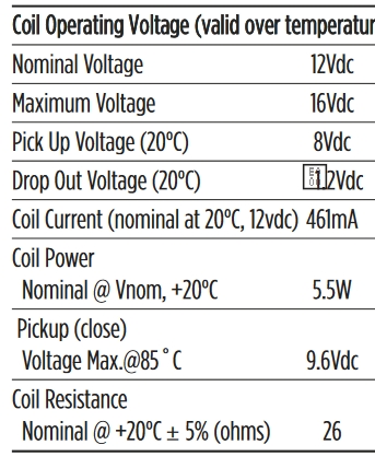

Quick question about the TE LEV100A4ANG contactors, these have two terminals marked A1 and A2, wonder if any one has used these and if there is a preference to use A1 or A2 for supply or load side? Tried calling TE support, but havent heard back from them yet.
Also, is it recommended to use the diodes with these contactors for TV suppression?

A1 and A2 are interchangeable.
Diode is suggested. The data sheet for
this product excerpts as follows:
[img]cid:7.1.0.9.0.20170907185229.0604cf28(at)aeroelectric.com.0[/img]
A 12 V across 26 ohms is .46 amps.
This tells us that unlike some products
of this genre', there is no consumption
mitigation electronics for the coil power.
Hence, a 'barefoot' solenoid winding.
Any diode will work. I like the 1N540x
series devices for their mechanical robustness.
