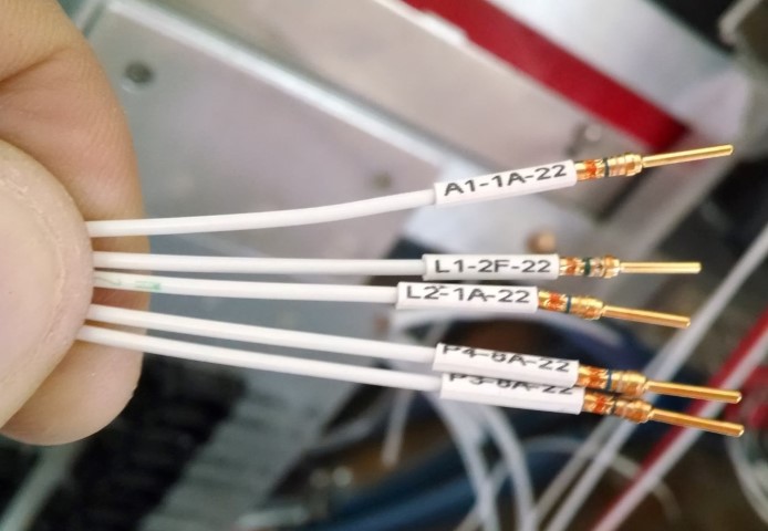

I used the Rhino 4200 to label wires down to 24awg. Works great. No fading after 4 years.
