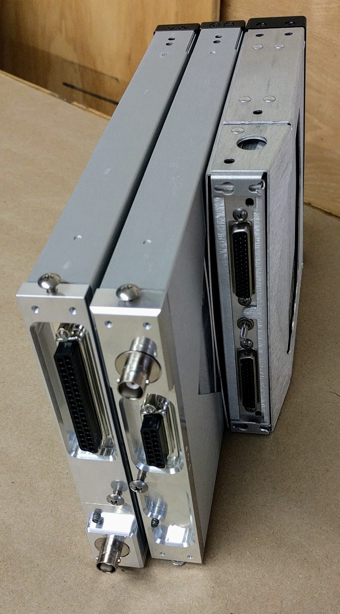

See attached photo.For the wires running between radios in my radio stack, how much service loop do I need, 12"-ish? Less? Never having had to work behind the panel of a plane, I could use your thoughts.

When you have to, you're not going to like it. Sit in the cockpit & try
to imagine what you'll do when you're trying to troubleshoot the one in
the middle of the stack.
I left enough service loop(s) length to sit the panel on the spar (low
wing), face down.
Charlie

Did a design study with some guys at Lear
to produce one of Leon Davis's 'mini bonanzas'
a DA5 if memory serves.
We designed a radio module that would hold all
the radios that was held into the panel with
6 screws. Take out those screws and all
the radios came out together with the interface
harness terminated in a D-sub. One could take
the whole thing to the bench . . . or use an
extension harness to operate the radios out
of the panel.
This approach let us take proposals from various
suppliers or hardware to build the complete
stack with only the airplane interface wiring
dangling off the back.
Installation time on the assembly line was under
40 minutes for the whole avionics package.

Those are interesting ideas.... I had not considered the idea that I might remove the whole radio stack. And reading Charlie's message, I also thought of the situation where I want to add/remove a pin in one of the audio panel connectors. That would sure as heck be easier if I could pull the connector well clear of the panel.
What do you suggest I do about the shielded wires for headsets? Connect them directly to the D-sub connectors for the audio panel? Or add another connector near the audio panel so that the whole harness can be assembled outside the plane?

Art, I'll send some pictures later but on my BD-4 I have panels in the side of the fuselage forward of the instrument panel so that I can get at the back of the panel very easily and quickly. Also my panel is in three pieces: Flight instruments, radios, and right side. The flight instrument side has a small amount of service loop but if I have to take the whole panel out I usually undo from the back side first. The radio stack is all trays so no service loops.
