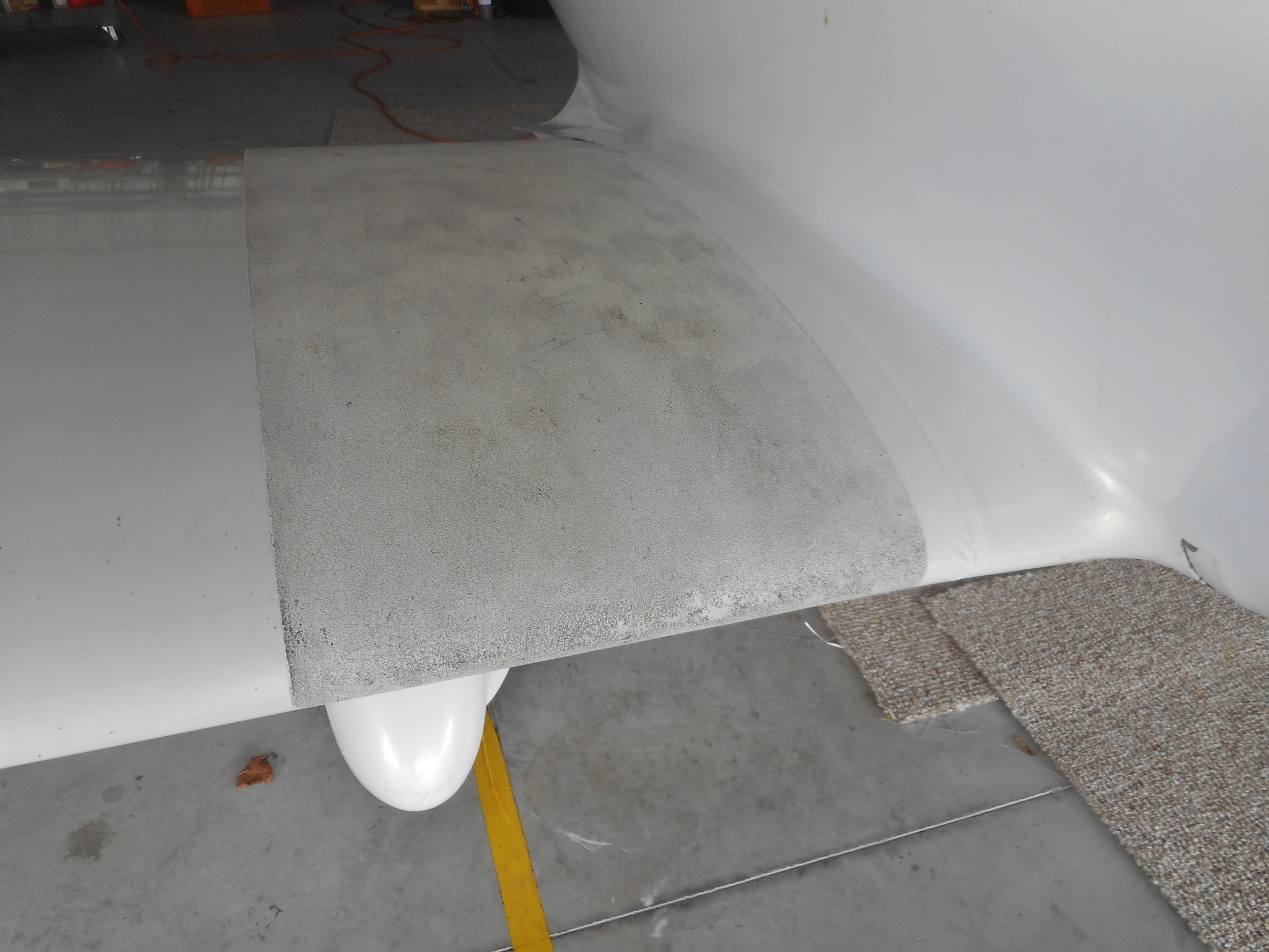

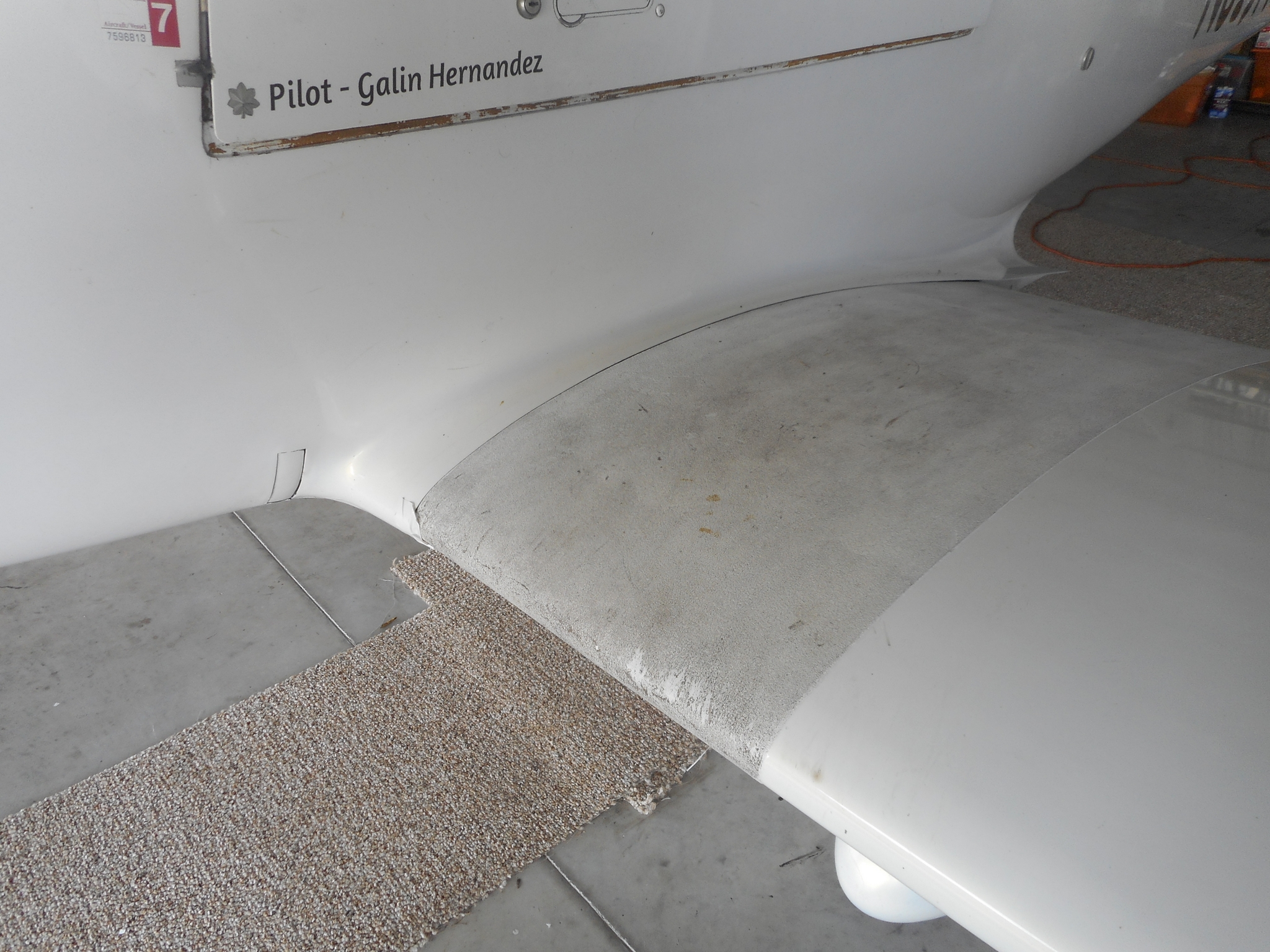

PostPosted: Tue Aug 29, 2017 2:27 pm    Post subject: Wing walk Reply with quote
Here are pics of the "wing walk" area where you can see some of the abuse it has taken. The wing area underneath is in excellent condition.

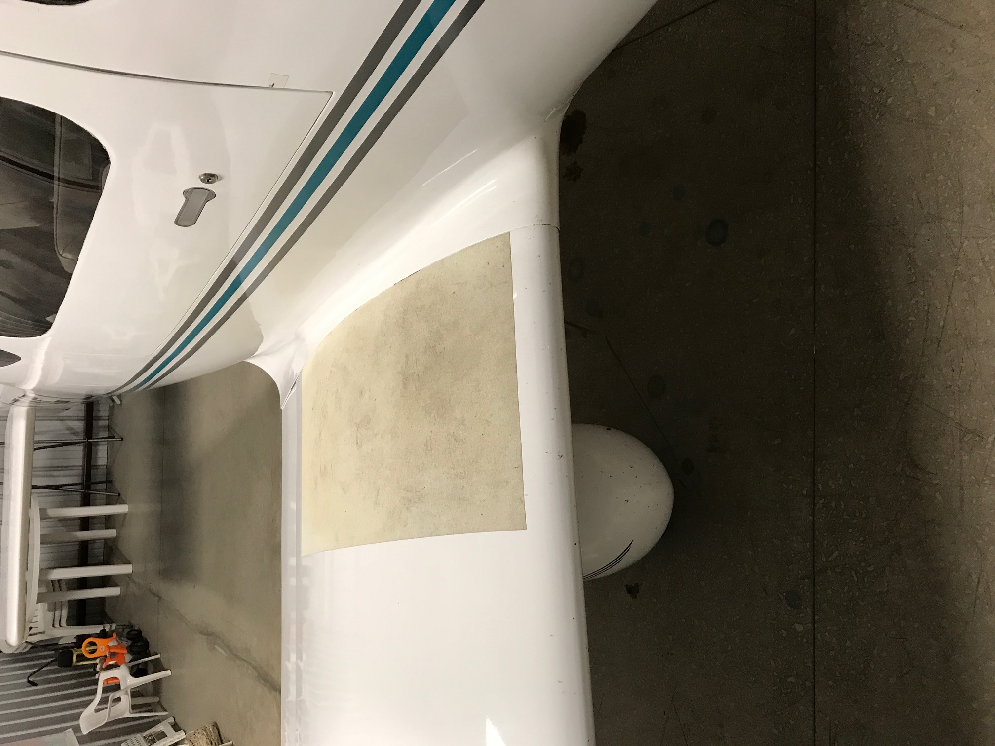

PostPosted: Tue Aug 29, 2017 5:35 pm    Post subject: Wing walk Reply with quote
Hi Bob, I used the white wing walk from Spruce. I trimmed it to about 17 by
36 and started it about 2 inches back from the leading edge. This leaves
about 5 inches of the aft wing not covered as I didn't think it needed it. I
used some small pieces on the brake pedals to prevent slipping. I'll try
attaching a photo of the walk. FYI, this is a two person job to apply so be
sweet to your wife in the next few days. Also it will have some bubbles to
roll out. I used a large deep socket as a roller and it took the finish off
the socket and the skin off my hand as I smoothed it out. Get a short piece
of pipe to use as a roller. This stuff just attracts dirt. I found foamy
bath cleaner and a bristle brush to work best to clean it. Happy building.

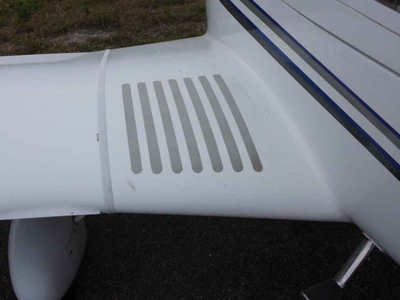

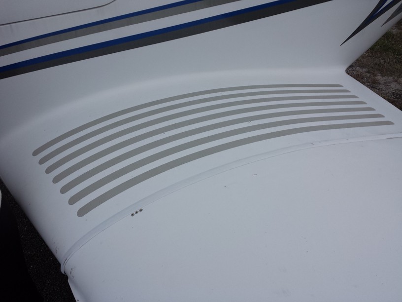

On my older DA-40 the wing walk is about 18" wide and light gray stick on nonskid. Newer DA-40s use 1" wide gray nonskid tape spaced about 1" apart. Attached are pictures.
www.ebay.com/itm/1-x-60-Roll-Rubberized-Anti-Slip-Safety-Tape-Non-Skid-Stair-Grip-Boat-Gray-/152673817385
You can also find transparent nonskid tape.
www.ebay.com/itm/PEVA-Anti-Slip-Non-Skid-Tape-Stair-Step-Floor-Safety-Grip-Walkways-Adhesive-/192239500174
Gray might now show the dirt as much. In any case I think this tape looks better for longer even in white. I have this in white on my boat and it looks great after years of harder use than you will see in an aircraft.
When I repaint my DA-40, I plan on using the 1" stripe method. I am not so sure this really has less drag but I think it looks better and still works great as a wing walk without adding too much heat..
I plan on doing similar to my TR-1 and TR-4.
Mark K.

I also considered the black wing walk as a first choice but
quickly considered the heat buildup as being a real problem
here in Texas summers.  White, as noted, is a dirt magnet
but should be cooler.  Where to start the wing walk on the
leading edge or back several inches was my first question
and Galin, your photo was really an eye opener.  I can
easily see that damage to the leading edge while getting
into the plane with the retractable step would be hard to
avoid.  Ed, seeing you photo of the 17 inch wide walk
confirmed my thought of 18 inches or a little less should be
sufficient but 12" is just too narrow.
about 17 by
36
This leaves
about
it needed it. I
used
I'll try
attaching
so be
sweet
bubbles to
roll out. I
off
the
short piece
of
found foamy
bath
building.
> Mark K.
> about 17 by
> 36
> This leaves
> about
> it needed it. I
> used
> I'll try
> attaching
> so be
> sweet
> bubbles to
> roll out. I
> off
> the
> short piece
> of
> found foamy
> bath
> building.
