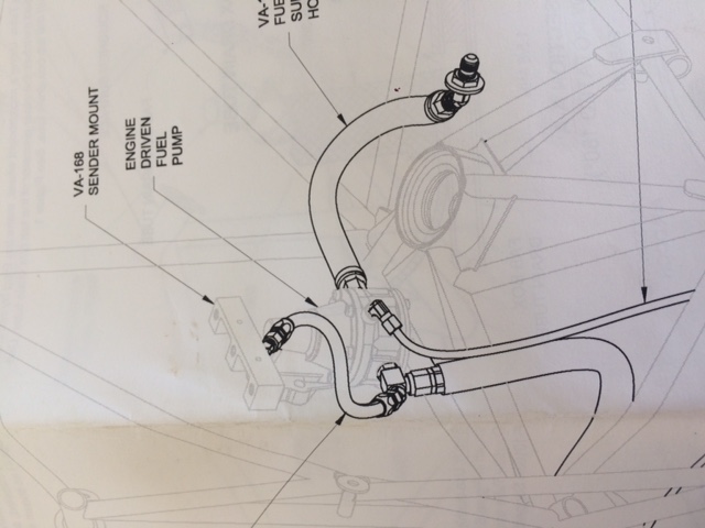

Hmm, restrictor's purpose is to prevent large flow if line fails, and
fuel pressure line is usually connected to the fuel servo, on opposite
side to the inlet screen. So the restrictor should be in between the
fuel pressure line connection on the engine end of the line going to the
fuel pressure sending unit. Is your fuel pressure line connected to a
fitting on the pump? You really want to know how much pressure is
internal in the fuel servo, not at the pump.

PostPosted: Fri Aug 11, 2017 1:22 pm    Post subject: Before the fuel pump exchange - one last question Reply with quote
Mine is installed like Vans plans suggest. Photo attached.
Coming out of the pump there is a T. One leg goes forward to the servo.
The other leg has a restrictor fitting and the hose goes on up to the firewall manifold where the pressure sensor is located.
Phil

Kelly McMullen
Joined: 16 Apr 2008
Posts: 1188
Location: Sun Lakes AZ
PostPosted: Fri Aug 11, 2017 1:33 pm    Post subject: Before the fuel pump exchange - one last question Reply with quote
That could account for some of the fluctuation. Production planes
connect at the servo. I have to keep switching mind between factory
planes I've worked on and Van's somewhat different way of doing
things.

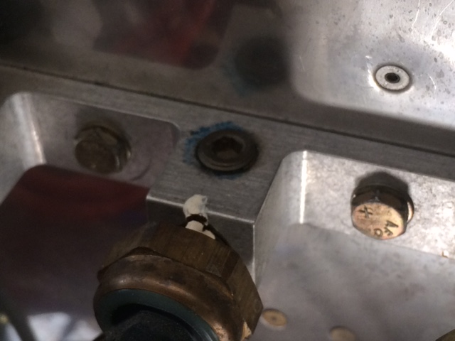

PostPosted: Fri Aug 11, 2017 1:56 pm    Post subject: Before the fuel pump exchange - one last question Reply with quote
I am up here working on it now and while safety wiring this thing, I might have found another possible source of fluctuation.... it escaped my eye until now.
Photo attached.

Tim Olson
Joined: 25 Jan 2007
Posts: 2882
PostPosted: Fri Aug 11, 2017 2:32 pm    Post subject: Before the fuel pump exchange - one last question Reply with quote
There you go...an air bubble up high by the sensor. That could be it!
