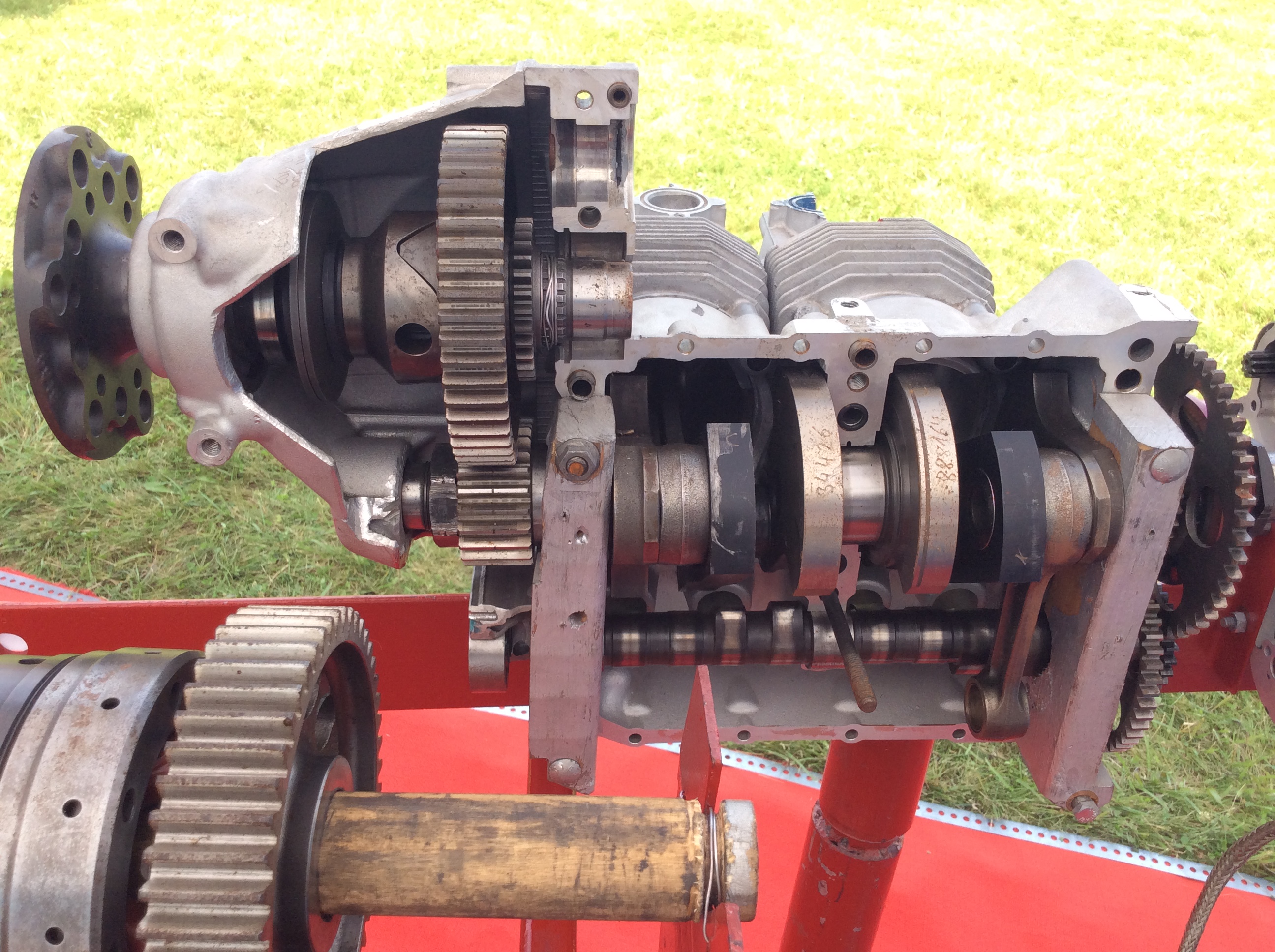

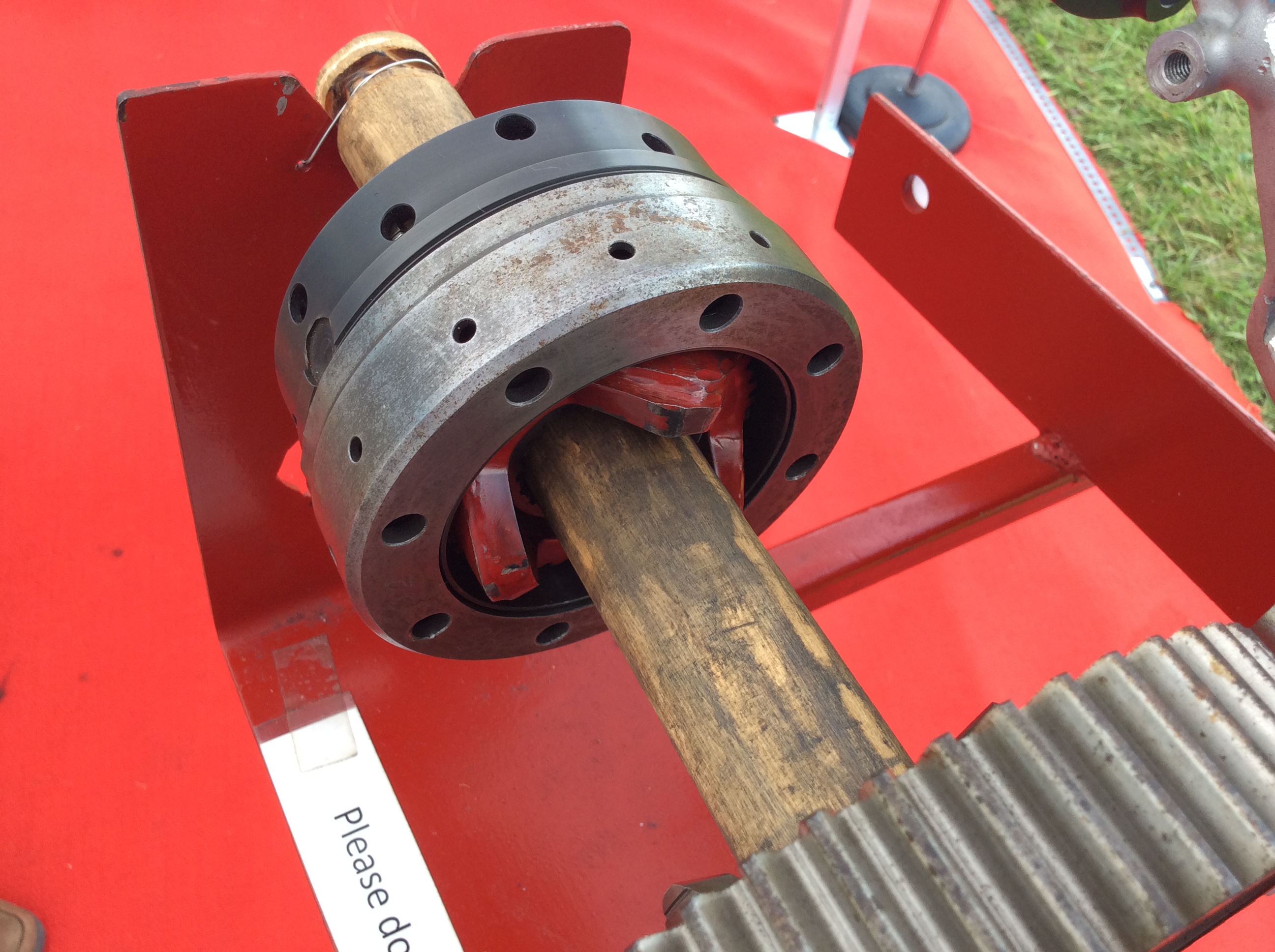

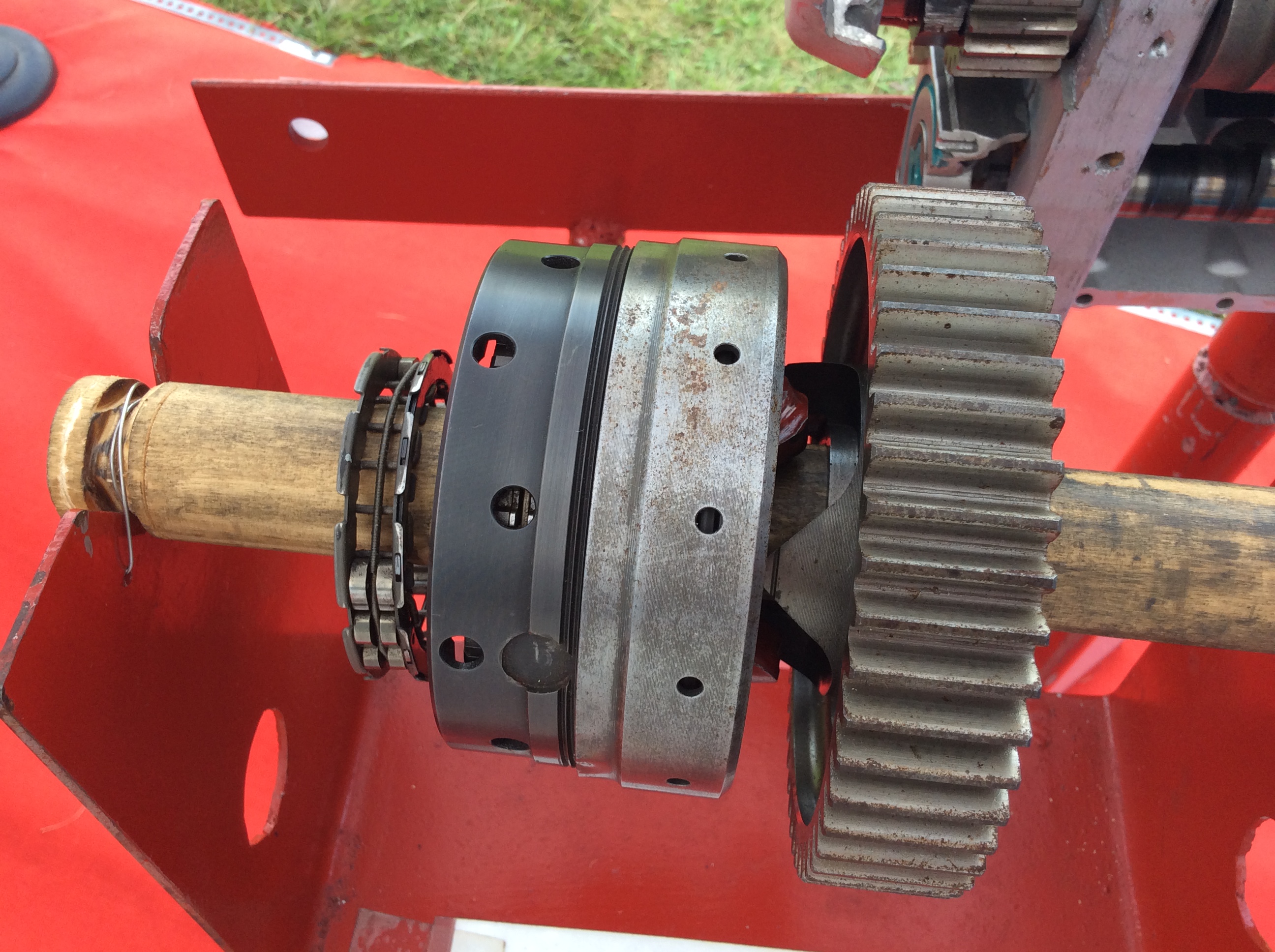

1- The only feasible/reliable geared engine I saw at the show is the Rotax 9-series with its thorough engineering to deal with the resonant issues with it's newer (since the 100hp) 30deg dog clutch and additional integrated pack-clutch, set to ~500lbs. I have attached a few cut-away pics of the gearbox of it's clever dense packaging). The auto conversions, with their solid engine cores have a weak link in the gearboxes - the simplistic rubber bushings... a design that I do not believe is adequate. The European BMW two-cyl with gearbox appears to now have some good in-service experience, but was not at the show to check out, and it's gearbox design is still unknown to me.
