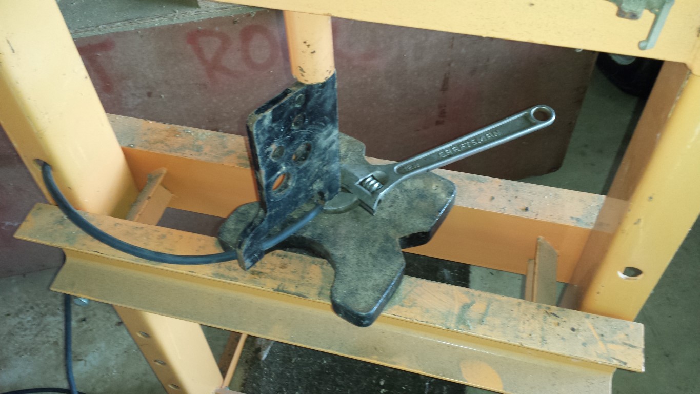

I have crimped them similar to this method but I used a piece of steel with a half-hole for the anvil
http://www.thebackshed.com/forum/printer_friendly_posts.asp?FID=4&TID=8298
Or do a google images search for “crimp large cables” and you’ll see lots of crimpers
If you have a welding supplier nearby, they can crimp those large cables. Welding cable is often used in battery runs. Very tough and flexible.

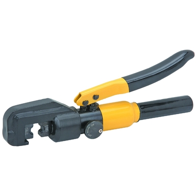

Found similar at Harbor Freight an it works great.

Hydraulic Crimp tool... I have used this tool with great results on AWG 2 and smaller cable.

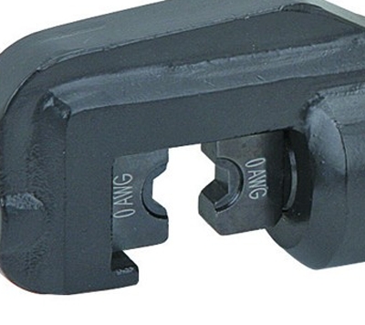

PostPosted: Tue Aug 08, 2017 7:54 am    Post subject: 2 AWG crimping tool Reply with quote
At 11:04 AM 8/7/2017, you wrote:
I think that if you do your research, that preference for crimps has more to do with unskilled labor, quick training time, and quicker operations in a production environment. Crimping is without a doubt, much faster than solder, even if you have the skillset to do good soldering. Problem is, purchasing expensive tools for basically 'one-off' jobs. If you've got access to a press, or even a good shop vice, you could do this...
I bought one of these Harbor Freight
tools a few years back . . . lots of
capability for the bux. Took it back
a couple weeks later . . .
[img]cid:.0[/img]
It seems that the designers for this
tool had a poor knowledge of the die
openings appropriate to installation
of terminals on wire.
[img]cid:.1[/img]
As you can see in this excerpt, the die set
is labeled "0 AWG" . . . when in fact, the
hex opening in the closed jaws MIGHT just admit
the stranding on 2AWG wire and it's certainly
way too small to accommodate the terminal
appropriate to a 0AWG wire.
I took some wire and terminals along with me
to show the manager . . . he didn't quibble
about giving me store credit for the return.
Sadly, this latest illustration pulled from
the website suggest that nothing has been
'fixed' with the sizing of this products
die-sets.
While this tool has the mechanical 'oomph'
needed to apply large terminals to fat wires,
the die-sets suggest capabilities not
realized.
[img]cid:.0[/img]
<93bcc24.jpg>

Yeah, the largest die set with the one I bought
would do 4AWG but nothing larger. It had some
smaller dies that would probably have worked down
to 10AWG . . . but I didn't need a hydraulic crimper
for wires that small.
