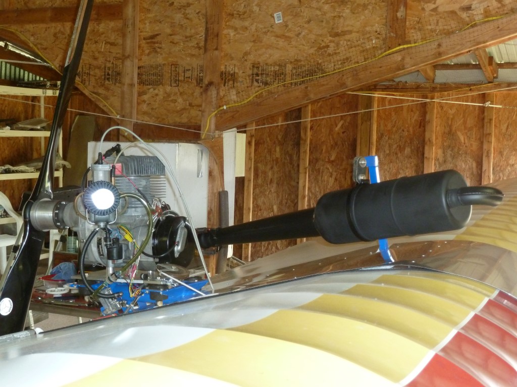

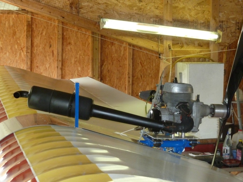

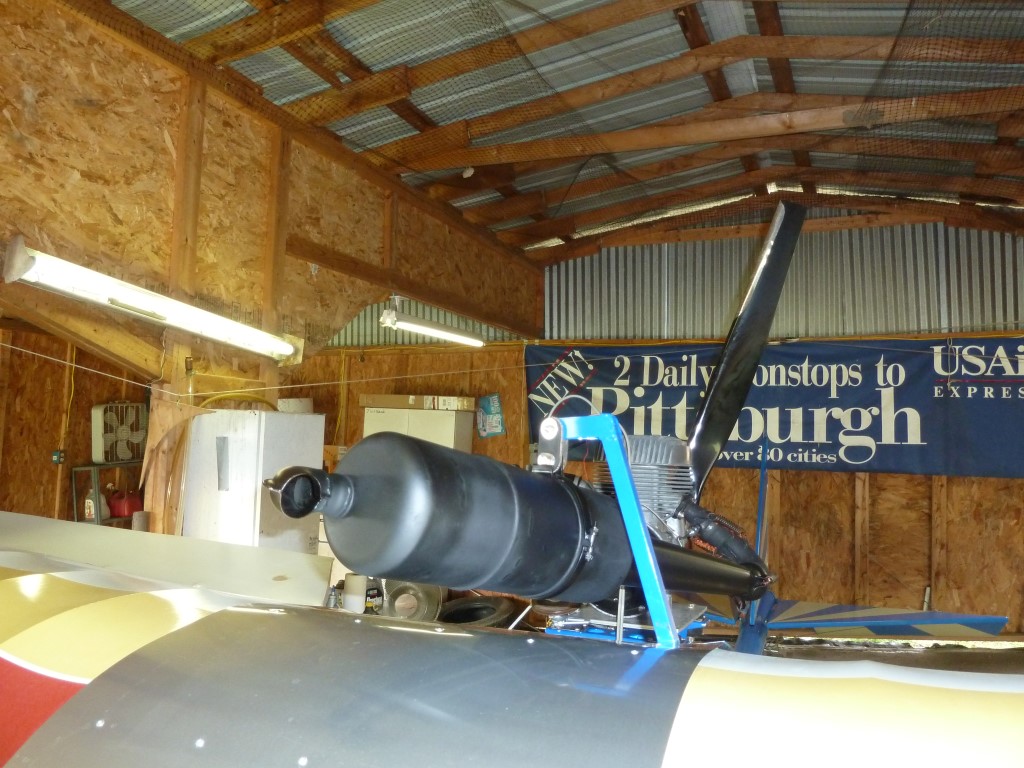

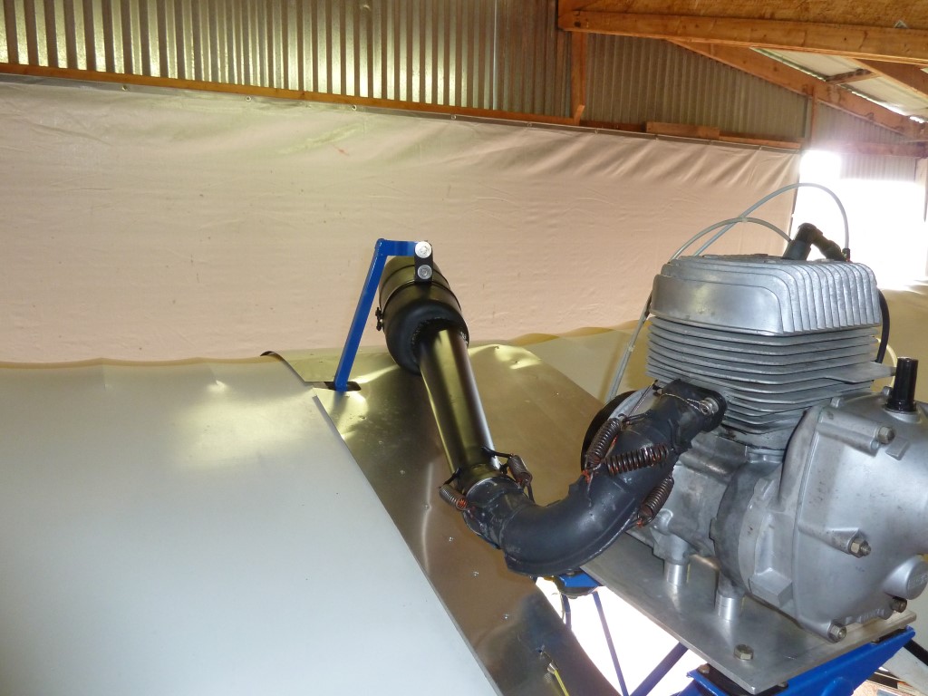

I think we found the vibration problem; we think that dummy Pike designed the rubber muffler hangars incorrectly, allowing a harmonic resonance to set up between the engine and the muffler. Will fabricate new rubber hangars this afternoon to replace the ones that got destroyed in only 3.5 hours of flight, and run it up tomorrow so we can watch it close and see what is happening in that area.
Thanks for all the helpful suggestions.

At least the Ultra Bug is in good company while we try and figure out how to make it's shakes go away:

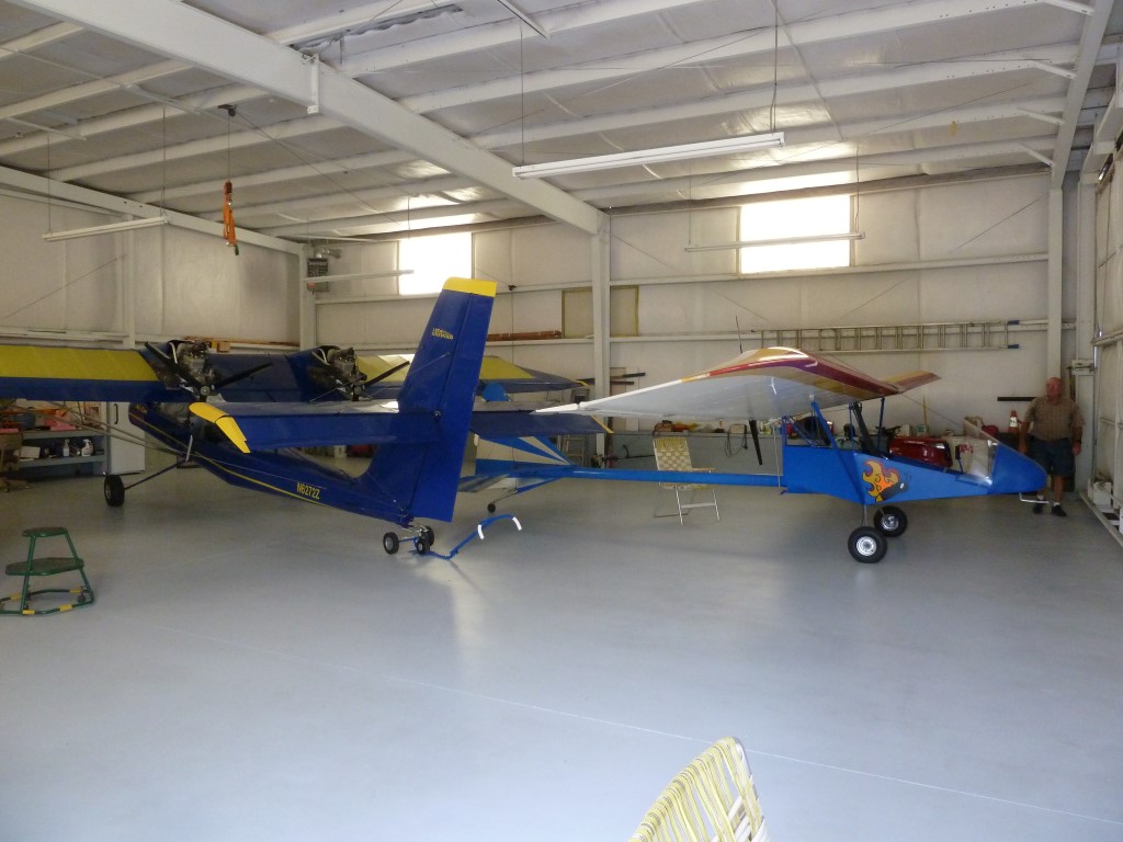

Problem appears to be resolved. It was in how I had tied the muffler to the head braces via the rubber exhaust hangers. I had them too tight, and it set up a resonant interaction between the engine and the muffler. Consequently - during a 1 hour flight - it broke 3 out of the 4 muffler hangars. These are the exact same hangars I use on my MKIII, and typically they last several years, and then I replace them just as a precaution, not because they are damaged or worn.
Ran it a bunch with the new rubber hangars this morning, vibration was about 90% better, flew it a couple times while adjusting the aileron pushrods and resizing the right aileron trim tab, and I think we are about to get it whipped.

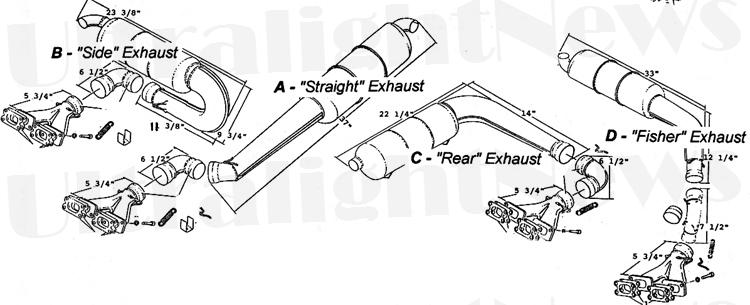

We would like to change the muffler configuration: if anybody has a Rotax straight exhaust expansion cone (A- "Straight" Exhaust in the attachment) and you want to sell it, let me know. Would also consider a "C" exhaust as in the jpeg.

PostPosted: Sat Nov 18, 2017 10:21 am    Post subject: Re: The FireFly flies! (And it flies EXXCELLENT!) Reply with quote
The vibration is now 99% GONE. Over 5,000 rpm it is as smooth as the 582 on the MKIII, between 5,000 and 4,600 you can feel it just a little.
The support bracket is welded to a base that is clamped securely to the the beefy end of the spar carrythrough. Rubber hangars are the usual ones from Advance Auto Parts. I got the tapered cone from Jegs hot rod supplies for $33. A lot cheaper than getting one from Rotax... The length for the cone came from an old LEAF catalog, used the muffler inlet diameter & exhaust ball socket outlet diameter to claculate the cone length & taper, must have got it right, it runs perfect and the EGT's are good.
This whole rig might actually be just as light or lighter than the original hang-it-off-the-head arrangement. Surprisingly it is not any noiser.
