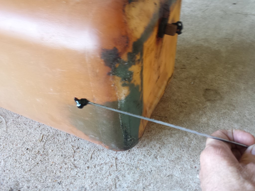

Anyone have an idea on the brown goo in this long-unused Twinstar tank? It's about the color and consistency of old-school Permatex gasket sealant, and just about as sticky. A bit of E-free mogas is marinating it now, and it seems to be softening.
Old 2stroke oil? Actual mogas residue?

That junk looks a lot like what you might see in the bottom of a float bowl that's been sitting for a few years. I'd toss that tank and get a new one. Just as old gas turns to varnish, old plastic gets brittle and even though you might be able to clean that tank out, it's likely a lot more prone to cracking than a fuel tank should be.

Put a prop on it.  The small flywheel doesn't have enough inertia to overcome the compression.
The nasty stuff in the tank is old gas and oil.

You sure got good info. from that post. Throw the tank away. It not worth trying to save it. That's a nasty looking tank.

I'll definitely check the tank for cracking tendencies. It's been sitting for years, but has been inside.
