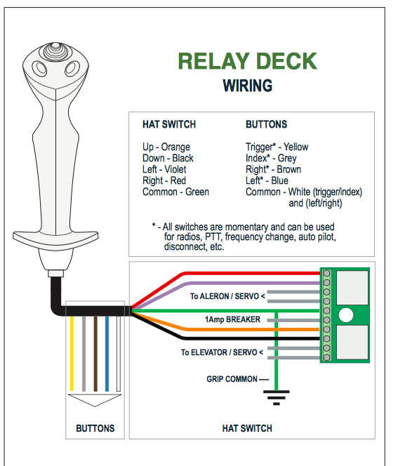

Hello,

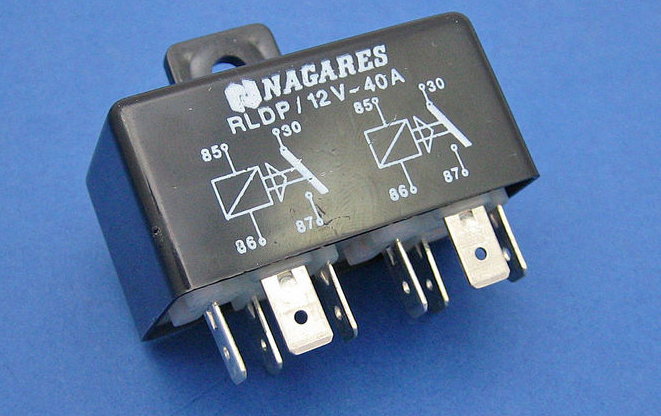

I want to wire my new grip tosten with my basic 12v electrical actuating as trim (up/down) pulling a spring.
I bought a double car relay to do some test to find the good wiring diagram but before that I prefer asking in this forum how can I wire it if anybody know the response ?
Before I was a double pole switch, wire by the previous owner.
I had a problem with the previous wiring, when i actuated my trim, my compas begin to turn completely. The motor/switch were not close to the compas.
I have tested to set the motor very close to the compas to do a test. Without all the wire juste motor and a small battery. And in this case it don't turn ! I don't understand why.
I find this documentation to do my wire.
Thank you in advance.
Mickaël

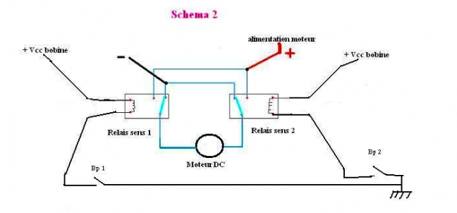

Hello,
Thank you I will do it, it's true that before wire was twist only 3 inch. and the other wire for the trim/switch trim/bus were not.
For the wiring I find a wiring diagram for a car relay, but time to actuate relay is very slow for trim fonction. Any idea to improve ? (special relay ? or other things ? )
Mickaël Wink

Le 23/06/2017 à 14:26, Achille a écrit :
Thank you bob,
I haven't see the response before and I answered in other topic.
I will try it and I will come back to tell if it run better or not. (if it run well also to tell what it was bad if it can help anyone.)
I find relay a bit slow for the motor trim operation, we haven't another solution to wire it with another system ? (transistor ? I don't know well what is it, I just read that on internet)
Achille,
Just in case you happen to be happier posting in French, do not hesitate
to mail me personal in French.
Could you explain what you find so slow in relay operation, especially
considering that most trims are slow operating ?
N'hésite pas à discuter en français !
Best regards,
Amicalement,
Gilles
http://contrails.free.fr
gilles.thesee(at)free.fr
PostPosted: Fri Jun 23, 2017 7:29 am    Post subject: Tosten grip wiring with car-relay for trim Reply with quote
Achille,
Best regards,
Amicalement,
Gilles
Peter(at)sportingaero.com
PostPosted: Sat Jun 24, 2017 6:19 am    Post subject: Tosten grip wiring with car-relay for trim Reply with quote
Have you tried something like Safety Trim?
http://www.tcwtech.com/Safety-Trim%20Page.htm
Peter
kuffel(at)cyberport.net
PostPosted: Sat Jun 24, 2017 7:20 am    Post subject: Tosten grip wiring with car-relay for trim Reply with quote
<< Have you tried something like Safety Trim?
http://www.tcwtech.com/Safety-Trim%20Page.htm >>
Or look at the June 2013 issue of Kitplanes for a do it yourself controller
with all the features and then some of the $400 TCW unit for less than $50
in parts.
Or email me directly for a copy of the article, schematics, photos, etc.
Tom Kuffel
