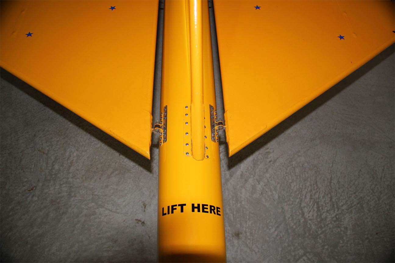

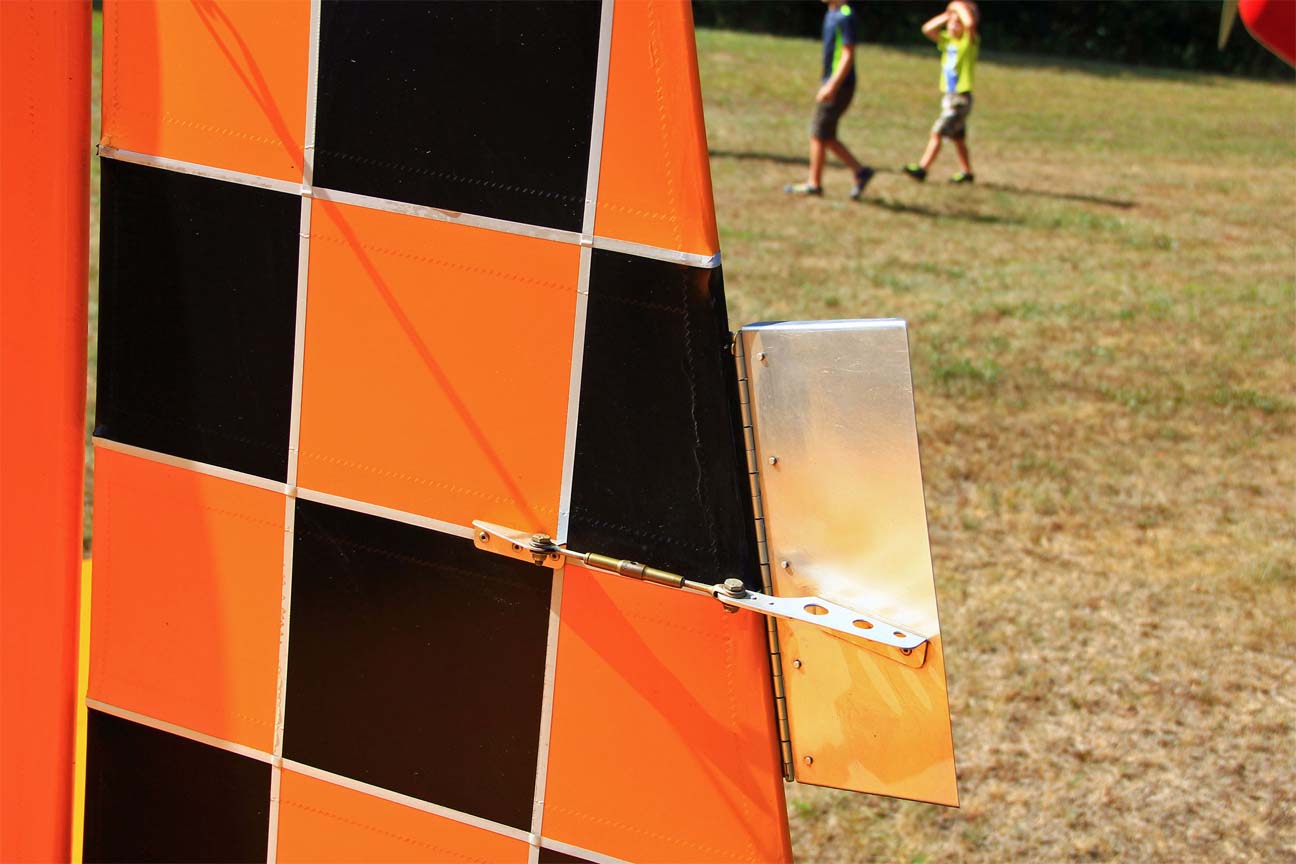

rickofudall
Joined: 19 Sep 2009 Posts: 1392 Location: Udall, KS, USA
Posted: Mon Jun 12, 2017 3:29 pm Post subject: Strange Flying characteristics of new to me Mark III clasic |
If you don't have a set of plans and the construction book you should contact the factory. I've attached the factory blue print for the rudder trim tab required. For the roll issue first make sure the flaps are rigged correctly then you need to check the angle of incidence of each wing and the horizontal stabilizers.
Rick Girard
On Mon, Jun 12, 2017 at 4:11 PM, Rick Neilsen <neilsenrm(at)gmail.com (neilsenrm(at)gmail.com)> wrote:
| Quote: | A Kolb with lots of power does take a bit of rudder to keep it flying straight. Most people add a trim tab to reduce the effect.
A Kolb that wants to roll right or left is a plane that isn't rigged right. The common cause is the wings aren't flying with the same pitch or angle of attack. Kolb sells a wide aft wing attachment fitting that allows one wing to be adjusted by moving washers around on the attachment bolt to trim out minor alignment issues. Use one on both wings for more adjustment. Some people add a bungee cord that pulls the stick to the side. I trim my plane for neutral stick force flying solo but requires a bit of pressure with a passenger. Kolbs are almost never able to fly hands off.
As usual worth what you paid for it.
Rick Neilsen
Redrive VW Powered MKIIIC
On Mon, Jun 12, 2017 at 4:31 PM, jonealjr <jonealjr(at)gmail.com (jonealjr(at)gmail.com)> wrote:
| Quote: | --> Kolb-List message posted by: "jonealjr" <jonealjr(at)gmail.com (jonealjr(at)gmail.com)>
PLEASE HELP IF ANYONE HAS EXPERIENCE WITH THIS
I have a mark III classic w 912 uls Acting odd during taxi needs lots of left rudder to keep on the runway with tail on and off the ground and while flying needs lots of right stick to keep plane level. If you let go of the controls during straight and level flight the plane wants to roll to the left has anyone had similar experiences and or has anybody had any luck with adjusting engine mounts changing the thrust angle to help with aileron trim etc
http://forums.matronics.com/viewtopic.php?p=470012#470012
FORUMS -
WIKI -
b Site -
-Matt Dralle, List Admin.
“Blessed are the cracked, for they shall let in the light.” Groucho Marx

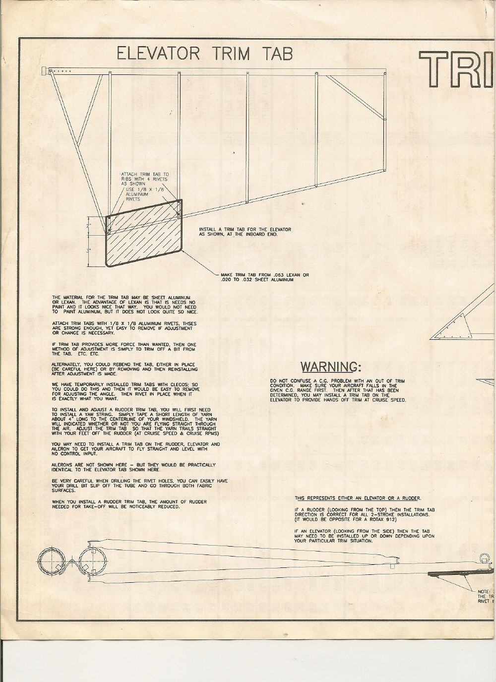

byoungplumbing(at)gmail.c Guest
Posted: Tue Jun 13, 2017 5:48 am Post subject: Strange Flying characteristics of new to me Mark III clasic |
Kolbers,,,,,, I remember a few years back that someone mentioned that they trimmed a Kolb by adjusting the thrust line of the engine by raising or lowering the front or back of the motor mounts. I haven't found the correct search term to find it in the archives.. Is there anyone that is still on the list who can shed some light?
Boyd mkiii Utah

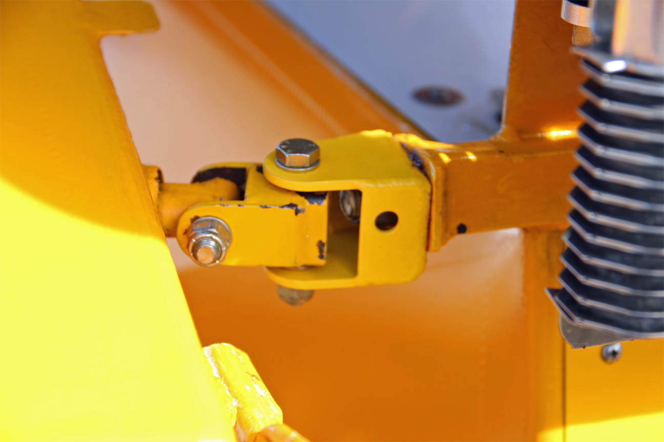

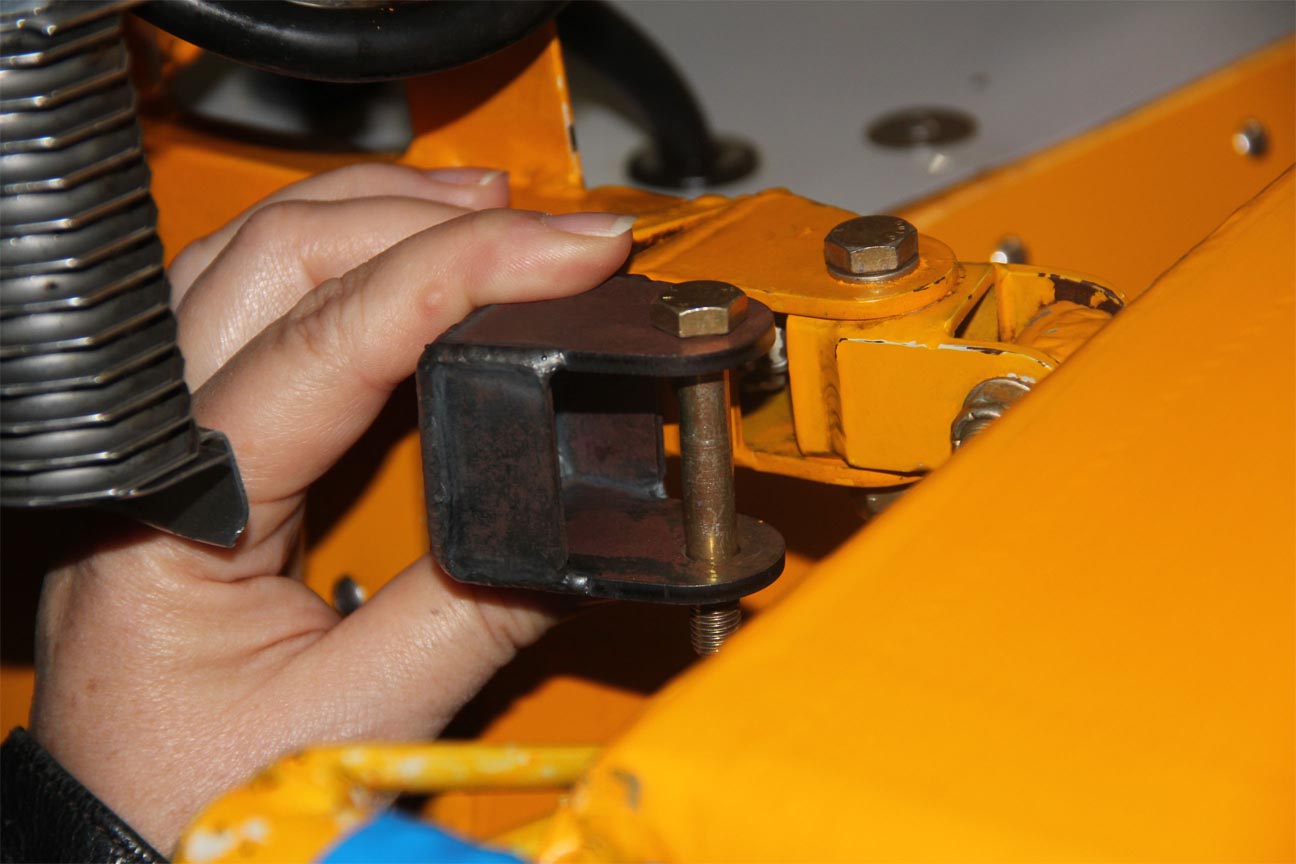

Ralph B
Joined: 14 Apr 2007 Posts: 367 Location: Mound Minnesota
Posted: Tue Jun 13, 2017 7:18 am Post subject: Re: Strange Flying characteristics of new to me Mark III cla |
Here are pictures of the Kolbra U-joint adjust for roll control. Put washers in on top or bottom for whichever the way you want to correct the roll.
Ralph B

stuart(at)harnerfarm.net Guest
Posted: Tue Jun 13, 2017 7:18 am Post subject: Strange Flying characteristics of new to me Mark III clasic |
Jack Hart has a lot of info about this on a Firefly.
http://jackbhart.com/firefly/firefly56.html
Posted: Tue Jun 13, 2017 9:04 am Post subject: Strange Flying characteristics of new to me Mark III clasic |
Stewart, thanks, that link was exactly what I was looking for...
Boyd Young

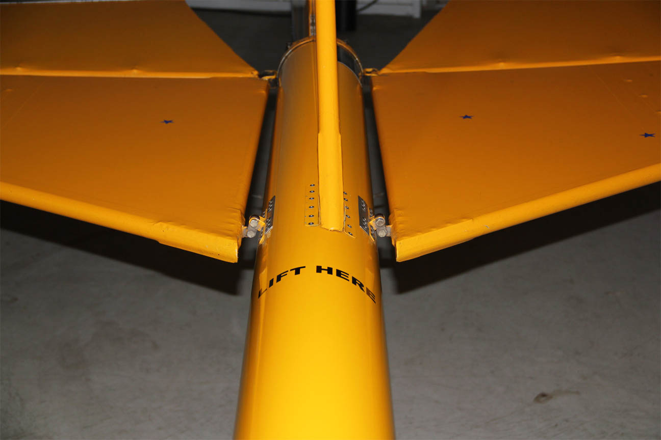

Ralph B
Posted: Tue Jun 13, 2017 11:55 am Post subject: Re: Strange Flying characteristics of new to me Mark III cla |
Along with the U-joints, there is also the offset fin. This was installed by the builder and I don't see how I would do without it. I've also included a picture of the adjustable rudder trim tab. Between the U-joints, offset fin, and rudder trim tab, the Kolbra can fly hands off in calm air. For pitch trim, the builder installed a motorized bungee windup to move the stick forward or aft. It is controlled with a toggle switch for nose up or down trim.
Ralph B

Ralph B
Posted: Thu Jun 15, 2017 5:58 am Post subject: Re: Strange Flying characteristics of new to me Mark III cla |
I failed to mention the Kolbra fin offset was built that way due to the powerful 912 engine that spins in the opposite direction of a 2-stroke engine. From the rear of the airplane, it spins in a counterclockwise direction whereas a 2-stroke will spin in a clockwise direction. This makes a difference in how the airplane is trimmed out. When I upgraded to the 912uls 100hp engine, I was very happy to have that offset built in as the rudder trim tab would not have been able to hold it without using constant rudder on the pedals. Even then, the airplane would have been flying in a constant yawed condition which I didn't like. On takeoff, I use right rudder to counteract P-factor. If the Kolbra had a 2-stroke engine, it would be the opposite left rudder like in a Firestar. May I also say that wind conditions can fool you when making adjustments. On the ground, a crosswind or heavy tailwind can make the airplane difficult to maneuver. Even in the air, a good crosswind will make you hold right or left stick sometimes, so I would say to make all your trim adjustments in calm air conditions.
The original post said his airplane rolled to the left and needed right stick to counteract the roll. If the airplane is rigged properly, this happens due to the torque of the 912 engine and why the fin offset was built into my Kolbra. The same will happen for a Mark III with a 912 engine. This problem has been discussed before and a rudder trim tab will correct some of the problem, but I think the real solution is the offset fin as seen in the above pictures.
Ralph B

upper vertical stabilizer leading edge offset.
I tried for a very long time to get Old Kolb Aircraft to experiment with
offsetting the leading edge of the upper vertical stabilizer on the factory
MKIII because I had an idea that this would help remedy the adverse yaw
problem. However, they never did.
At that time I was flying with a rudder trim tab half the length of what I
finally discovered solved the yaw problem.
The reason I didn't want to experiment on my MKIII was because I didn't want
to drill a bunch of holes and screw up my airplane. I had already made a
17,200 mile flight with the slip/skid ball yawed a half ball out, and got
tired of looking at it. My MKIII flew great this way, but it just wasn't
right.
I started out by offsetting the leading edge by 1/2". No observable change.
Drilled out the SS rivets and tried 1". Very slight change. Finally I got
it pushed over to 1.5" with hardly any difference. Not worth all the
effort. On the down side, doing it my way was actually twisting the tail
post and bending the leading edge tube of the upper vertical stabilizer
which eventually failed. Big job repairing this. When I did I went back to
centering the upper vertical stabilizer the way it should be.
Then I decided to experiment with the rudder trim tab. I chose to go big
and built the first one three rib bays long. Wow! That was an overkill.
Since I had attached with duct tape, I snatched it off, cut off a third (one
rib bay), stuck it back on and discovered it was perfect. Slip/skid ball
centered with my feet on the deck.
I think Mark German modified the tail post on his Kolbra after he saw mine
and talked with me. Cannot remember for sure.
There is no need to offset the upper vertical stabilizer because an adequate
rudder trim tab solves the yaw problem. A much simpler and effective
solution.
Direction of prop rotation and HP did not make much difference to the yaw
problem. I had it with 65, 80, and 100 hp on my MKIII.
