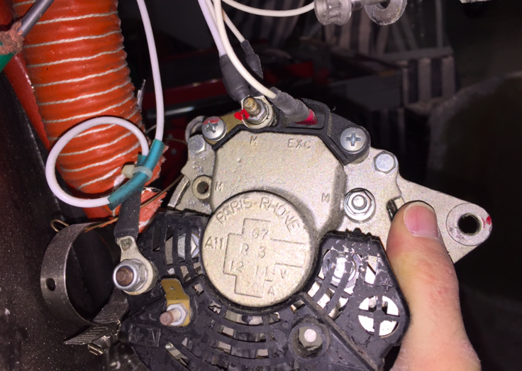

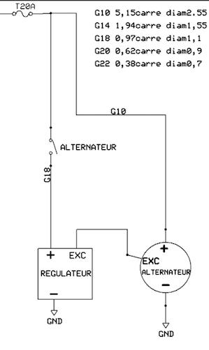

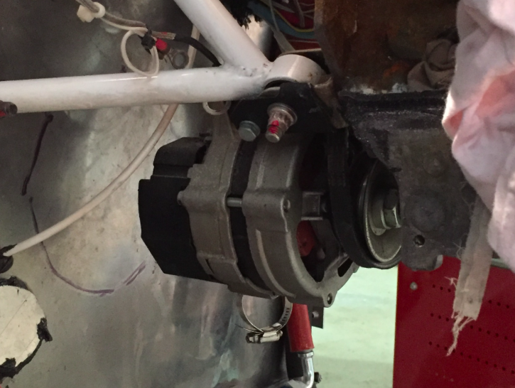

Achille
Joined: 12 Jun 2017 Posts: 25 Location: Europe
Posted: Wed Jun 14, 2017 7:17 am Post subject: Re: Question about Z19RB and OVP/Beaker and size wire |
Thank you Bob for your response.
How could I check if my alternator is compatible with en external OVP before wiring it ? (it is not wired anymore)
It was wired like the picture attached in this message. (drawn by constructeur)
Thank you.
Mickaël
