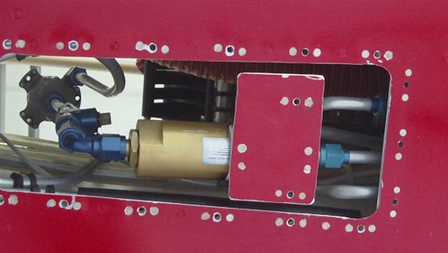

After an RV-10 caught fire and was destroyed a few years ago due to fuel
leaking and accumulating in the tunnel I have made it a priority to check
the tunnel more often than yearly. Since it is a pain to remove the carpets,
etc. to gain access from the top I cut an opening in the floor. I left a
section of the original floor that has the filter clamp base on it. I added
some platenuts to hold the cover. I have a short bracket that locates the
section relative to the cover holes when I reassemble it after cleaning. Got
to get down but it maakes short work of filter cleaning and tunnel
inspection.
