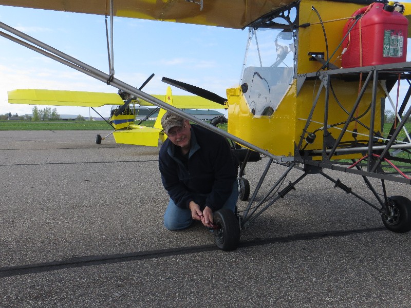

PostPosted: Wed May 10, 2017 9:26 am    Post subject: Re: Tires and Inner Tubes Reply with quote
I am starting to think this tire thing is a jinx!
 Filesize:  175.02 KB
 Viewed:  9277 Time(s)
West1m
