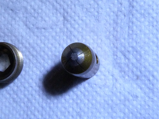

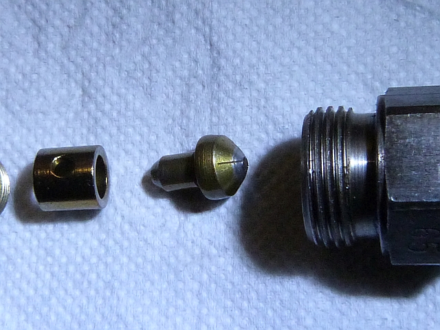

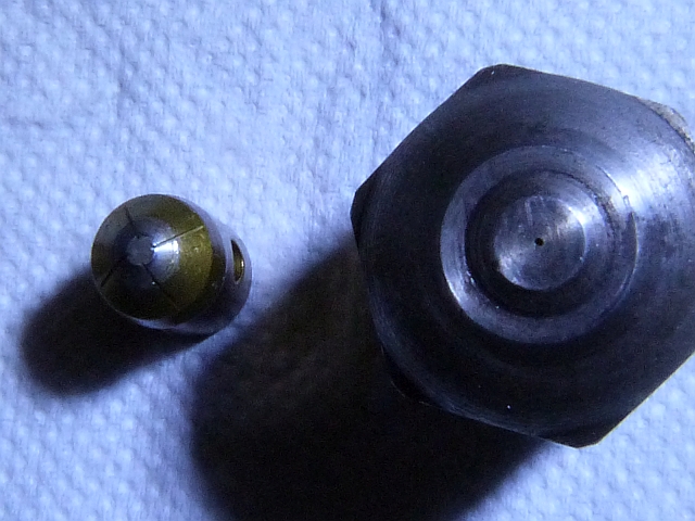

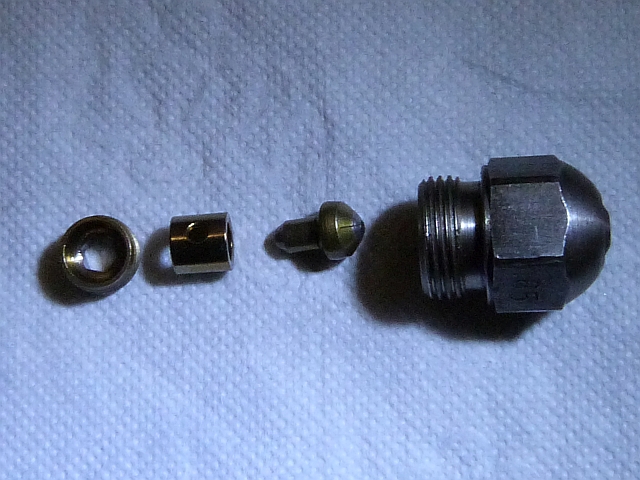

Hi Phil,
I did not like the design of the jet, so was thinking along the lines of jets used in central heating oil burners. There is a taper top seated inside with very fine grooves that do not point exactly to the center. That is to produce some swirl and resulting in a cone of oil spray out of the tiny jet. For primer application all details can be much more rough than for burner use. You have to experiment a little with water from your water tap at home to see what it does. But it is no very big deal to make up a jet for your purpose and maybe use some part of a burner.
Vic
