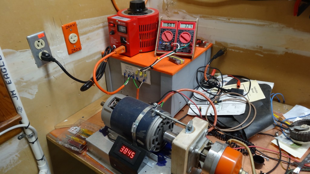

I've finished some preliminary operations on the
as received SD8 and companion R/R. They seem to
function pretty much as designed.
2800 RPM produces 3+ amps at 14.4v
3300 RPM produces 4+ amps at 14.3v
3800 RPM produces 8+ amps at 14.1v
At the final load setting, current
in the SD8 windings was 10.5 A(rms)
I can return this hardware if you'd like to
have it around for spares. At the same time,
it would be interesting/useful to add it to
the constellation of test tools I'm
building around a 2HP drive-stand with
and AND20000 spline pad on it.
[img]cid:.0[/img]
As an interesting aside, test data were taken
without a battery on line . . . this prevented
pollution of current values dialed into the dynamic
load bank. I was able to 'tickle' the dynamo-r/r
into operation with a momentary application of battery
power. On one fire-up/shut-down cycle, the capacitor
was still charged to about 3 volts and the system came
on-line with only a small fraction of start up
excitation offered by the ship's battery.
