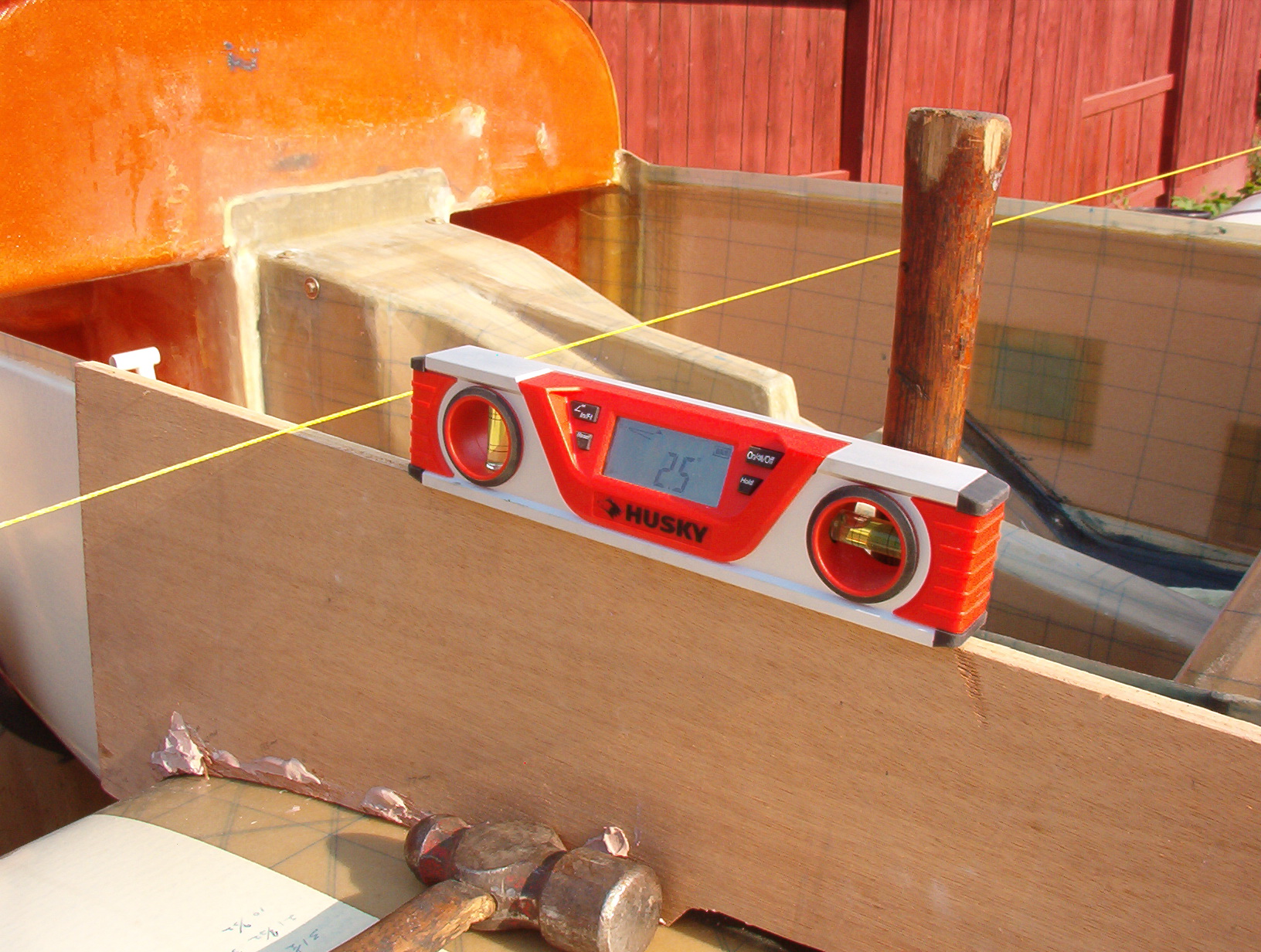

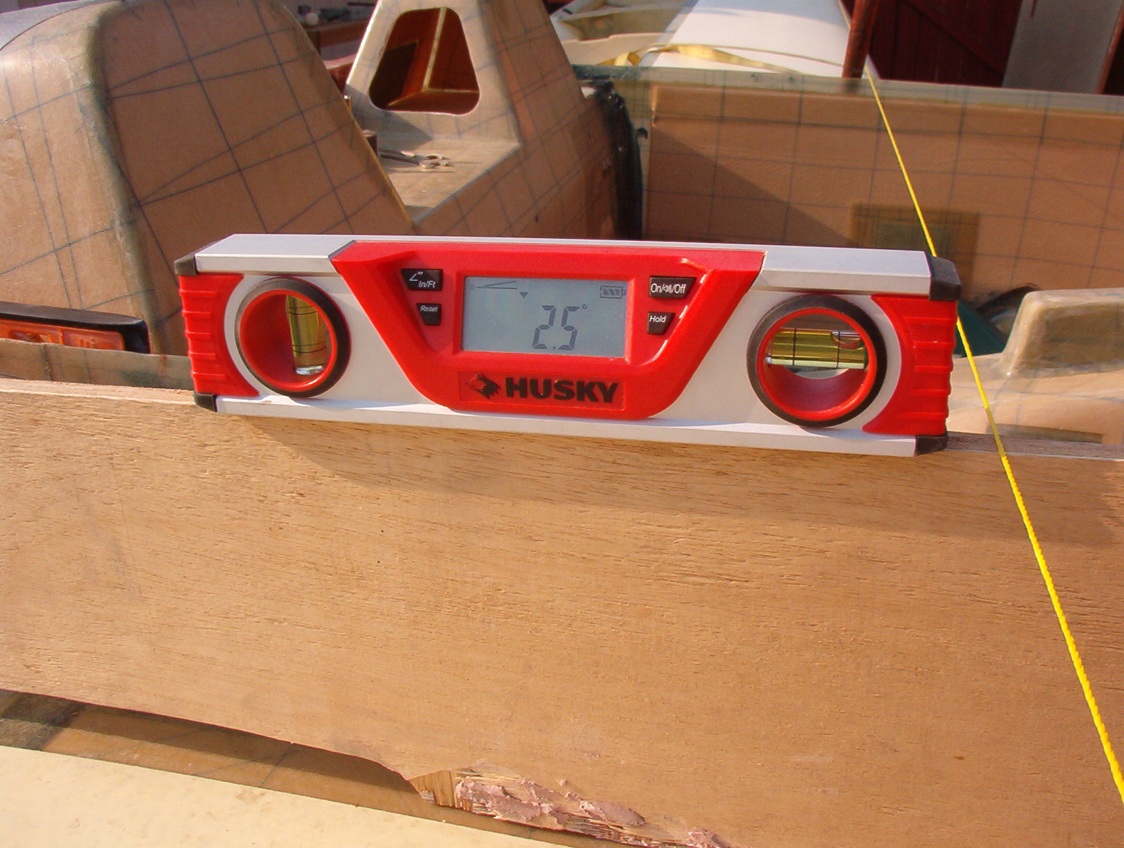

I too have the high top. The only place that will work is the top of the fuel tank between the two head rest. You will need the Template or make it. Then read and Chapter 27.
 Filesize:  757.56 KB
 Viewed:  6954 Time(s)
 Filesize:  801.72 KB
