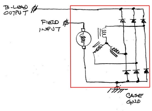

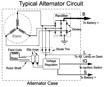

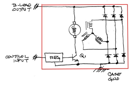

One point that is not clear for me about the internal/external VR discussion.  I apologize in advance if this has been clarified somewhere else and I just missed it.
I don't understand why or how an external voltage regulator can safely cut the field using the crowbar method and an internal regulator cannot.  If I look at the wiring diagrams there does not seem to be a difference.  Is it just that the external VR is more robust?
Thanks for any clarity you can provide.
Mickey Coggins
http://www.rv8.ch/
With an external regulator, the crowbar shorts the field winding to ground, tripping the field circuit breaker (typically 5 amp rating). One cycle on the breaker; no damage done.
You can achieve the exact same thing with an internally regulated alternator, but you must open up the alternator, find the field lead from the internal regulator to the field winding, and bring it outside the alternator to a field CB, then back to the winding. It can be done, if you know what you're doing. But it *is* a significant 'invasion' into a very well thought-out and tested (by auto engineers) system, so there's risk of doing it wrong, or just upsetting the design. It could be as simple as: the act of re-routing the field wire could make it more vulnerable to vibration induced failure. (Just one example.)
The simpler method is to add an external contactor in series with the B-lead, and feed its coil through that 5A breaker. Then the OV module would short the coil circuit to ground, tripping the breaker and opening the contactor. That's the technique used on the permanent magnet alternators, that have no field winding. Bob no longer includes that method in the book. If memory serves, there were issues many years ago where some were 'testing' the OV feature (or their 'traditionally wired' split master switch) while in flight (with the alternator loaded), and by 'dumping' the load, the perfectly good alternator could fry its internal regulator because the regulator couldn't respond quickly enough to keep the sharp rise in voltage from damaging internal semiconductors. In the immortal words of the Hee Haw TV show doctor, 'If it hurts when you do that, don't do that.' The only reason to operate that contactor is if the alternator has already failed.

PostPosted: Tue Apr 25, 2017 4:49 am    Post subject: Interesting thread on overvoltage event Reply with quote
Mickey
I suspect that something about the diagram you are looking at is
misleading you.
Recall that the voltage sense wire (or any of the small wires) going
into an internal vr alternator do not normally supply the field. The
internal vr alternators that I'm familiar with will continue to output
power if all the small wires are disconnected.
As mentioned, there is no external connection or wire between the
internal vr and the field winding unless you modify the stock alternator.

Because I am installing the optional 40 amp Rotax alternator (internally regulated Denso) this discussion is very interesting to me. >From what I am reading, it sounds like the only way to shut it down would be to interrupt the output (B wire) with a switch or pull breaker.
If that is the case, what is the purpose of the IG wire, which runs from the bus, through the master switch, to the alternator?

The internally regulated alternator gets its field power from within the alternator.  There is no easy way for the pilot or for an over-voltage protection module to interrupt that power.
  The externally regulated alternator gets its field power from a panel mounted fuse or circuit breaker or switch.  It is much easier to interrupt the external field power source.

Thanks for the info.  My question is much more "novice".  Perhaps I should describe it a different way.
Imagine I took the B&C voltage regulator, and made it the size of a dime, and stuffed it into an Externally regulated alternator.  How would that be different from what Denso does with their internally regulated alternator?
From what I see from the diagrams, the VR simply decides how much V to send out the F wire.  Why would the external give more control?
Thanks for any clarity!  Smile

  The externally regulated alternator has NO electronics
  inside . . . just a rudimentary alternator.
[img]cid:7.1.0.9.0.20170425080902.0207e8c0(at)aeroelectric.com.0[/img]
  Interrupting the 'field input' line offers total
  control over alternator output.
  The internally regulated alternator has solid
  state devices that control alternator output.
  There is no field power input connection, only
  a 'control' connection that talks to the
  electronics.
[img]cid:7.1.0.9.0.20170425080902.0207e8c0(at)aeroelectric.com.1[/img]
  There are failure modes INTERNAL to the alternator
  that can cause an over voltage condition . . . a
  condition not controllable from outside.
  Hence, the legacy preference for externally regulated
  alternators that allow a system integrator to include
  over voltage protection in some form. It doesn't
  have to be the 'crowbar' style . . . there are several
  satisfactory approaches.
