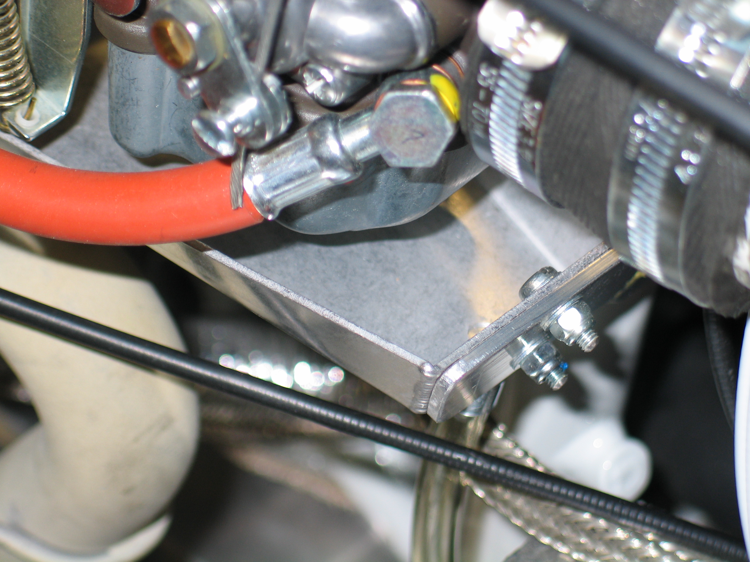

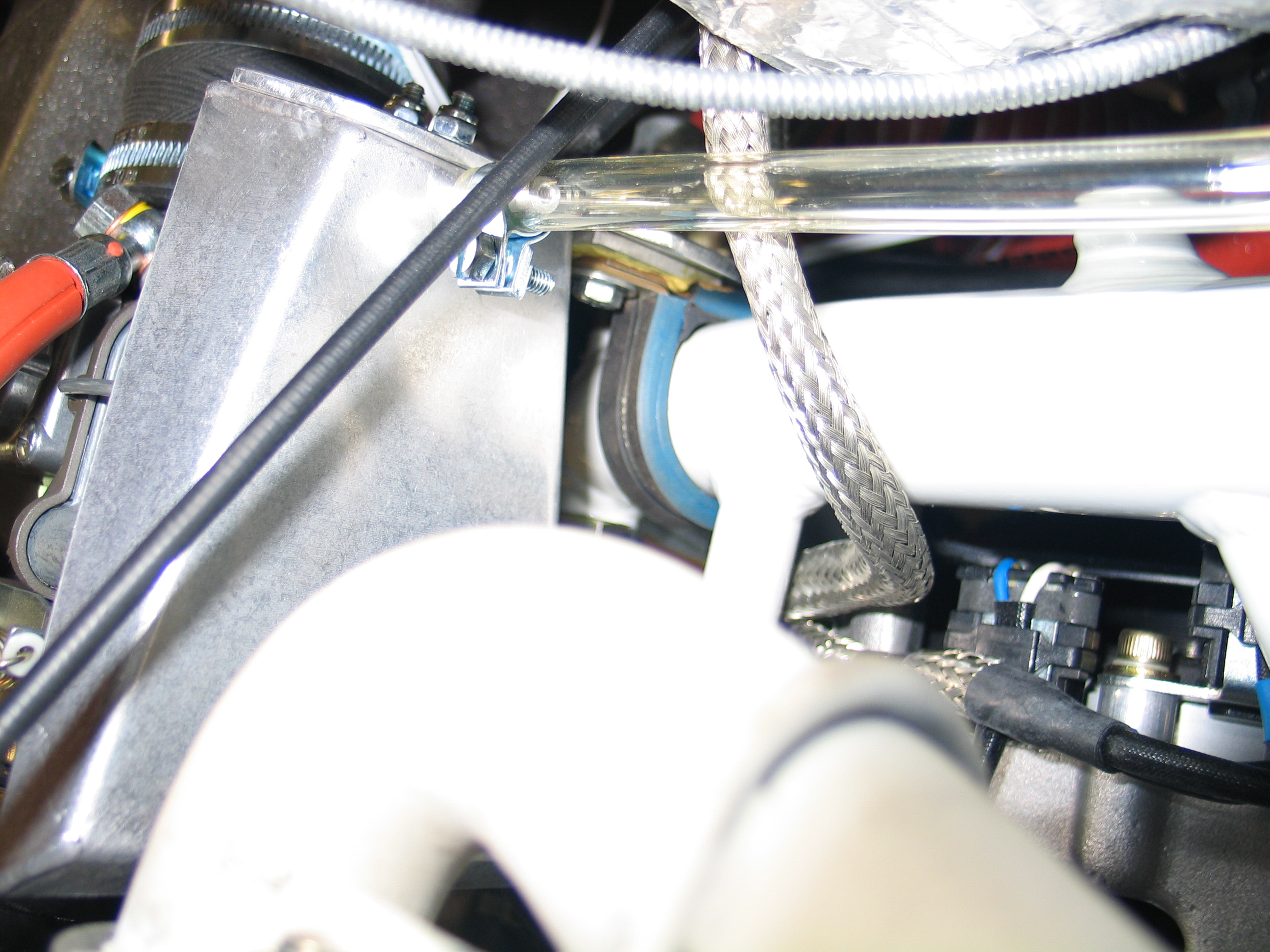

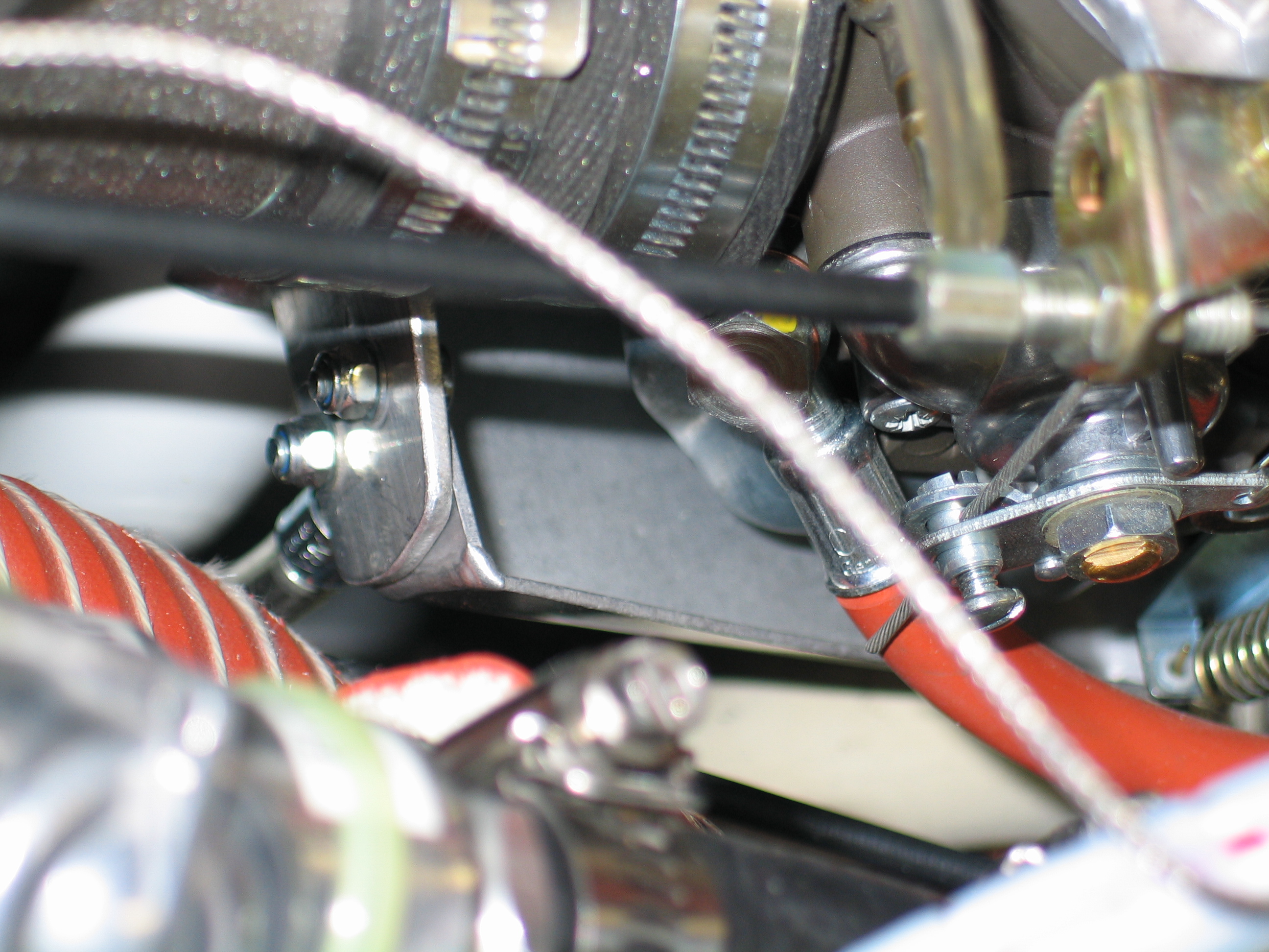

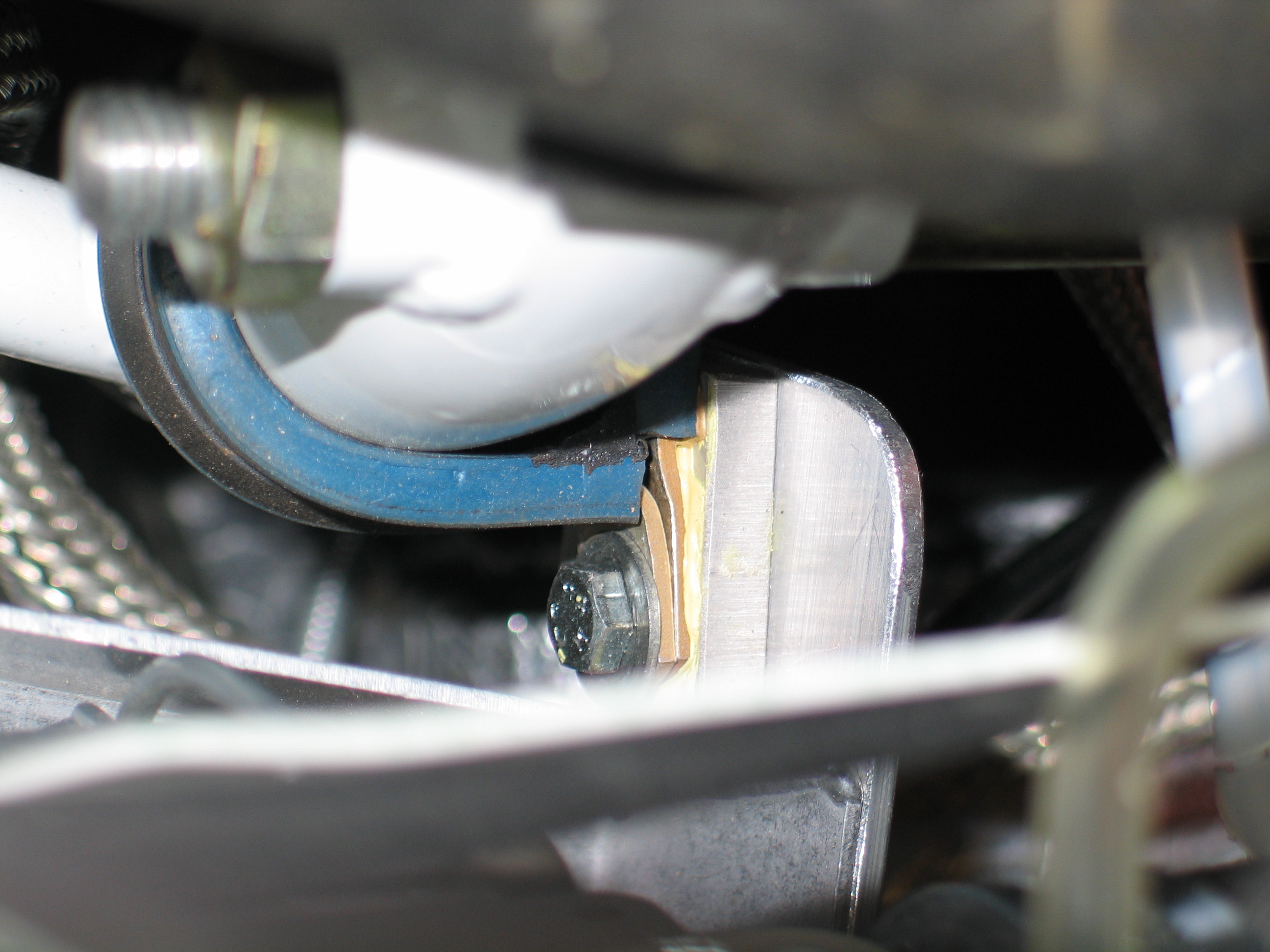

PostPosted: Mon Apr 10, 2017 10:38 pm    Post subject: Re: 912ULS Carb drip trays Reply with quote
Richard,
There are indeed two different types of Rotax drip trays. I have the flat version that Rotax sold with their airbox. I don't know if they sell it separatly. See the attached pictures.
Regards, Alfred
