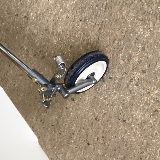

I'm enclosing a couple of pictures of the new tailwheel assembly available from Kolb Aircraft LLC. I had ordered this because I knew that Firestar 1 that I was picking up from California and bring back home to Michigan had the old cookie cutter wheel w/ the old fiberglass tail rod which are prone to failure. This one failed the day after I unloaded the aircraft.
I'll finish the project tomorrow with the installation of new rudder horn to tailwheel springs. You could also use some short compression type springs if you'd prefer?

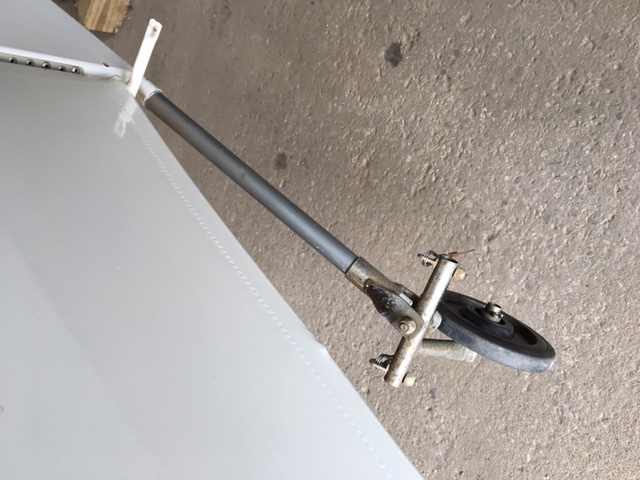

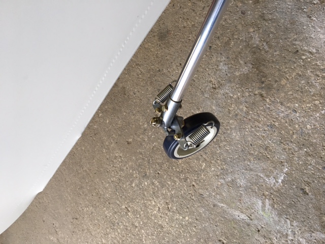

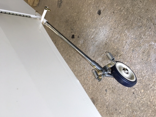

gdhelton(at)gmail.com Guest
Posted: Mon Apr 03, 2017 4:57 am Post subject: Kolb breakaway tailwheel |
Correct, the old tailwheels were installed by using JB weld as was the tailwheel rod into lower vertical stabilizer/ rudder post. It's a real job drilling it out. I installed the new rod with one AN bolt and coated the inside of each receiver tube with silicone to seal out moisture.
Here's a before and after picture.
Posted: Mon Apr 03, 2017 9:20 am Post subject: Kolb breakaway tailwheel |
It was the OLD TAILWHEEL that failed. And to make it clear, it's not the tailwheel itself that fails. It's the old fiberglass shaft/ rod that fails or the JB weld that they use to use to mount the wheel assembly. My plane was originally built in 1985/86. They didn't use 7075 T7 aluminum tailwheel rods back then.
