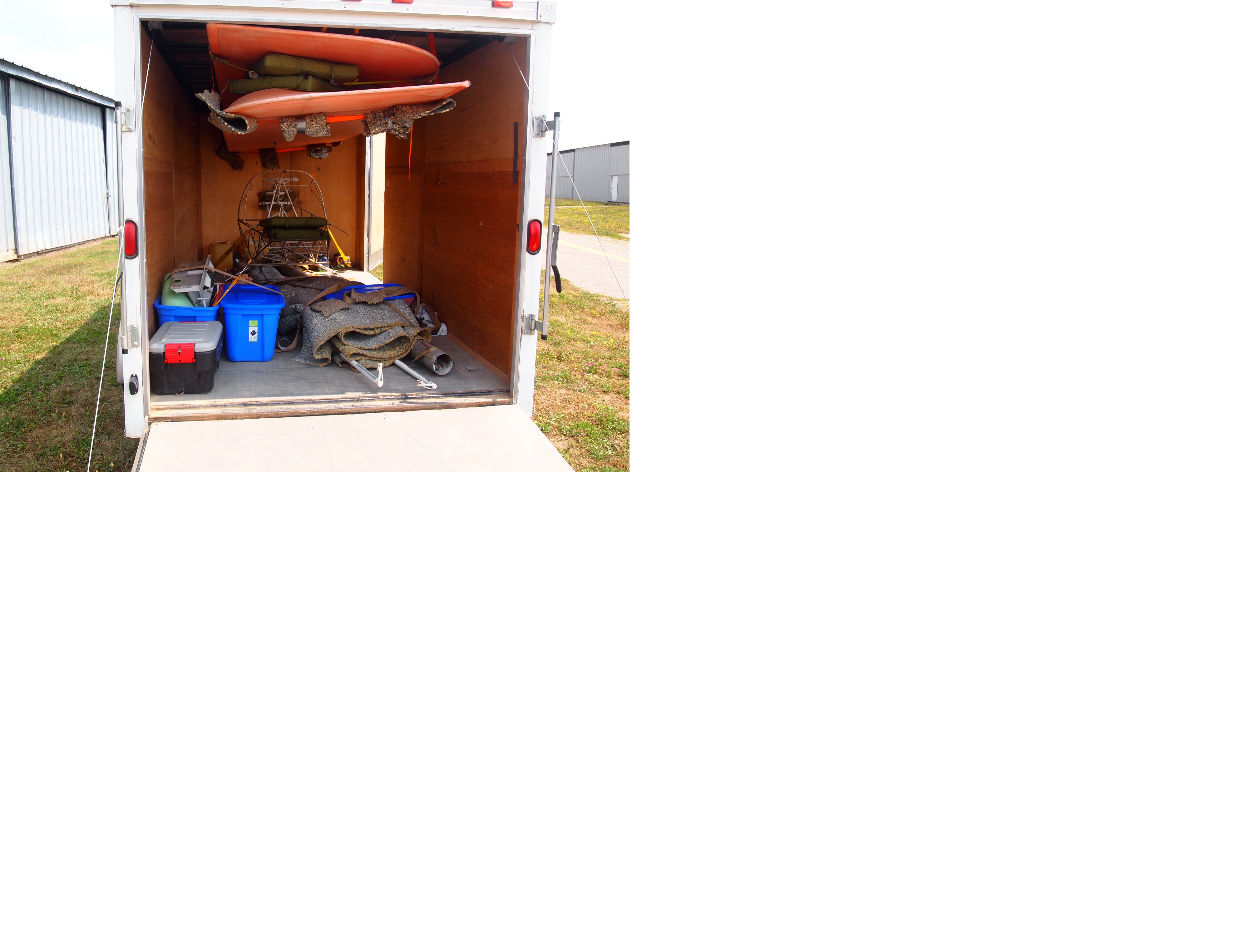

gdhelton(at)gmail.com
PostPosted: Sat Mar 18, 2017 11:19 am    Post subject: road transport question Reply with quote
Having owned, built and flown a twinstar. I'd say that I'd try find something fully enclosed. That being said, if you could put the cage and stuff like the engine, etc. in the pickup bed? The wings could be transported in good wing rack, wing facing forward towards the truck. Should really pad and cover well. If damage a wing it will be really bad news. Attached is a picture of my shop wing rack.
Have a great day!

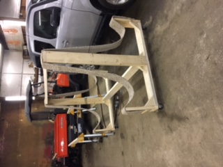

PostPosted: Sat Mar 18, 2017 12:56 pm    Post subject: road transport question Reply with quote
Thanks for the pic; looks just like what we RV-x guys use for our wings. Are you saying that the rack pictured would be adequate for road transport of the wings? Are the leading edges strong enough to support the wing weight on a couple of 8-10" wide carpet strips? If so, that would simplify my task considerably. The rest of the stuff I can deal with, but the wings concern me. I was envisioning something more like a couple of heavily padded shelves as big as the wing(s).

zeprep251(at)aol.com
PostPosted: Sat Mar 18, 2017 1:02 pm    Post subject: road transport question Reply with quote
We use 4" foam rubber
PostPosted: Sat Mar 18, 2017 1:10 pm    Post subject: road transport question Reply with quote
I would actually prefer either adding a couple more straps inboard to this design. I would use some dense foam where the leading edges rest. I'd use some light straps to hold the wings in place. Wings need to be covered to keep air blast from go in between.
Have a great day!
George ( Maddog )

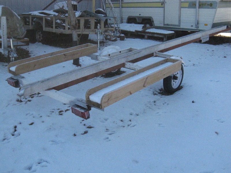

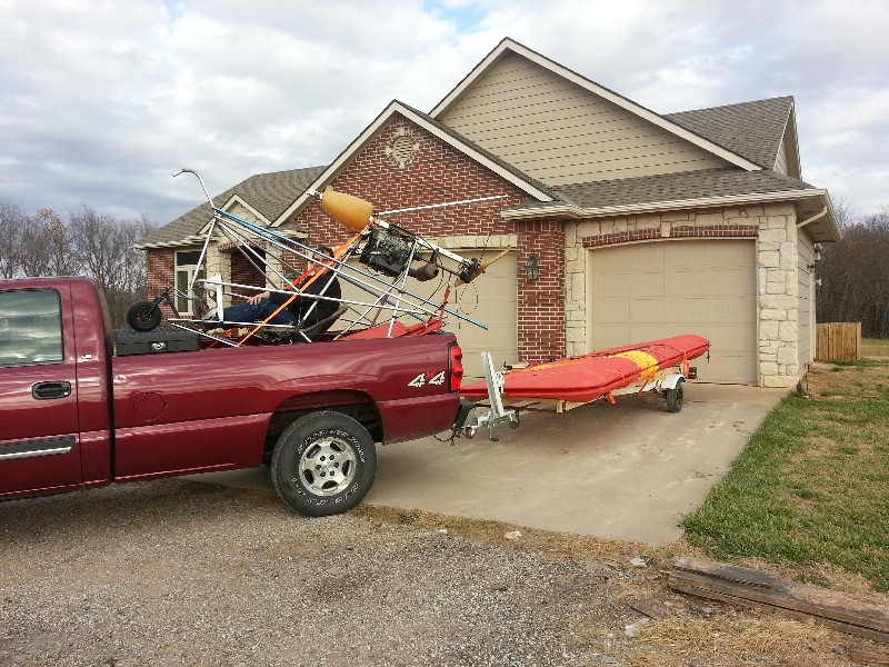

PostPosted: Sat Mar 18, 2017 1:34 pm    Post subject: Re: road transport question Reply with quote
My money is on the boat trailer. I brought home a Quicksilver from Wichita (to Saint Paul, MN) using a boat trailer and later brought home my Firefly on a boat trailer from New York. I think it cost me more in tolls than gas!

ceengland7(at)gmail.com
PostPosted: Sat Mar 18, 2017 2:19 pm    Post subject: road transport question Reply with quote
My T-18 trailer actually looks a lot like that, except the axle is farther aft to support the weight of the T18's Lyc engine.
Thanks for all the suggestions; I'll likely head down there with  a stack of 2x4's, several sheets of plywood, and a trunk full of pads & foam sheets.
