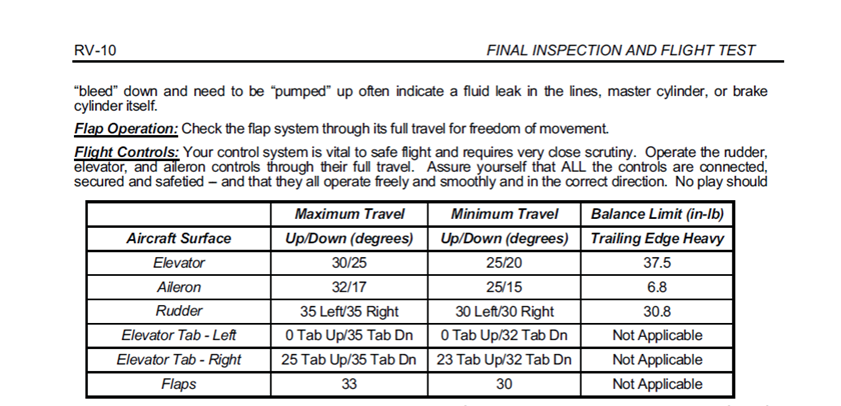

I just posted this image via email but it looks like it never made it to the list.
The Elevator tab at 35 degrees down is the elevator trim tab they are talking about not the elevator itself.

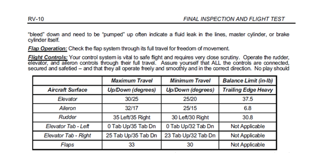

PostPosted: Tue Mar 14, 2017 6:23 pm    Post subject: Tailplane attach Reply with quote
Here are the limits:

Ah sure. For the trim tab you will for sure want good travel for tab down to ensure you have full up-elevator travel and trim.
Tim

PostPosted: Tue Mar 14, 2017 7:11 pm    Post subject: Tailplane attach Reply with quote
Thank you-- I hadn't seen that page yet!

http://forums.matronics.com//files/final_inspection_limits_167.png
Steve
You're welcome! BTW in older kits that elevator trim nut used to have a crappy weld on it. At the time i was working on mine (2008) there was an aftermarket part available machined out of aluminum. Van's later fixed theirs. I attached mine with #6 screws and locknuts, like Phil suggested.
