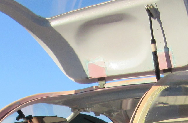

PostPosted: Thu Mar 09, 2017 5:20 am    Post subject: Door seals Reply with quote
See previous reply, my seal is in fact on the frame. picture attached

rene(at)felker.com
PostPosted: Thu Mar 09, 2017 5:54 am    Post subject: Door seals Reply with quote
I will be at the airport tonight......will take a picture.

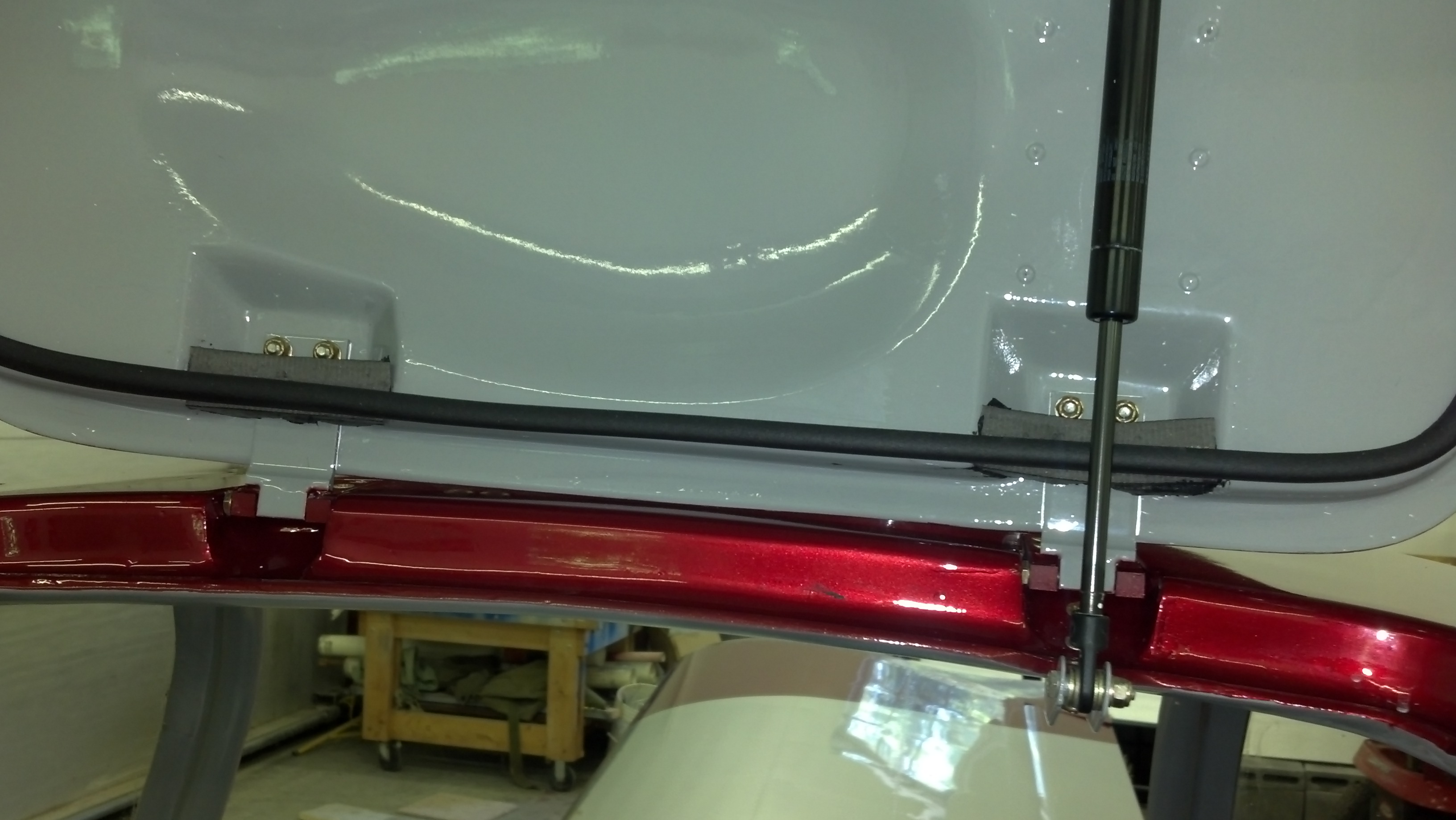

carl.froehlich(at)verizon
PostPosted: Thu Mar 09, 2017 7:17 am    Post subject: Door seals Reply with quote
Simple to install and works well. Self adhesive seals from McMaster. Five years of service with no issue.
Carl

You have to fabricate a cover over the door hinge at where the door
comes down, so the seal has something to compress against. I used scrap
fiberglass from trimming the window openings. Cut to fit, then bonded
with some super fill.
