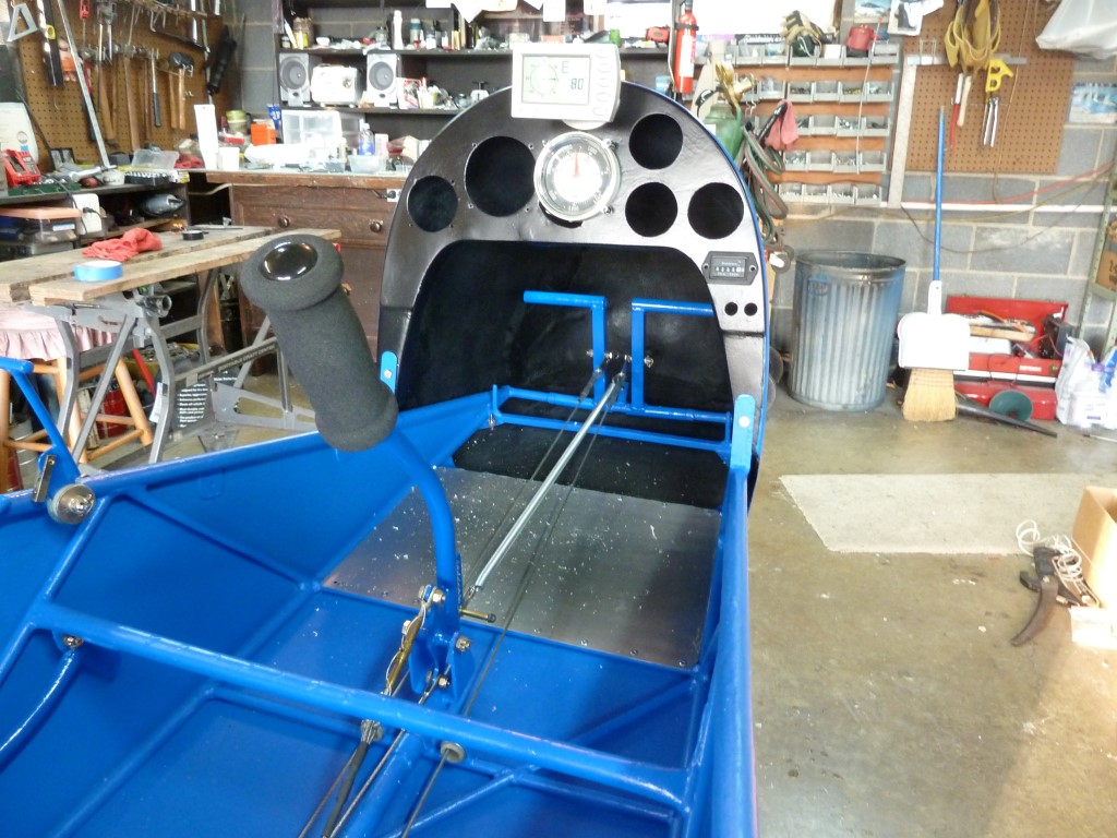

Not planning any electrical system for the Firefly, but would like to hook up a Hobbs meter. We already have one that came with the wreck that shows the actual time of the 447, and our current panel has a cutout for it.
But I do not know how to make it work w/o a 12V system. Anybody know how?
Here's a couple pictures - engine is on the mounts, piddling with the panel. Pictures are not that great. At least they are not too big...

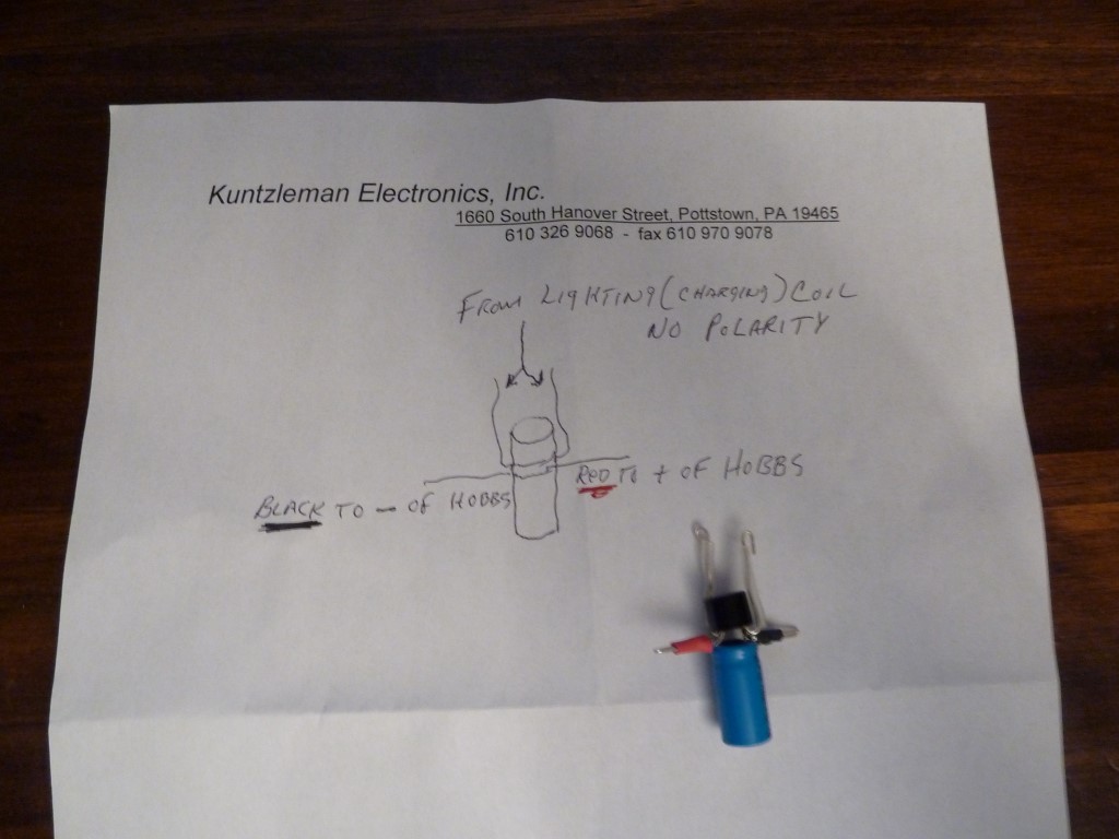

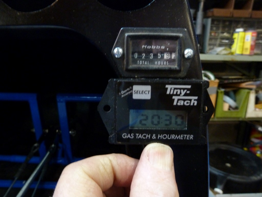

PostPosted: Fri Feb 24, 2017 7:08 pm    Post subject: Re: Hobbs meter? Reply with quote
Tiny Tach is great, I have one on my MKIII, but it is bigger than a Hobbs, and we need something to cover the hole where the original Hobbs was in the panel. No way the Tiny Tach will fit. Not to mention that I would need to figure out how to add 216 hours to it....
Talked to the original owner of our Firestar a while ago, and he seemed to remember that he got that diode from Kolb, and they told him how to hook it up. But he wasn't sure... (Grin)
Will try hooking the Hobbs up to the charging coil, through the diode, and see what happens.

PostPosted: Sat Feb 25, 2017 7:32 am    Post subject: Hobbs meter? Reply with quote
Along with the diode, a full wave bridge would be better, you should connect a capacitor (22mf 180v) across the output to filter the pulses.
Dick

PostPosted: Sat Feb 25, 2017 5:18 pm    Post subject: Re: Hobbs meter? Reply with quote
Dick
OK, I think I know what you are saying, but you are talking to an electronics Hottentot. Really. Do I just go to the local electronics supply store and ask for such? And then attach it between the connectors?
Thanks!

PostPosted: Thu Mar 02, 2017 10:45 am    Post subject: Re: Hobbs meter? Reply with quote
The mail lady left me a padded envelope in the box today, and inside it I found this: from Dick Kuntzleman, who took the time and trouble to spoon feed an electronically ignorant old man.
Thank you Sir, you have made my day.
