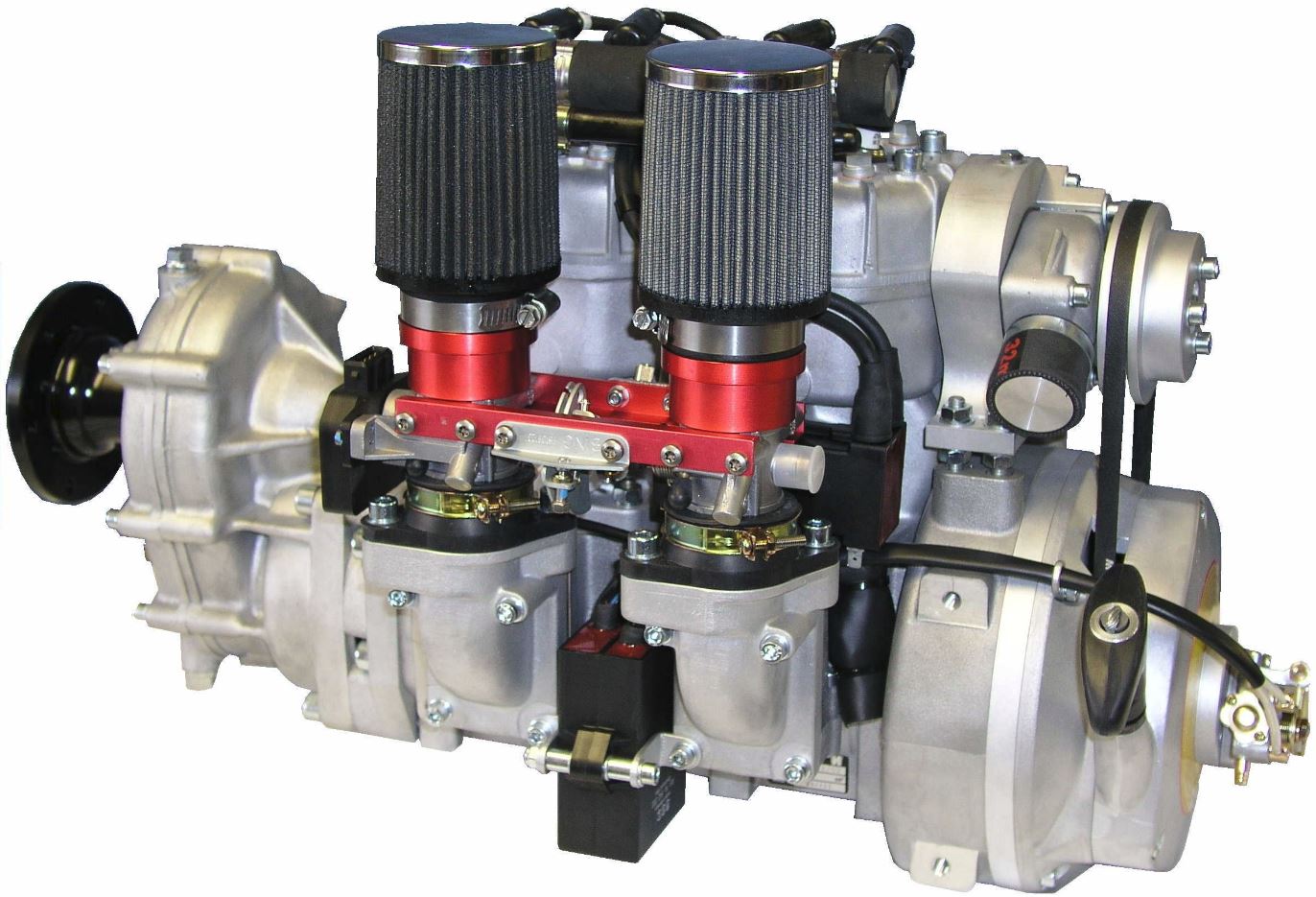

Kinda depends on whether it mounts inverted with the cylinder head down on the bottom (probably gives the best thrust line orientation to the top longerons), or if it installs upright with the head and plugs on top. If you install it that way, the engine will probably have to sit pretty tall to get the engine thrust line where it needs to be.
Alternatively, you could creep up a little bit from your 50HP 503 and hang a Rec Power 2-cyl, 2-stroke 625cc on it for 60HP and water-cooled, so you could keep the authentic Ford look with the radiator up in front of you ;o)

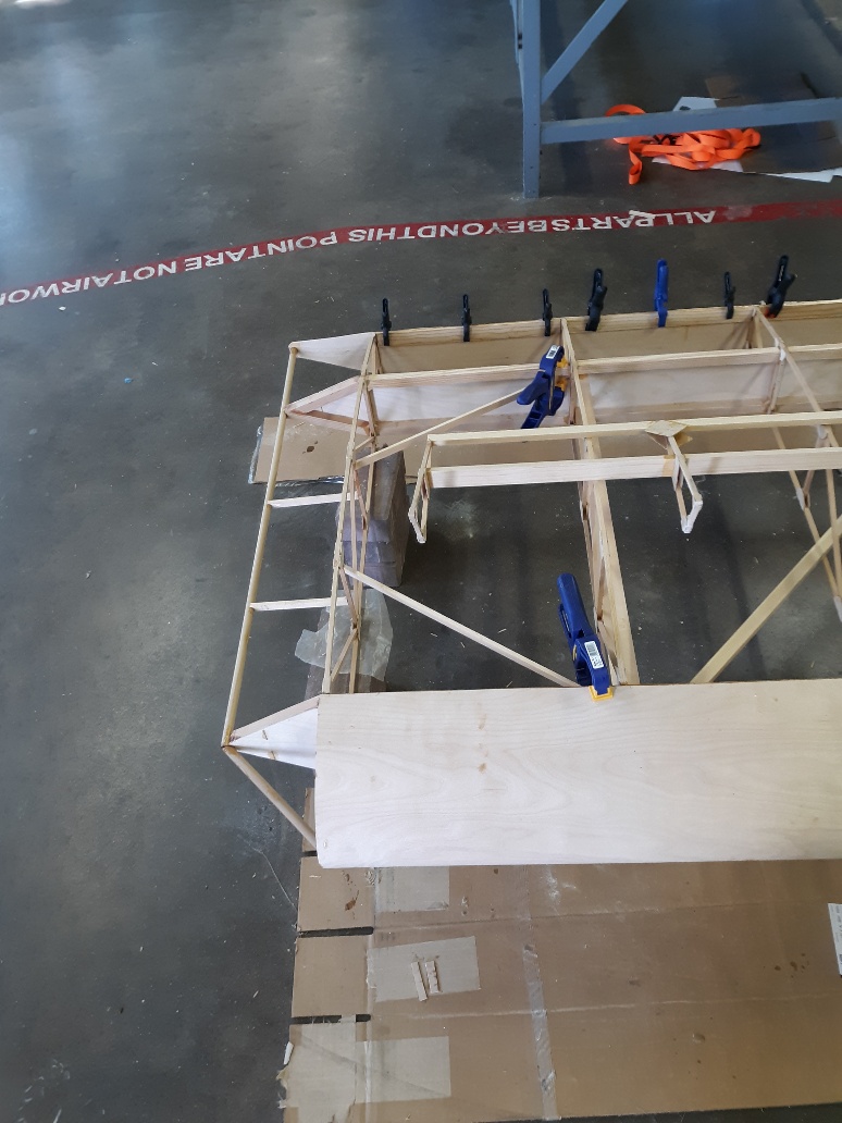

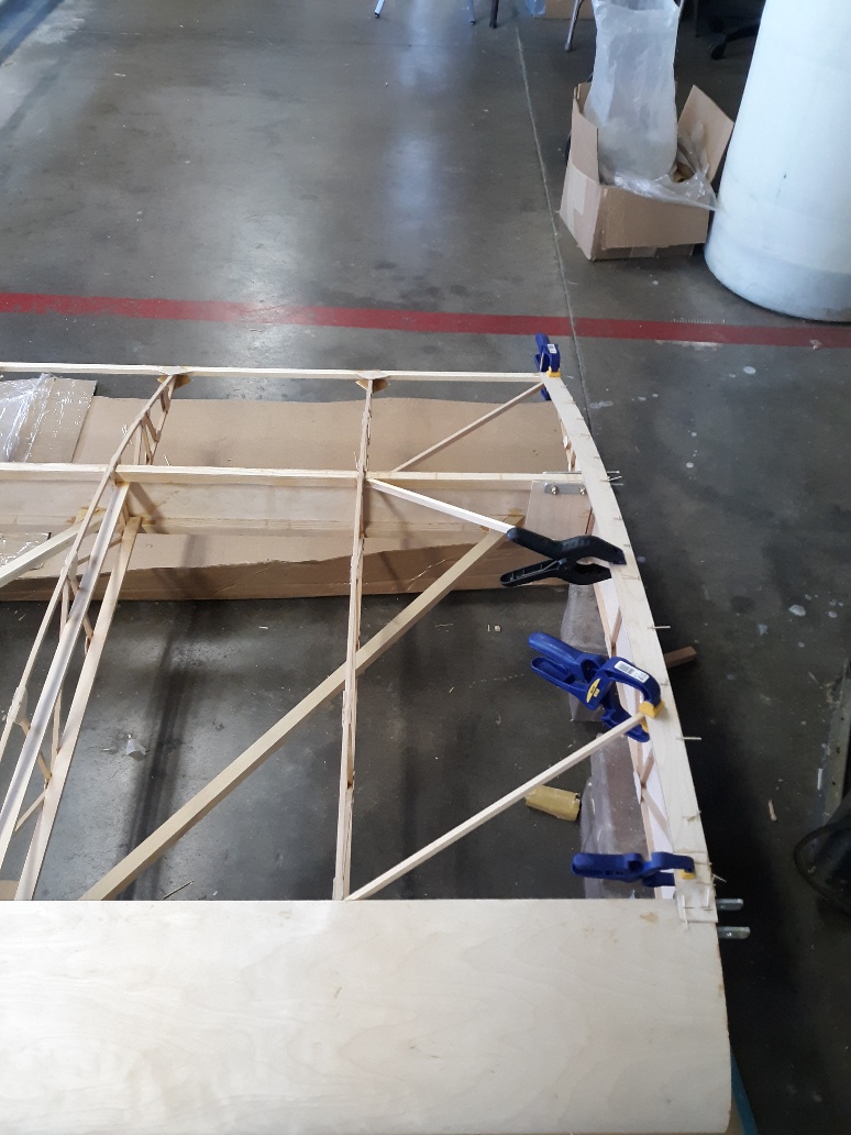

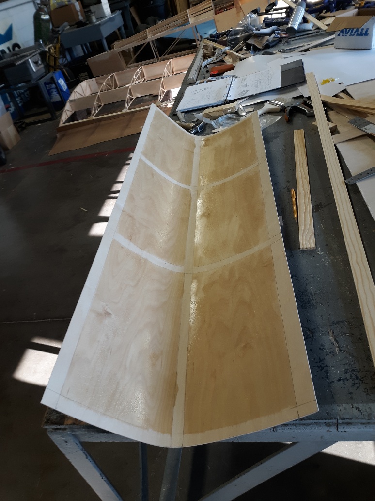

i opened up the can of varnish and put a coat on the upper part of the center section and the inside of the leading edge plywood piece that has been clamped to the leading edge to form.

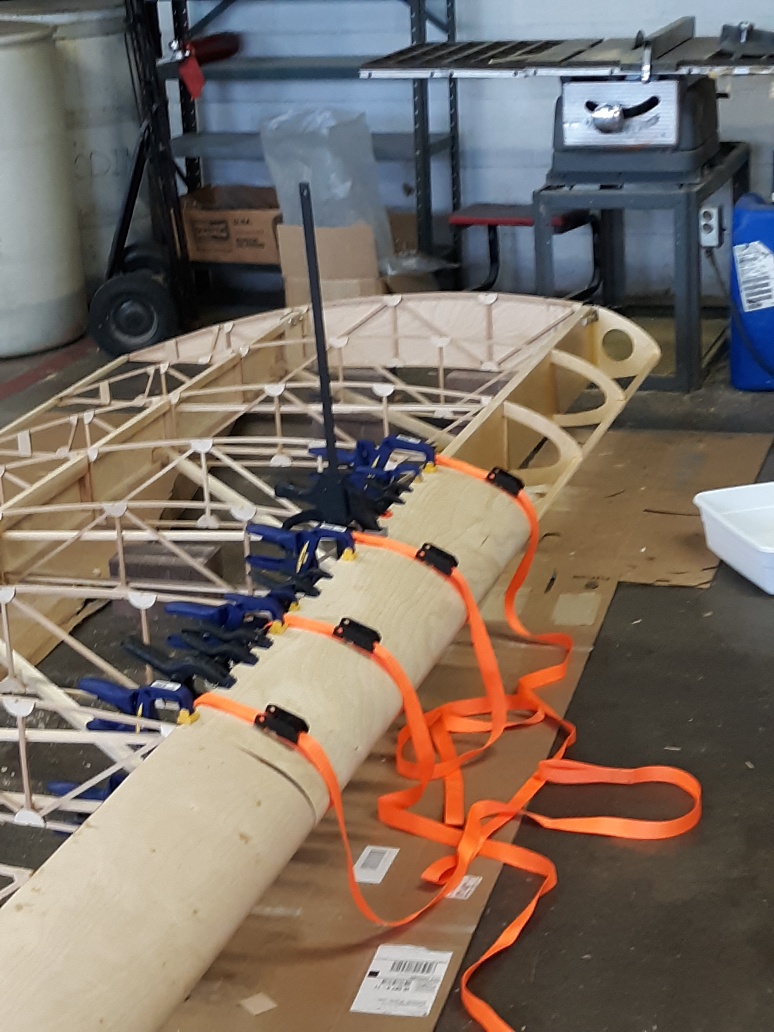

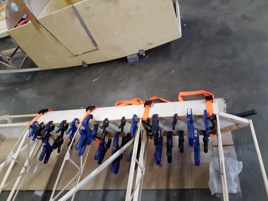

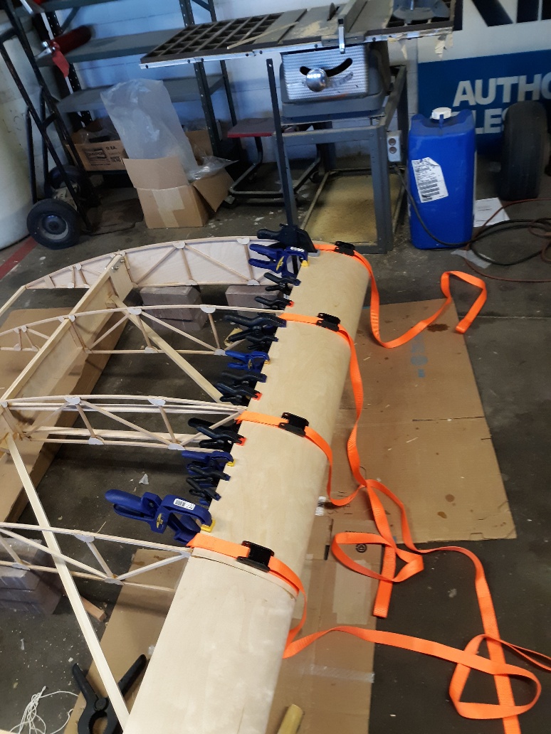

the middle piece of plywood is cut, soaked and clamped onto the leading edge to form. I messed one piece up by cutting it too short so now have to order another piece. I did some more varnishing as well

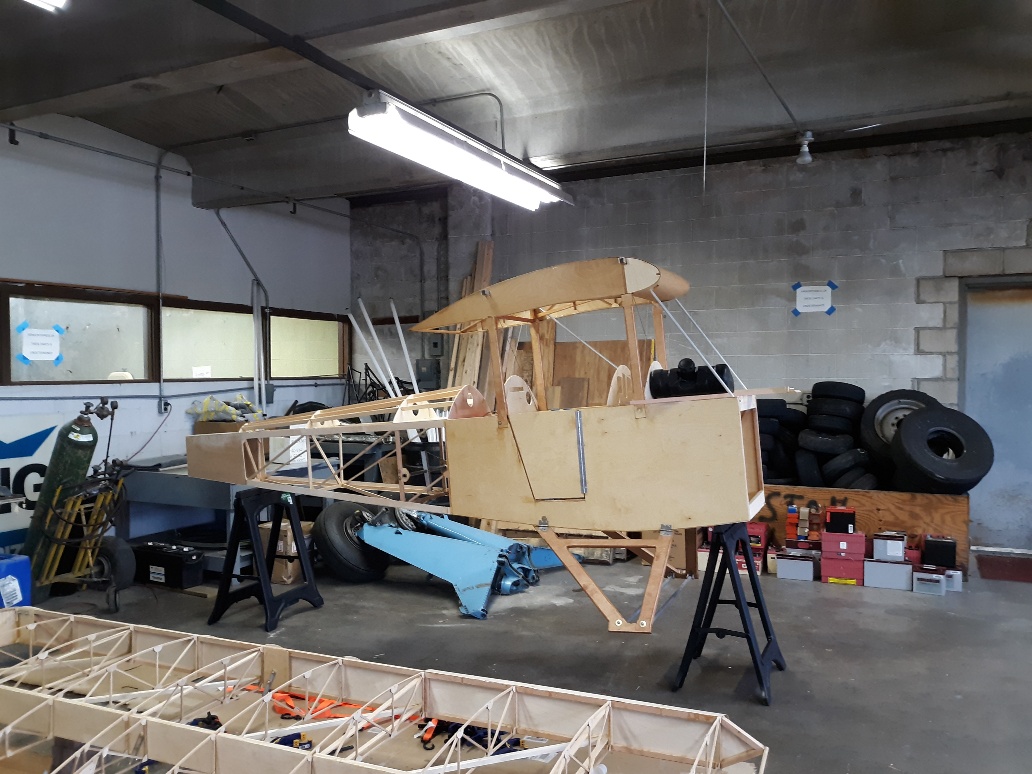

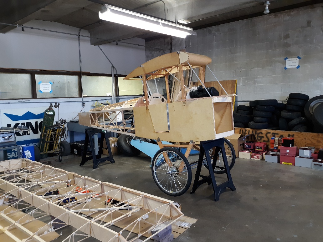

got the 2nd piece of leading edge plywood, off the leading edge and put one coat of varnish on the inside of it. the fuselage is up on sawhorses and the gear legs are put back on

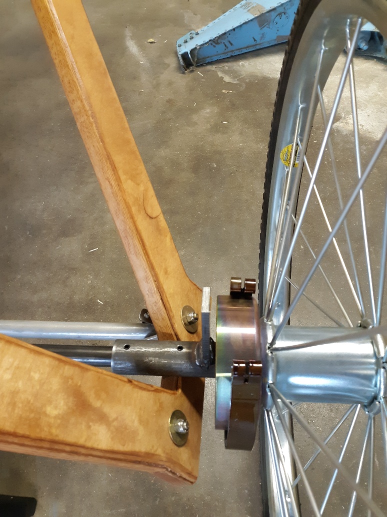

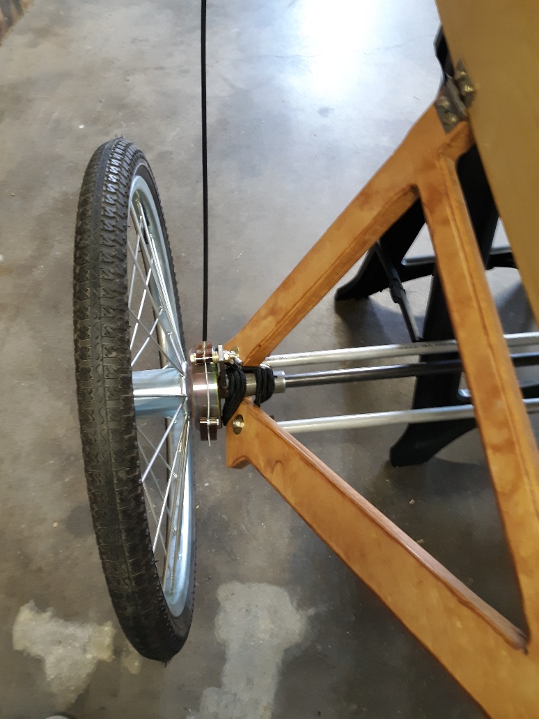

got the second coat of varnish on the inside of the plywood piece, and started putting the landing gear back on

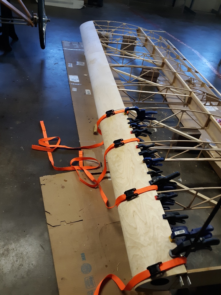

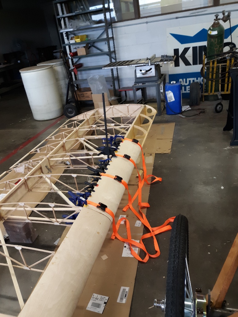

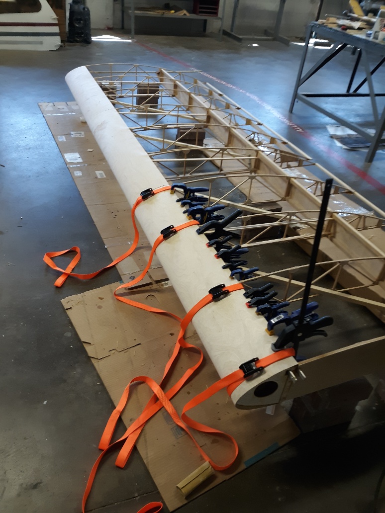

I braved the heat in the shop. The third Plywood panel is cut and strapped in place to pre-bend.

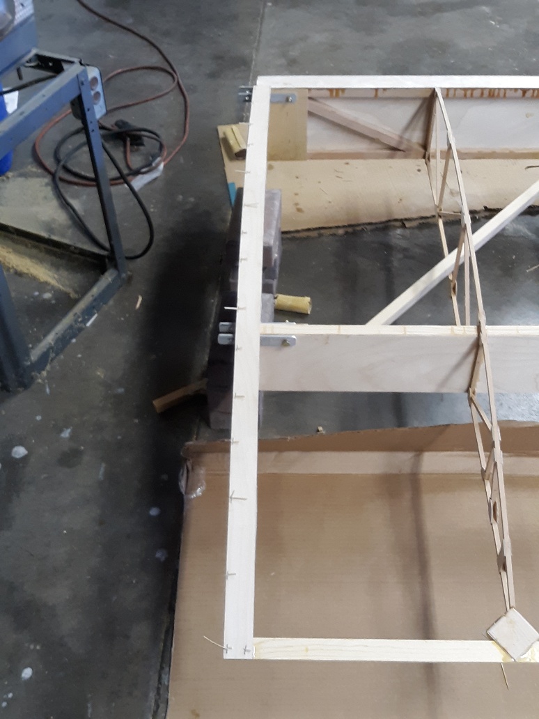

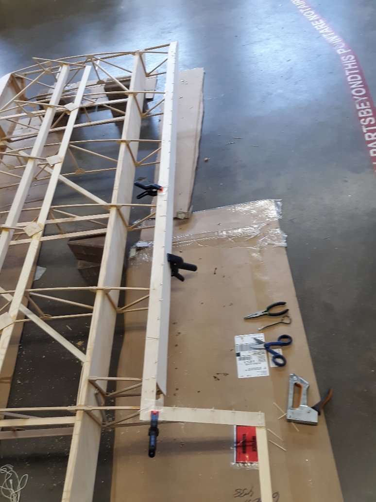

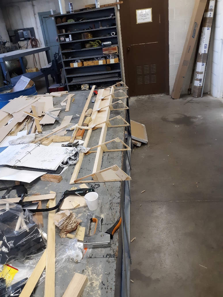

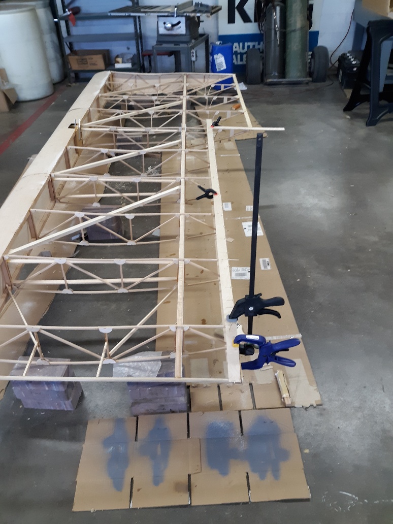

i did some more of the fiddly stuff. A plywood strip is glued on, the ailerons are cut off and the plywood web is glued in place

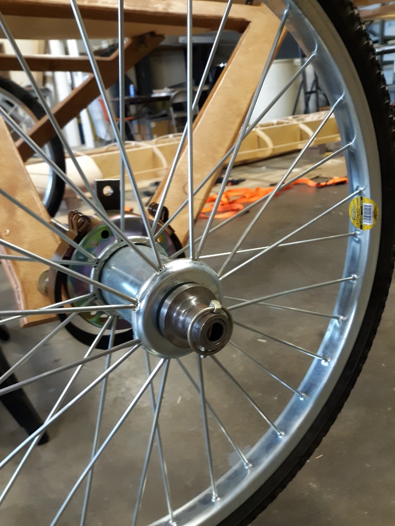

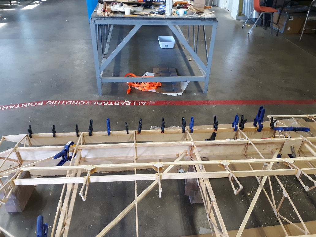

the wing was flipped over and the plywood strips glued to the bottom. Then i spent some time fiddling with the brakes.

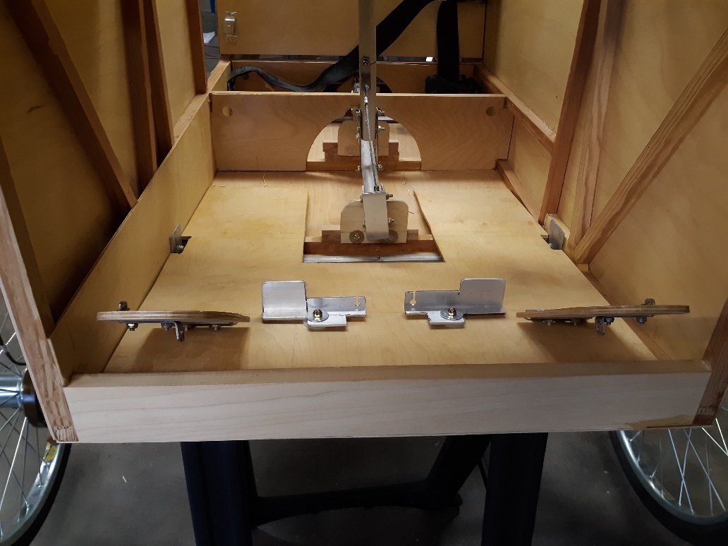

I pulled the staples on they plywood strips on both sides of the wing and worked on getting my brake peddles installed.
